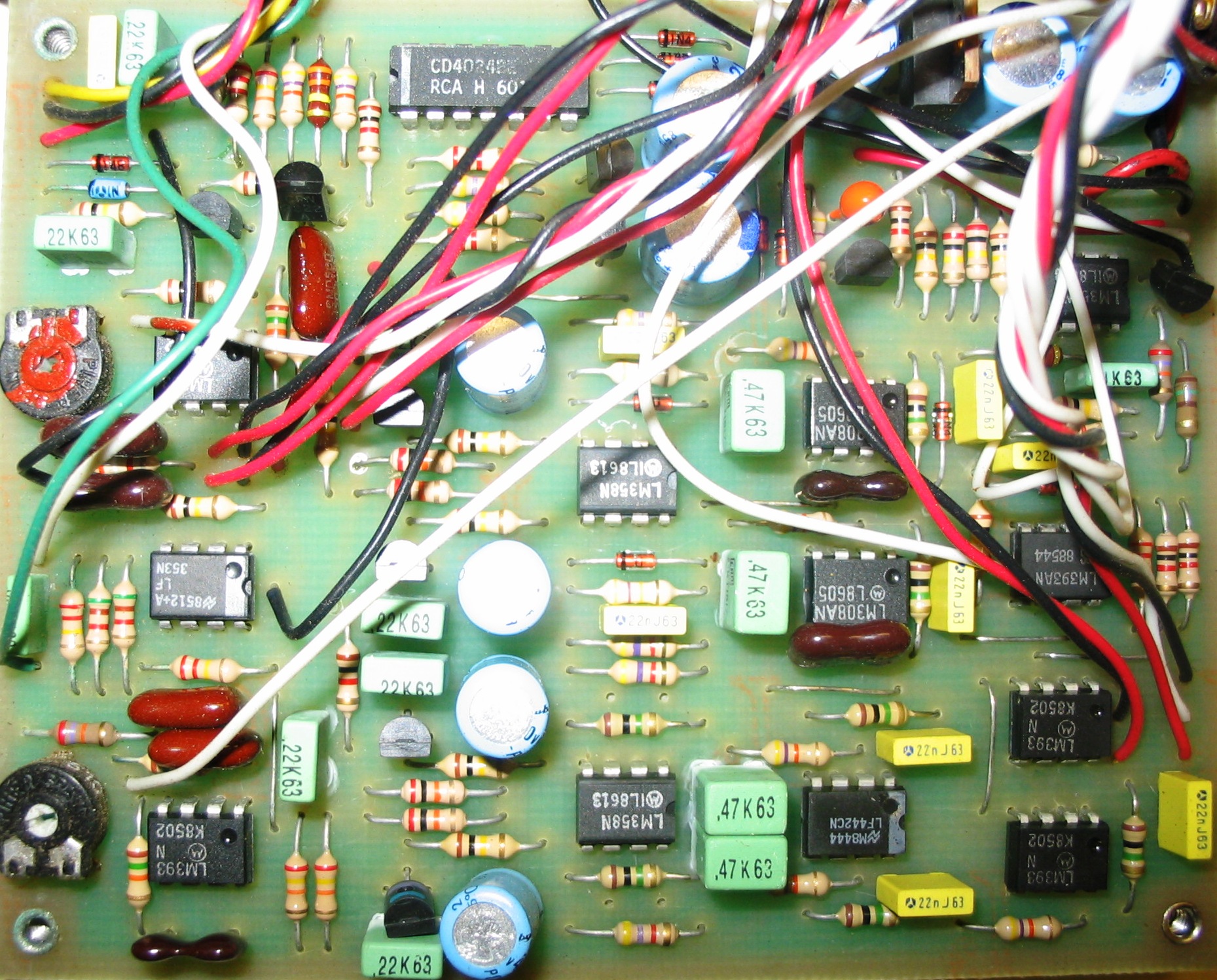

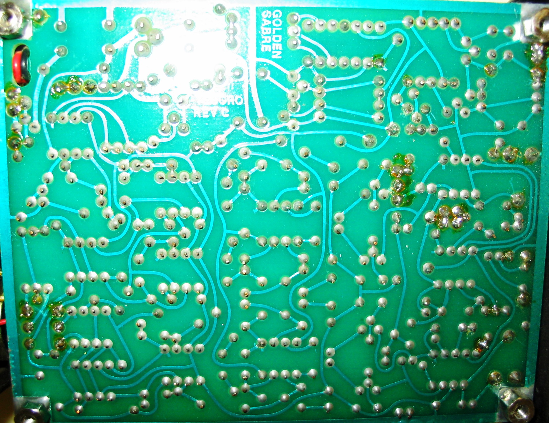

            Took apart tonight to have closer look inside. Component values and locations seem to be as per Kurtie100 component layout. Haven't checked every component as yet but did check quite a few and they match perfectly. Solder side of pcb is work of art. Artwork was made by hand (like they did in the 80s) and is very curvy. ICs are Motorola and NatSemi. Sorry I can't post photo but no good camera here. Will post some shots next week. Might be tough to get good shot of component side because of all wiring.

                I have TGS, not lite version. Here are pics..Enjoy
                • Thank you for pictures and tests! With some work it should be possible to make exact schematic of original, answer many questions.
                  Cheers,
                  -SB

                            Simon I think W. Lahr schematic is pretty accurate. Changes already noted (2-47Ks <4.7K>, 150pF<15pF>, and 100K resistor from LM 393 pin5 trace error) I only see two other differences:
                            1) 220uF cap on 8v line (right after regulator) So there is one before and after regulator!
                            2)The 1n4140 is missing on the one of the LM308s. This is interesting because it is on the (Lahr) schematic but is not on original PCB. So everyone thought this was just mistake on Kurtie100 pcb. This unit was produced after spring of 1986. Golden Sabre first came out in 1985. This is Rev C PCB, so if this was mistake they had plenty of time to fix it. I think also maybe makes no difference at all in performance.
                            Like I said before Kurtie100 component drawing (and PCB) is very accurate!
                            Parts are as per component drawing TIS75, 2222A, MPS13, LF442, etc.
                            Audio circuit (after LM35 is as per Schematic, 16 ohm speaker is LOUD!
                            Put Freq counter on Tx output tonite.....13.985 kHz with original 8" coil. Will try also with Tesoro 10.5 concentric coil I have but need to do some soldering to connect it.
                            One time I will do pains taking schematic check, maybe during long winter.
                            Next I will try 10.5 coil and DD coils, maybe few days.
                            Molzar

                              • Here is schematic and component from early posts."W. Lahr" is not on this schematic, but I've looked at so many of these Tesoro schematics I think this is his work.
                                On component lay out only values I can see different are TL062 is LF442 and BF245 is TIS75 (like in schematic). Only one can not tell (yet) is Zener diode in Tx circuit. All the other values seem to be correct. The missing diode (4140) is on the bottom LM308 (on the schematic) I believe, the gnd bal circuit.
                                Will do more pains taking analysis of components, but no time right now, but Kurtie100 component layout and PCB from post #1 seem very accurate.
