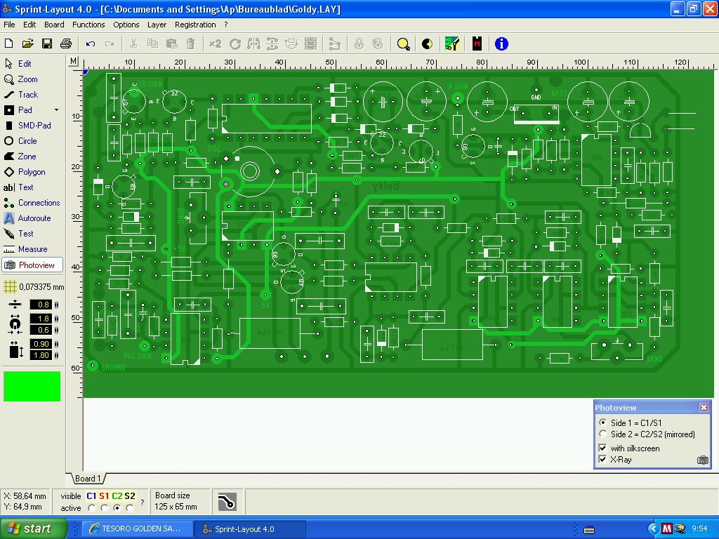

              Hello Tiktak , If you have crazy noise problems , do not forget about this circuit board lay-out from page 20 of this Golden Sabre thread...............Regards..............Eugene

                              • Simon,
                                Recieved the orginal beast today. Took a quick look inside and........
                                Is just what I had thought previously, pcb looks like almost perfect match for one posted by Kurtie100 on page 1!
                                Of course this was just quick peek, will do more thorough analysis soon.
                                Molzar
