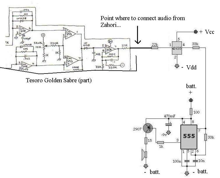

          Okan, i am saying nothing cose i didint mod this yet....still using it as it is...
          I am planning to mod it in next few weeks, than i'll report here....but i think Geo is right, it will work fine with audio from Zahori...If you are interested see it on Zahori thread...Take part added later; 4N35,555,2907....
          Right now i am learning myself to use Eagle software, with success!!! Hurahhh!
          I am gonna input Silver Sabre schematic in it and add few mods, than i'll make pcb for that and see what's going on...?!
          Also intend to make SMT pcb for Golden Sabre....but this should be job for Strujas, since i am still beginner in those stuff...

            • #96
              Boki....nesto si ceprkao Giletu po kompjuteru i sada ne moze da se konektuje.....pa ja moram da idem da mu sredjujem sve....Huh! Sutra idem da mu preinstaliram sve iz pocetka.....Bicu popodne tamo, navrati...
              Regards!
              Hi ivconic,
              is that audio mod let the threshold behaviour or gives always the same audio tone level ? Cause an audio volume modulation can be done using modulation of light of led in the optocoupler.
              I think could be really easy to implement ...also with volume modulation ...also if not needed to find objects...just a tone is required also with always same volume! But could be more close to tesoro's design to have a threshold information too...but not the way the have done cause produced weak audio response, but in a stronger way.
              Can't find the zahori circuit...??? Where is it ?
              Best regards,
              Max

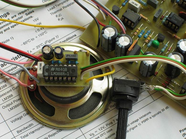

                  • #99
                    audio solution
                    How to overcome poor audio on Golden Sabre?
                    As I see the problem - sound just needs some amplification,
                    and it just happens that I have lots of surplus LM388 - 1.5W audio amplifiers.
                    This IC is obsolite and discontinued but has great charateristics..
                    supply voltage: 4 - 12 volts
                    output power: 1.5W / 8 ohm
                    it adds 20mA to total consumption
                    minimum external parts
                    Circuit used is from datasheet (gain - 20x) and it works perfect.
                    Faintest sounds are well amplified and for close targets volume control was added.
                    • Originally posted by Leto View Post
                      Hi Leto,
                      well done. Simple, easy and functional !
                      I think that using the optocoupler could avoid problems related to feedback due to current variations...caused by output stage in circuits like bandido that are really sensitive to noise and produce much commutations related to poor supply rejection of overall circuit.
                      I think that golden don't suffer from that problem so your solution could be the right choice for it.
                      Pretty nice also the small pcb!
                      Best regards,
                      Max

                            • Hi Ivconic
                              or Mr. Lecturer
                              I have a question.
                              zahori 's power supply 9 volt .and Vdd and Vcc and all bats go to +9V and -9V.
                              but inhere goden sabre power supply is 12V.
                              will bats be +12v ,-12v.
                              and what will Vdd and Vcc be? 12 or 9.
                              and what do Vdd and Vcc means .
                              • and in modified shcmatic there is one 9v.where will I supply it.
                                will I add 9v battery for these.
