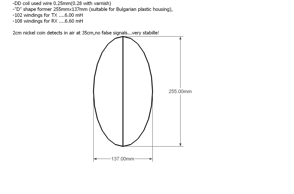

        Here are datas for another deep coil;
        -DD coil used wire 0.25mm(0.28 with varnish)
        -"D" shape former 255mmx137mm (suitable for Bulgarian plastic housing),
        -102 windings for TX ....6.00 mH
        -108 windings for RX ....6.60 mH
        2cm nickel coin detects in air at 35cm,no false signals...very stabille!
        Actually i faced huge problem here;
        So far i first made coil, than searched for various plastics for housing, but at this one i already had Bulgarian housing and had problems when nulling in it...When nulled coils cant fit into housing!? Few mm's over !
        So i had to correct size of winding former a bit, later when nullled to fit exact the given housing....Huh! At the end it is working very good....Now i have standard winding former for bulgarian "27"cm housings...
        Difference was in 4-5mm....Hell of a job to wind up again and again....
        Try this, you'll have best coil so far, for TGS...
        regards!

        • Ok Ivconic, so you mean this forms and dimensions?
          What about nulling separations, do you have demensions?

                  No Nelson, 255x137mm are dimensions only for one "D" you have to make...Not both togather!
