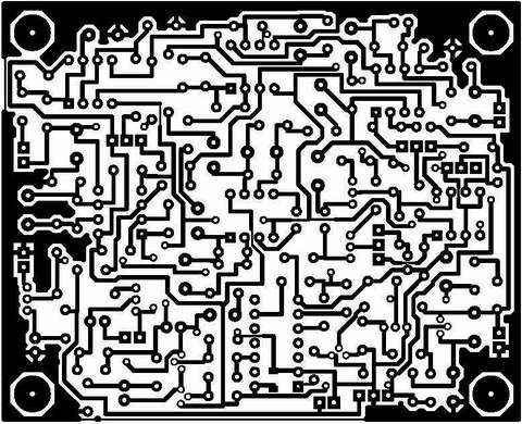

            Vladimir, first of all, thank you so very much for drawing this pcb for me!
            I wasnt intended to spread this arround since it is not my work but yours...Only you have
            full right to do that.
            But since you already stated that it can be posted freely than i feel free to do that here.
            So, here is one-sided,small pcb for TGS Light by Vladimir. I made 2 of those. Still not
            finished. I need few more components to finish it and later perform some tests...
            Already established that TL081 (in this case TL082) is not good substitution for LM308.
            In this case i would use LT1012 instead TL082....It should work just fine. Only problem
            is i cant find those in local shops....Searching for other replacement...

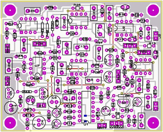

              Placement....

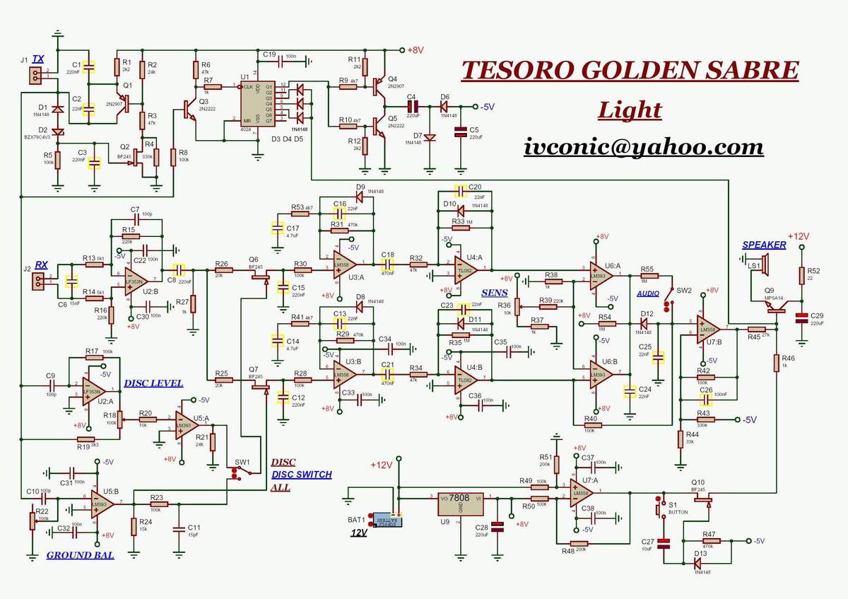

                und schematik....
                • Considering op-amps...
                  LT1008 should be good replacement for LM308, therefore LT1012 should replace 2 of LM308 put togather in this schematic...noted as TL082....
                  I tested TL081 and later TL082 and those working erratic, producing to many "blah,blah..." in speaker when Sensitivity pot is over 50%.... Bad choice....
                  Also tested: 741,LM318,CA3130,CA3140,1458,4558,LM301,LM311,NE55 34.....
                  None of those can replace LM308 in this design!
                  Interesting was playing with CA3130; depth was much greater than with LM308....over 40%....but works erratically when no target in coil proximity???
                  It should be reconsidered, might CA....be used with some surrounding components changed...? I am to tired of experimenting, also have 8 Goldy pcb's to finish these days...so i let you, guys to check CA3134/40.....
                  Regards!
                  • Good try Ivconic.
                    About CA3130, is possible to reduce gain to 20% to get close to LM308, cause may be you have to much gain and that make it work erratically?
                    This is my own curiosity and i have no idea if this is possible.
                    Nelson

                    • HI Ivconic and Vladimir
                      Your working for TGSL very good .
                      Circuit drawing with proteus software.
                      Please upload here or send my email proteus file .
                      My email : [email protected]
                      Thanks a lot .
                      • Hi.
                        I have found some mistakes in the circuit, for example 7808, it is necessary to change (IN, OUT).
                        There are no two Caps on PCB. Now it is a little, but after a while all files, including Proteus 6.95. will be sent here. Why that I Mail three days does not work.
                        Best regards.
                        Vladimir D.
                        • Hi Ivica.
                          I shall draw new PCB to you, with LM308.
                          Little later.
                          Best regards.
                          Vladimir D.
