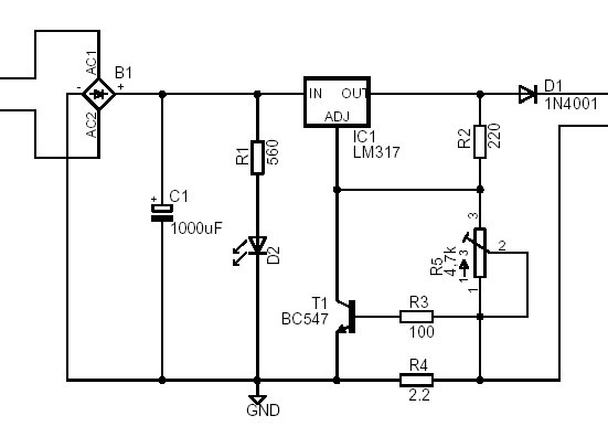

      I have broke two batteries with this circuit.I have made exacly the same as on the picture.I have conected + to diode and then to Vin;Vout to 20 ohm resistor and then to adj.and to battery +!!
      I have charged for 12 hours.
      When batteries were with their own charge they worked good,I have played to discharge them a little before conect to circuit and charge~~!!
      Bad news NOW when I conect the battery that should be charged and switch on the voltage drops from 12. to 6.6!!!
      When I measure the cells one buy one there are 3 cells that show 0,22;0,12 and 0,01!
      Why?
      Please help.
      which circuit ? The first limiter only or this of the picture below ?
      I've used both for years an never had troubles... maybe you made some mistake.
      Both way works...
      use the one below... require less care than the simpler.
      LIMIT IS
      0.6/R4 ---> 0.6/2.2 = 272mA that is always hi for e.g. 1.2Ah battery
      Good value for 1.2Ah battery is 4.8 ohm (limit at 125mA).
      Circuit works perfect with both gel-type or adsorbed-glass-mat.
      Just rotate the trimmer to get 13.8 V at output.
      Use an AC 18+V transformer with it.
      You can leave it attached to the battery for more than 10hours without problems... I do that way.
      Let me know.
      "Bad news NOW when I conect the battery that should be charged and switch on the voltage drops from 12. to 6.6!!!"
      If your charger goes down the fixed charging voltage that means :
      - not enough current delivered - e.g. you have too small transformer
      - some kind of protection circuit down the voltage to a safety area for e.g. semiconductors
      Using the circuit I've reposted here you'll notice small changes on voltage due to the charge: these are normal.
      When battery is fully charged you'll get there a voltage above near 13.8v with charger connected, as the output with no load of charger. Current drop to zero.
      Depending on the battery model when you disconnect it from charger happens always a small voltage reduction e.g. to 13.6, 13.5 : normal.

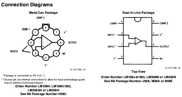

        • Hi Ivconic,
          I have a dubt now on which version of LM308 could be better...
          I mean, I've tested the LM308N cause find 2 recovering them from another circuit... and the TGS is going well with them, seems better than with tl081, of course... but I can't use them cause I have to replace where I found them sooner or later.
          So I have to find 2 new, or used... from other stuff.
          Have you used the LM308N or the LM308AH ? ... cause I know there were some differences , though really small things.
          So before I dismantle things to find 2 ... better know what to search !
          Please let me know.
          Kind regards,
          Max
          • Hi Ivconic,
            to be more explicit... the metal can or standard dip ones ?
            Cause I think can find the AH... with a bit of luck.
            They introduce less noise and have some different freq. response... though circuit should be the same on the chip.
            Let me know if you have tryed the metal can... TO-99.

              Max i used "N" type....
              Well, i was pushed to make some compromises yesterday, so again used TL081a instead LM308....Put enormous effort to undestand how to make it work good and.....piece of cake!
              Yes TL081a could be used...(sheeeesh i already told it cant)....
              No major corrections at all, just as "Sens." do not use pot but trimmer on pcb, adjust it to work calm and fine and leave it on pcb for good....
              Depths remains same as with LM308...only "Sens." stays as trimmer preset....

                  I have used the same picture to see what is the LM317T pinconfiguration.
                  I used LM317T,1N4007 diode and 20 ohm resistor wired the way that you show.
                  You told me to charge over night or for 12 hours.
                  I make the same thing.
                  I now that have mistake somewhere but can't find what exacly.
                  When the batteries were new with their own charge they were working fine,but now when I charge them its look like 3 cells are damaged.
                  I have spend much money around this suply variant!!
                  THANKS
                      THANKS
                      problem is that with this kind of batteries one can't make mistakes... or for sure it will result in a damage to the cells.
                      This is the real "limit" of most charger schematics... respect e.g. to bought chargers.
                      Otherwise they work well if proper wired and a bit of extra care is taken to prevent damages... the first thing to look at is the current delivered when charge start. Current must stay always under safe limit so cannot be e.g. above 1/4 of battery capacity, much better if low as 1/10 of it.
                      Circuit like the ones I've posted are in practice current limiters based on LM317 plus some extra components e.g. in the second schematic.
                      Are easy... and they work if properly built and used... but if e.g. the LM317 have problems e.g. a thermal runaway cause heatsink too small etc they could give catastrophic effects.
                      The best thing to do in the hypotesis that cases happen is always put a fuse on the supply side, I mean or an auto-fuse (e.g. 250mA fast) or a normal old type for higher current limits... so if things go wrong you could lose the fuse as maximum damage but not the battery ! Next time put a fuse with double current rating of your charging limit.
                      Wasting money is always an hard lesson but sometimes is also useful lesson!
