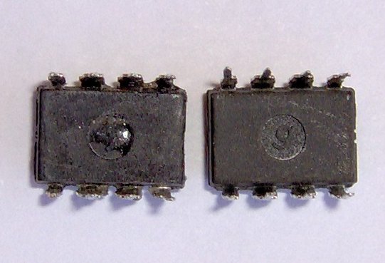

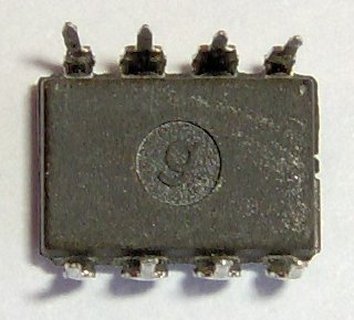

          • suspicious fake LM308s
            Hi all,
            here are some pictures of them:
            1 is upside of one of them look at the "N" (National)
            2 is downside of it look at the number or "g"
            3 is downside of both... then first difference the second have no number/g but seems have an epoxy melt in bad way ... but on the top they are labeled the same... even the timemark/fab is the same : it's M12AH and maybe mean they are from 1912 !
            4 is original national lm308 look again at the National symbol (this time original) and compare with first picture: they are different.
            5 is original one meta-can type
            What do you think now ?
            For me are fake LM308... also materials are bad quality... you can break leads just with a little pressure... but in original ones you can move pins without damaging at all.
            Epoxy melt is not in standard of quality for National devices... I have many and not a single one is in these conditions.
            Better to keep eyes well open before buy... these are S..T devices... maybe some LM748 relabeled.
