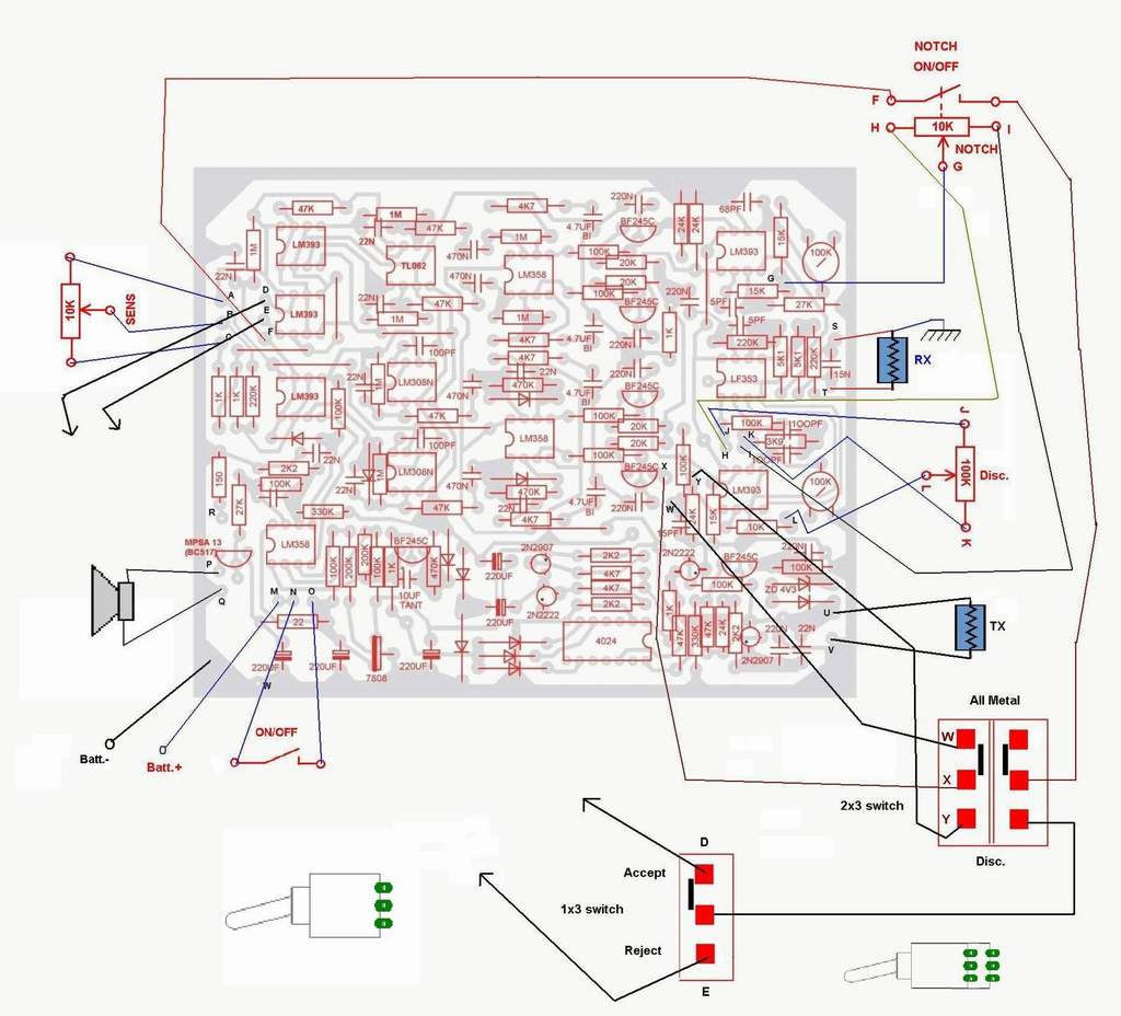

  • Originally posted by Geto View Post
    WWWWWWWW????
    Or you are blind or I am there are two points that are marked with W on this picture!So .....
    Geto - you genius!
    Do not be angry. You found Ground. It's was lost because some stupid butthead put a "W" on it. I was confused before, but now I can go work some more. Thank you for being so observant. Hooray!
      You have make better results,but this machine should be capable of much more!
      This distance can be achived even with magnum metal locator!
      I can't give opinion,but the problem is realy in the coil nuling!
      Thanks for sharing your expiriance!
      yes... the MAGNUM... ...NO NO...
      At the moment maybe on that homebrew...but
      there is for sure a (or some) problem(s) with coil or other thing cause I got "incredible" results on bandido and so can say that the guys there at Tesoro know what they do...
      These are great and stable detectors anyone would have... JUST A BIT TRICKY TO GET THEM WORK.
      Of course not minelab stuff...OK...but really good stuff.

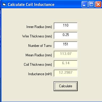

        " Today i finish coils:
        TX coil is 101 turns, 0.25 mm wire, 5.6 mH, resistance 26.2 ohms.
        RX coil is 107 turns, 0.25 mm wire, 6.45 mH, resistance 27.4 ohms.
        Diameter of both coils is 19 cms."
        ??? Something isn't right here? Are you used round former with diamm.19cms?
        When i used round former 22cm diamm. and 110 wind. of 0.25mm(0.28mm) at the
        end i gained from 21-23 ohms (dont remember exactly) resistances..???
        Inductances were approx. 6.x uH...(also dont remeber)...
        According to your datas i am absolutelly positive that you used 0.25mm wire
        with varnish on. Which means that your wire is thinner....arround 0.22/0.23mm.
        Only in this case you can get such high resistances!

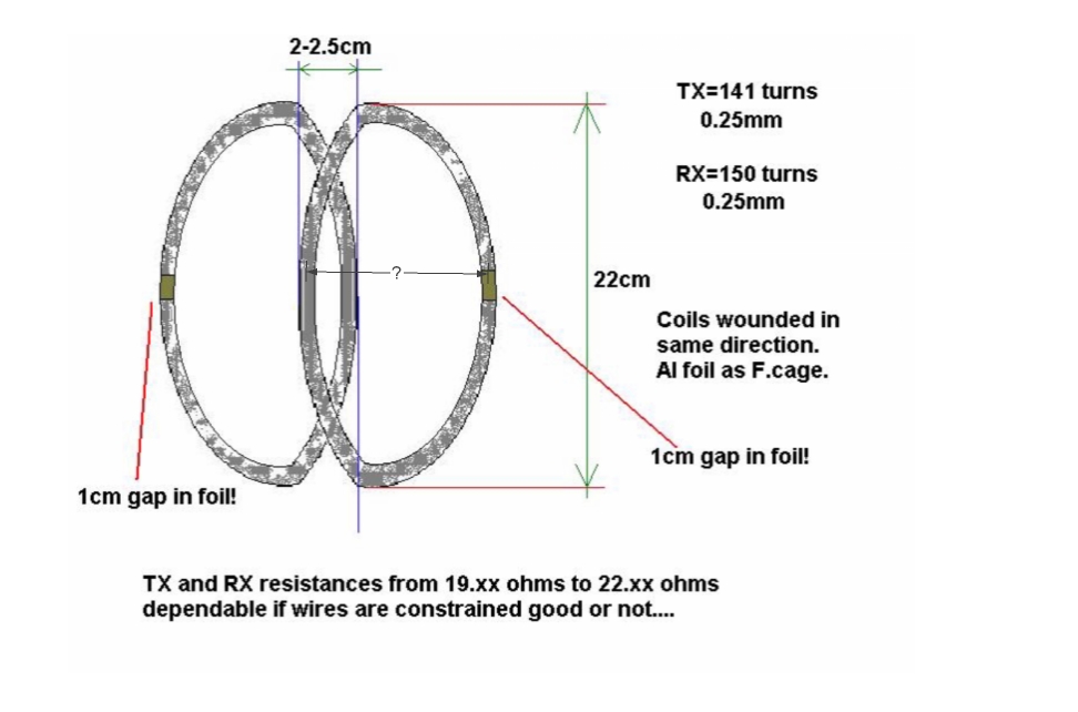

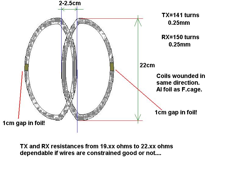

        Right now, i am making my coils very succesfully without paying to much
        attention on exact datas; no. of turns and diamm.
        I am using D shape with 21cm longer diamm. Wound 140 windings for TX and 145-150
        windings for RX. Resistances are arround 20-22ohms, dependable of how good are
        windings constrained. On both coils Al tape applied to form Faraday cage...
        Rest you know according to posted sketch.
        I pay a lot of attention on nulling coils, usually takes 10-15 minutes to null
        those very accuratelly, without scope or any other instrument. Just connected to
        G.Sabre and using nickel coin (1cm diamm.); swinging constantly over coil and
        adjusting null relying on audio. The best depth (in All Metal mode) also means
        best possible nulling.(it showed to me as simpliest method so far, also most
        accurate). Usually it can detect that coin at 36cm in the air, so i know when
        nulling is done.
        When finishing, later check it again with ferrite rod to gain
        absolute no detection on it.Not even a "tic" on it. When all finished, i usually
        use "super glue" to stiff coils to each other, also both to housing. When dry,
        than use teflon-based, two-component mass to fill it up good, and let it for
        10 hours to dry. And that's it!
        Oh, i forgot to say; GEB trimmer should be somewhere on the middle when nulled.
        Later when tried first time on real field, i usually readjust GEB trimmer a bit.
        It is usually 1-2mm up or down from origin...not to much! Just about to loose
        ocassionall "tic-tic" on highly mineralised soil....Best method so far. At least
        for me.
        I do not pay to much attention on gained frequency, but it is usually from 13.xx
        to 14.xx kHz....
        Point is not to obey everything you see on this forum, but to make detector which
        will work as best as it can be....So minor jitters are more than usuall from one to
        another device....
        I already made 3 G.Sabre's and 2 S.Sabres....Satisfied much with all those...
        Do not intend to change "brand" for longer period. It showed as excellent detector
        as hand-made...!

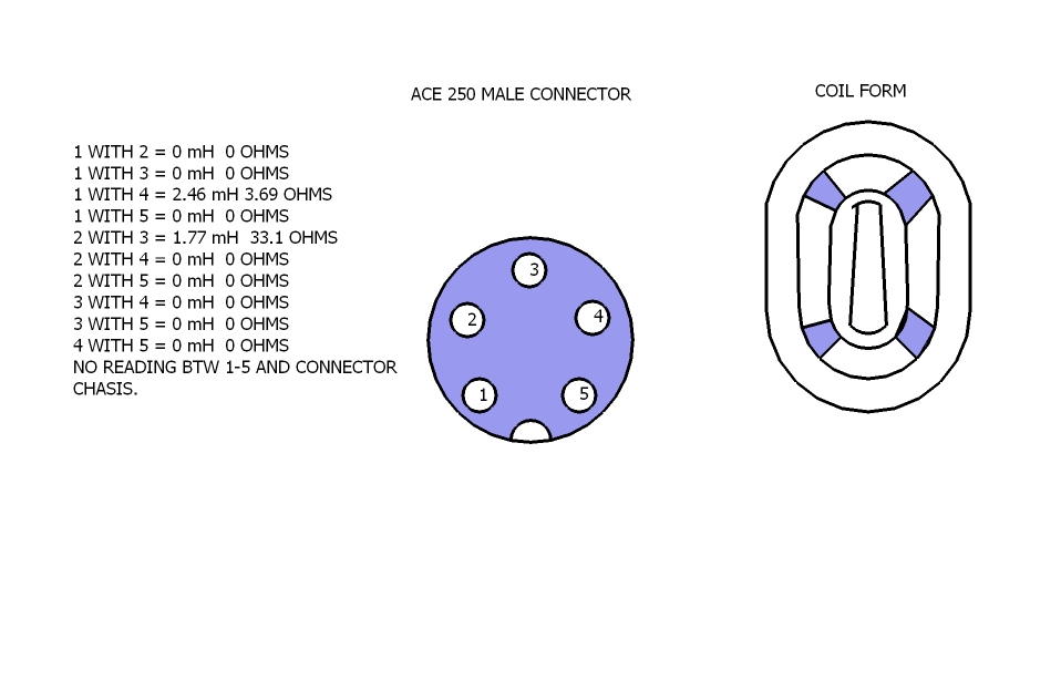

          • Excellent report on MD expirencies Ivconic.
            Yes i agree that my problem deals with the coil and i m working on that.
            Parallel to this, i also have measure my ace 250 coil and i think that garret put a limited performance coils to this machine. Has i post down on my scketch, i belive that this coil has to high inductances for the working frequency wich is aron 5.6 khz. What do you think Ivconic, Max or anyone that has more expirence than me on building homebrew coils?
            After i finish my work with GS i will like to build a good coils for my ace 250. Any ideas?
            Regards and thanks for supporting me.
            Nelson

                • Hi Ivconic, i hope time out was nice.
                  Yesterday a finish my Golden Sabre and i tested my DD coil wich is by now showing the same deep has ACE 250.
                  A few days ago, you posted the schetch below that gives us a good idea on how to make a good coil. Now i m traing to copy that draw, but i need the center measure showing on it. Also, let me know the exact diameter used when you make it, because has you know if you change diameter a few cms and use the same turns has show, you will never get the inductance needed.
                  I also posted my ace 250 coils values to try in the future a homemade coil.
                  In advance many thanks
                  Nelson

                  • To nelson
                    I almost finish my TGS too.Did you use tl082 for replacement?
                    I think that this metal detector shoud be capable of more than ACE250!
                    38cm for 1cm coin!This is a very good depth!With proper coil this machine will be monster.And every one tells that it's discrimination is noticable!
                    So, you have missed something??@?@?@!!?!
                    Thanks for sharing your results here
                    • Obvious?
                      Nelson!? It is obvious that radius is 22cm and diammeter 11cm...? According posted sketch is on blue line...Even if jitter a bit, it would be few mm 's not few cm's....I already explained that not paying a lot attention on exact measures..All can be compensated later with nulling and adjusting ocsillator...
                      Have to go now!Bye!

                          • Hi Ivconic.
                            Yes you are rigth and i think the problem was my instrument. Yestarday i measure my two coils with a good LC meter and results shows that one coil is 8.9 mH and the other 10.9 mH, intead of my first measures that i made with the first instrument that gave me 5.35 mH and 6.45 mH. The diameter of each coil is 19 cms, wire 0.25 mm.
                            So this weekend i ll make another one, like the one you show on the scketch.

                            • Where is my errors?
                              Still can“t get the picture on how to calculate the coils. I had calculated with Calculate Coil program, but i got diferent values has posted.
                              On the picture i place on the program a calculation for a 110 mm radius coil, 0.25 mm wire and the result does not match around 6 or 6.5 mH, it gives 12.298 mH.
                              What i m doing wrong?

                              • hi
                                What should I connect to this point marked with R on tihis picture?
                                Tks
                                Excelent picture!Thats how the things should be done!So it can be clear for all
                                at first look!
