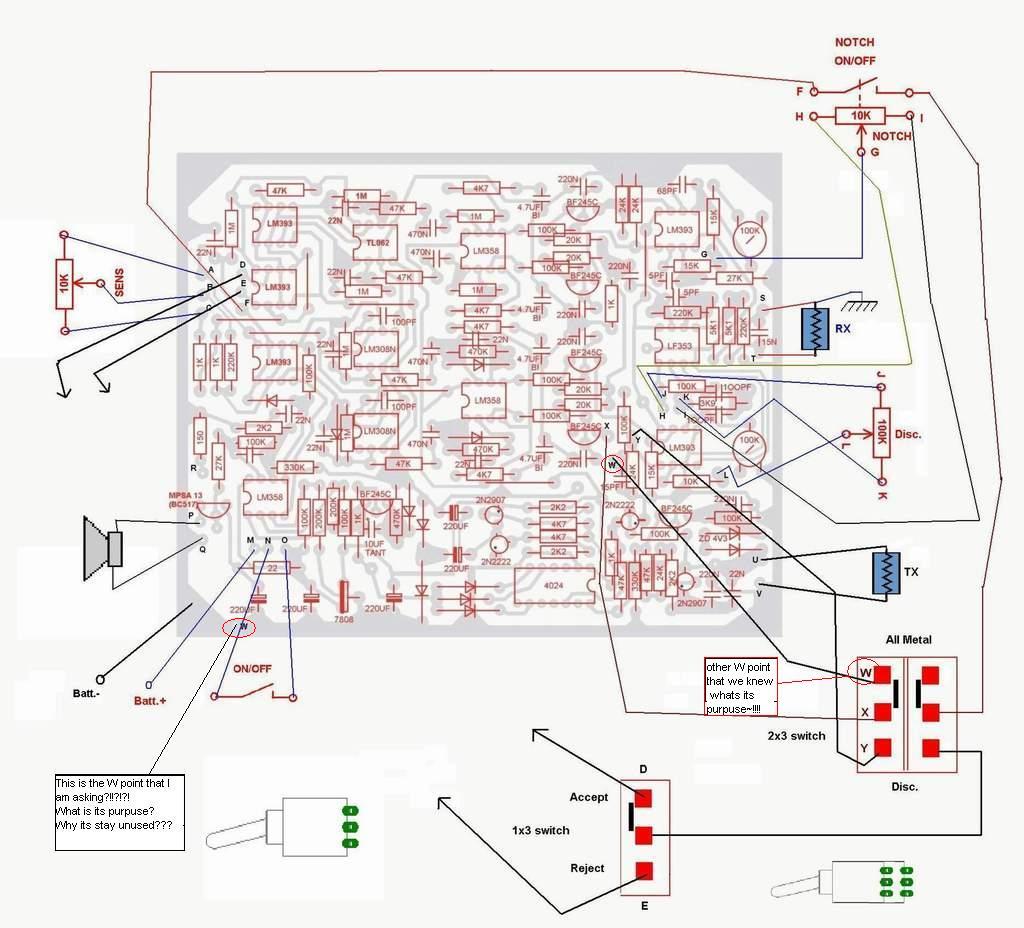

          • To nelson
            How did you conect the switches?I still cant get that!

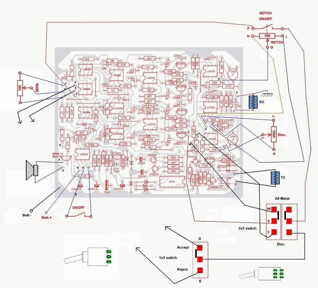

            • Hi Geto, here i m sending a copy of a good job made by Ivconic, that shows graphicaly how to connect pots and swithches.
              Nelson

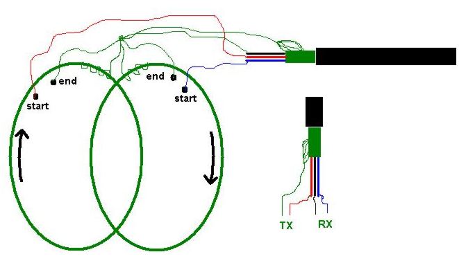

              • To nelson
                I saw those,but can't understand there is one more W point near batt-, that is unused?
                And from second picture:
                lets use L1 for left and L2 for right winding!
                I have to conect the two faradey shields on the windings and the two windings ends and then conect this point with faradey shield on the cable and one of the cores(black)!
                The red core to L1 winding start?And blue core to L2 start?
                I will make coil like this for first time!

                  • Hi,
                    YES
                    FOLLOW THE SAME WINDING DIRECTION
                    JUST FOLLOW THE PICTURE. BOTH FARADAY SHIELDS ARE CONNECTED TOGETHER.
                    STAR LEADS GOES TO RX AND TX ON THE BOARD, END LEADS GOES TO SHIELD
                    Nelson
                    • hi
                      Sorry!
                      I will try to be more clear!
                      I have saw those two pictures.But think that there is still something missing!
                      Thats why I ask.
                      And for those two W points:
                      There is one going in 2x3 switch and other that is not conected at all???
                      Whats is its purpuse?
                      And the END-s of L1 and L2 with them ?And then going in cable shield and black core?
