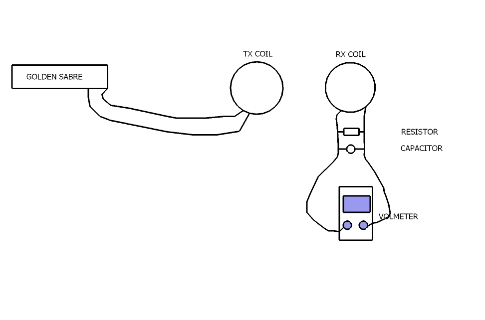

                        • Ok Max and thanks for your help.
                          One more question, should i have to place the resistor and capacitor in series to one lead or shoud i have to conected it to each leads in parallel?
                          Both coils has i understood must be of the circuit and the frequency injection should be conected to the rx coil leads. Where should i have to place the multimiter leads?

                              connect tx coil to osc circuit (pcb pads). This way you get the oscillating magnetic field be generated all around the tx coil.
                              Connect capacitor and resistor in parallel to rx leads, and then the voltmeter accross leads too.
                              Move to null as described. When find minimum fix the rx coil with tape etc in many point , then recheck and if necessary fix again.
                              When you read a small few mv voltage you can test performance, disconnecting capacitor and resistor and connecting rx coil leads to pcb.

                              • TO GET MORE CLEAR, DO YOU MEAN THIS CONFIGURATION SHOW ON THE PICTURE?
                                BEST REGARDS
                                NELSON
