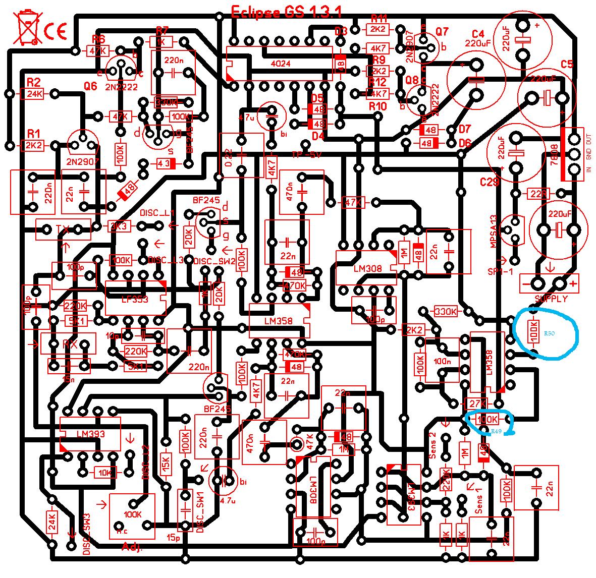

    which are the other resistors which need to be removed (need-a-pic)
    if you guys spot something wrong with the board let me know
    cheers
    I'm pretty sure the resistors circled in blue are the ones -- left over from the battery check. They don't cause any problem though.
    I've been labeling all the parts on your PCB for my own understanding (not on attached picture). So far I haven't seen any errors, but I'm not completely deriving a schematic from it, which would be best check.
    I am trying to re-draw the PCB using ExpressPCB and then adjust some parts dimensions for my oddball components. Also spreading it out a little to make it easier to experiment with and test. Taking a long time -- if I ever get it built I'll let you know if any problems!
    I definitely appreciate layout work done by others. Very hard to do from schematic I'm sure.
    Cheers,
    -SB

                    • Huh, to much fuzz here, without such need!?
                      There are NOT "uneeded" resistors there? Who give you such idea? Those resistors there prevents opamp's inputs and output to flow. So keep those there.

                          Great, much appreciated!
                          Also, good point about "unneeded resistors". A question I have been meaning to ask was whether inputs and outputs of unused op amps can be floating or should be "tied off" somehow to prevent oscillations or other effects. I know some components need it, but not sure with op amps.
                          So, if that's the case, sorry for bad advice -- Ivconic says keep resistors R48, R49, R50, R51 (connected to LM358 U107b) even if not using battery check circuit.

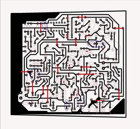

                              Hi Ivconic:
                              Thanks for latest design. But ".lay" file does not seem to have component values labeled. Do you have another file with labels?
                              Also, can you explain "coupling capacitors" (.1uF) more? Did you put them on PCB or schematic? What is function?
                              -SB
                              • I suppose the coupling capacitors are on the solder side of the board, but what location are those ? Perhaps they are the reason for the calm operation of the deviced + the bigger GND ring around the board outline.
                                Yup there are no labels on the board, would be good to have them labeled, the board is very nice, small size could fit to many small md boxes, hmm perhaps I should try it
