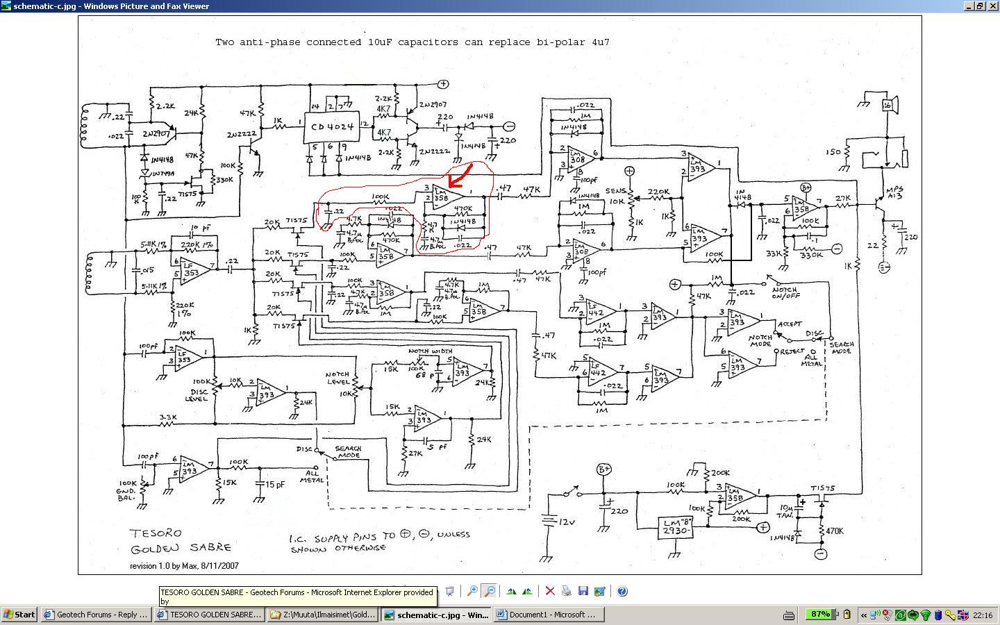

            • Unwanted oscillation
              I have now powered my TGS first time. It screams me welcome, so it works partially. The negative voltage is present at -5.9V.
              The half of a LM358 indicated with an red arrow was hot and the device took 130mA. The amp oscillates at 700kHz, 400mVpp, present at pins 1 and 2. The other half is quiet. The transmitter oscilaltor runs on 14.3 kHz.
              I have checked all components inside the thin red line and they seem to be OK. Then I desoldered the IC socket of the LM358, cleaned the resin remains and soldered the IC back without the socket. Funny: the current consumption was halved to 60mA, but the oscillation stays. The IC is still a bit warm, but not hot.
              The copper side of the PWB has been cleaned from the resin, but the component side has it to some extent; between the components and the surface of the PWB.
              Does this phenomenon ring a bell with some of you ie how to continue? The simplest solution would be to desolder everything and clean the PWB, but I'd like to avoid that.
              I have never before had any problems with the resin, so I don't believe it could be a problem here. The gains in the device are not so big that it would play any role. Objections?
              All hints appreciated,
              Andy

                  As a quick check I would replace the op amp and see if same behavior. If so, we can focus on circuit. I have not seen anyone report similar problem.
                  What are you using for the bipolar 4.7 uF capacitor? Maybe that is problem if defective or not bipolar.

                    Hi Andy,
                    seems you have a little problem there : the 700Khz you read are probably from self oscillations at that op amp.
                    The fact you read 130mA consumption is not so good... I think you've it damaged already.
                    My suggestion is , apart cleaning very well pcb as you can, desolder it... then remount the socket; try to add 100nF caps just under the ic socket at power rails and other lead to gnd.
                    That way you'll probably solve that, but have to use a brand new ic.
                    Other things that could be involved are pcb tracks... too near can be a problem and sometimes op amps use special ring guards for that at inputs (yes, the amplification factor plays a major role in that but not only)... but if you used any of the pcb designs here you'll probably need just that filtering at power rails.
