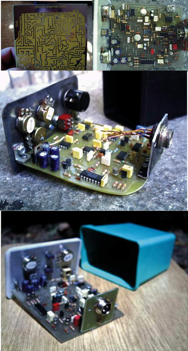

      Dennis i replaced the opamp.. but nothing..... i construct a new one!!!
      ivconic: new pics!!! i will buy new components as soon as possible!!! thanks!!!
      George your old pcb is very ugly and bad!
      Your new pcb is excellent!
      I guess that could be the source of your problems!
      Apply "lotlack" (soldering catalysator&protector) on that new pcb. Once dry, you may solder components on it. But be neat and try to do clean work. Do not apply so much tin! Try to void flux layers like on previous pcb.
      Try to do clean and neat job - "mother of good electronic" !
      • Thanks a lot for help ivconic!!!! when i have new results from the construction i will post here!!!!
        • Always try to keep as short as possible wires which connects pcb and commands. To make this task more easy you may use setup like on posted photo. Front panel (metal plate with commands mounted on) is closely connected to pcb with good contact to pcb gnd. Rear coil connector holder is also made from metal (or piece of Cu plate) and also good connected to pcb gnd. This way, good gnd "coverage" is preserved. S/N ratio is improved. Once this achieved - you may start soldering SHORT wires from pcb to commands. As short as possible.
          Compact work with good soldering (not to much tin, not to few, no flux) is just first step to good working device. The rest is more easier.

                  • ivconic: new photo from the pcb...
                    i put the same resistors and capacitors... but i want to ask you something about tranzistors before i put on the pcb
                    for chopper, (2Ν2222 & 2Ν2907) - I bought BC547 & BC557,
                    for buffer, (2N2222) - BC547
                    for TX tranzistor i put the same.. 2N22907
                    and last for 2 FETS (J107) - I bought BF245
                    • ivconic good results!!!!!!! TGS is working perfect!!! thanks for your help

                      • Originally posted by GeorgeGW View Post
                        this is the last construction for 2009 !!
                        Excellent!
                        Perform some air tests and inform us here!

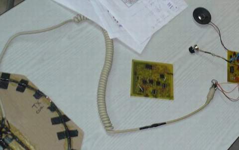

                          • George correct me if i am wrong; but this cable you took from keyboard? Right?
                            That cable is maybe good for table testing but not good for outdoor. You better replace it with something more sutiable.

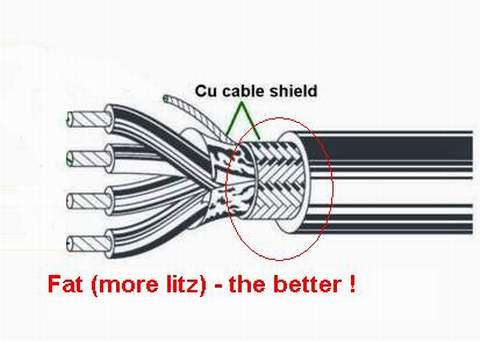

                            • Proper cable looks like this;
                              • Cable screening
                                Hi Ivconic
                                Your diagram is interesting. I always assumed that the transmit and receive cores in the cable needed to be screened from each other to prevent capacitive coupling between them, but maybe it isn't important after all (I'm still learning about this stuff). If one overall screen is good enough, it makes it a lot easier to find suitable cable. Does anyone have experience of using cable with one screen compared to cable with separate screening for Tx and Rx cores? Or is it unimportant?
