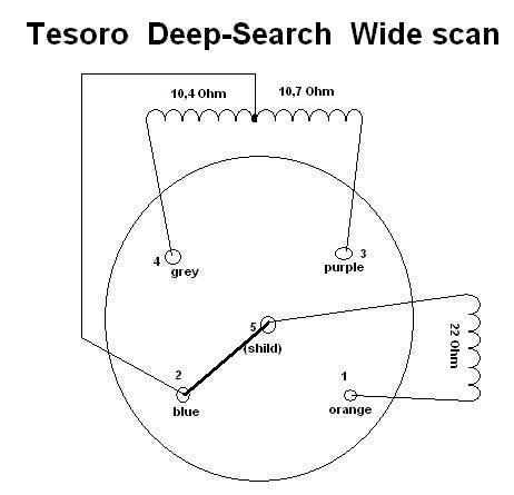

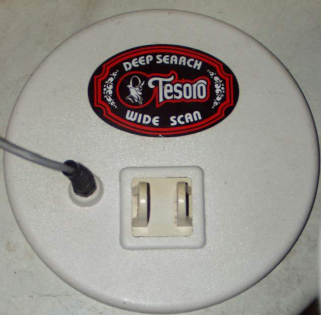

                        1) inline connector ? why not... will work too. There are similar low freq connectors that made this... you could also checkout cannon (used for audio, microphones) connectors... they are high quality , but remember the metal part of them must not swing otherwise you'll get false signals cause of that.
                        2) difficault to find... for example I have original 9x8'' from tesoro... and I changed original connector....5 ways (with ring-screw not bayonet). It's a problem with it if you haven't an original tesoro detector... difficault to find socket for it.
                        3) all tesoro coils have connector... soldered to cable. You can swap coils... cause of that connector stuff. It's rare today a detector has just one coil attached... and no connector.
                        4) already explained by Ivconic: you can, and it works. But , I have to say, on 9x8'' I have performance that are good but sure not as good as with the 11'' homemade for TGS.
                        I found also that my 9x8'' works better when on my BandidoII than with TGS.
                        9x8'' is very nice, expecially at pinpointing and disc... less on depth.
                        So... you can buy one and enjoy it but I think too an homemade suited to particular TGS is much better than a standard coil, expecially at depth.

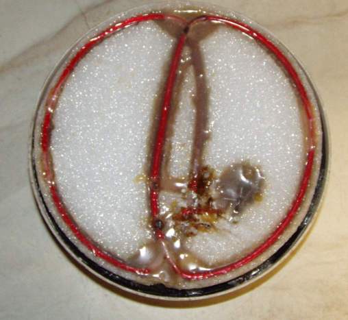

                            • Hi,
                              I can see some diferances.
                              What do you think Ivconic?
                              • Hi,
                                Shape,wiring?
