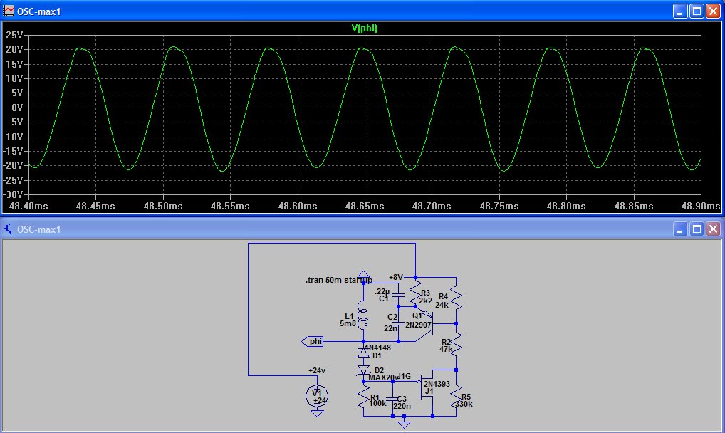

      the 5ms transient an. time limit is wrong: use 20ms or better 50ms.
      At 5ms you could see amplitude before stabilization... so a sharp and tall peak of voltage that then drop after to real values.
      Now see my simulation using a custom (MAX20 ) 20v zener diode (not in shops unfortunately ) and 24V positive supply.
      Big wave, but too distorted for my taste and also one need 24v there... not good stuff to test on real circuit.
      Kind regards,
      Max
      • sorry. i make test on 5m like on your circuit
        on 5m - BZX84C15L work great too
        all clear now
        but on 50 its not look soo good
        thanks for solution Max...

          you are welcome... now that I dug that files I can start thinking at it again...
          I was thinking some months ago of putting more power there but then something happened and I switched to other projects... nice to see there are still people interested in the topic.
          The big problem is that the colpitts osc there is not a great solution about power delivered. Also I'm worried that trying to put 30 or more Vpp on coil will make device unstable on soil... cause one need really perfect GEB to deal with that stuff on little hot soil ...with fragments and magnetic compounds.
          Anyway, I will test a bit on it with my TGSlight board (I never totally tuned/completed so far!).
          Kind regards,
          Max
