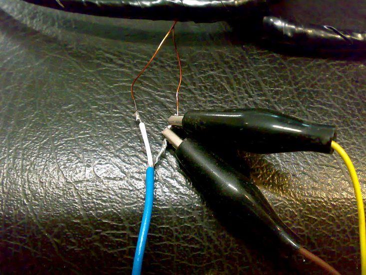

        • Hi Max
          Air test : The coin with 25mm diameter from 30cm of coil .it isn’t very
          Good result when compare with your built and ivconic
          Also the test area contains heavy electrical interference and noises.
          Because My office placed in power cable factory
          why don't you try something shielded cable instead ?
          I using shielded wire with 2mm dia .
          Also, the CHAIR ! Are you sure the chair has no metal inside like iron rivets or nails ?
          The chair, check it, contain very small staples. Not under coil, far it
          Thanks for your guide .
          Best regards.

                    ok, but 2.5cm coin at 30cm is not that bad too. It's a good result for an homemade VLF, considering also the TGS/TGSL has not a very powerful transmitter stage, but weak.
                    The wires are ok, and chair also.
                    I think then that maybe you need more careful tuning at coil, and find a place with less noise to explore all sensitivity of device.
                    If too noise around you'll not spot the real maximum sens of device cause noise will prevent you running it (stable) at maximum sens.
