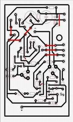

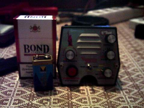

    • I have pretty broken Fisher Gold Bug2, some parts missing,dont have schematic....
      So..the hell with Bug 2. I used its enclosure (same case as with CZ5,1265..).
      But that enclosure is a bit smaller than 1265 so i draw new pcb for it.
      For those intereseted...

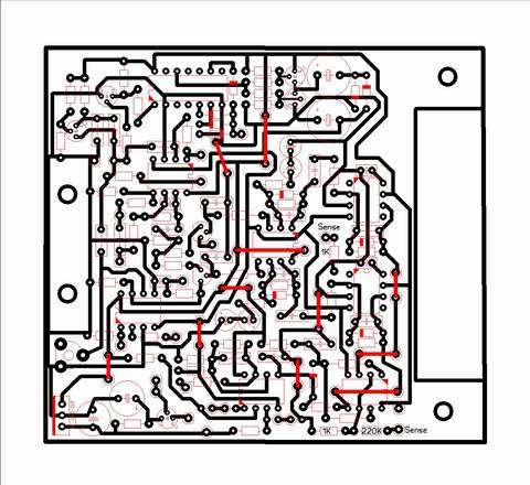

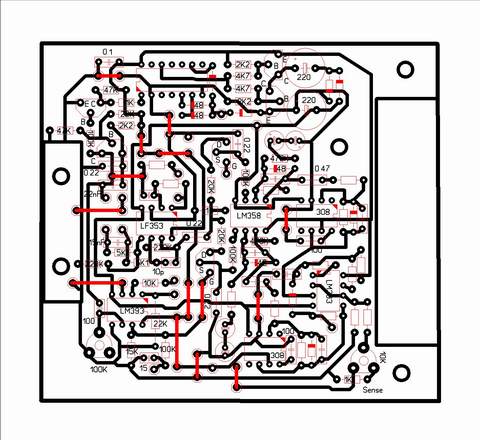

      You will notice some parts are missing. After considering it good i decided to reject "fuse" part from oscillator stage. Occupying some space on pcb yet showed as uselles so far...
        • Now...previous was one pcb version, without latest mod. You can always add "piggy" over it and include that mod.
          This one is also Gold Bug2 pcb version, but full TGSL included and splitted on 2 pcbs. On second pcb mod is included. There are correctly matched points on both pcbs. Put hard wires through those holes, solder to both pcbs and larger will hold smaller, no need for extra holders than.
          Enjoy!

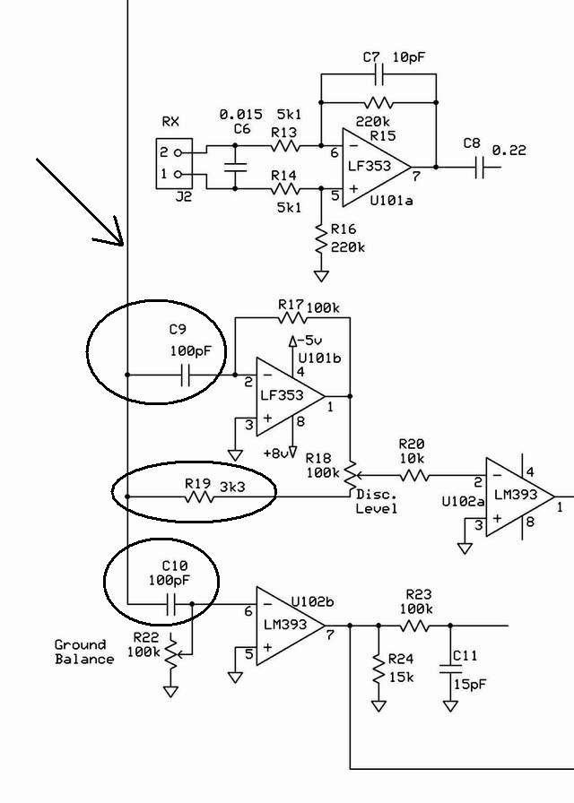

            • Now...one more thing;
              it is often case TGS/TGSL to produce ocassional chatters and falses.Oftenly in All Metal mode,rarelly in Disc mode, so as i noticed. Especially if Sensitivity is adjusted high, usually over "8"..
              Simillar case is almost with all other types of VLF metal detectors i saw so far. So as i posted in the past, Minelab Musketeer is having same behaviour.
              I reconsidered this many times.
              TGSL is very stabille, you can move coil,punch it,swing cable...still perfectly stabille neither one false or chatter. But those still apears from time to time.
              Problem lays inside machine, not coming from coil and cable, i am sure!
              One of possible explanation could be Quiaozhi's earlier remark on comparators hysterezis. So i checked those. But hysterezis exist there and it is pretty good soluted.Comparators inputs are fed with enough signal to keep those calm...
              Next possible cause could be something arround threshold stage. I experimentd much arround it...have found nothing so bad to cause simillar problems.
              And finally my last doubts are on this one (posted pic).
              From collector of 2N2907, signal is fed to GEB/DISC stage.
              That connection is very criticall!
              100pF pass capacitor MUST be HIGH quality. I am also not sure about proper signal amplitude there!? If it is too high than it may cause ocassional problems...and if it is to low ...same case also!
              How to establish proper signal amplitude there? How to stabilize it...to have no "jumps" ?
              It is very critical - it affects phase very much. Could shift phase and distort Disc range dramatically.
              I am working on this,though i could use some extra help here
              P.S.
              I will repeat again; TGSL even like this, is very,very stabille.If Sense is "8" and lower, and Disc mode is ON...than no falses and chatters at all.
              But where is progress if i leave it like that and stay satisfied? No way!
              I will push this more and more to make it perfectly stabille with Sense adjusted to maximum and to stay like that in All metal mode also!
