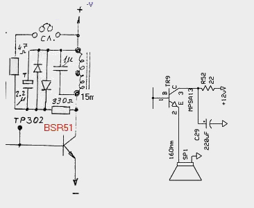

                  New idea:
                  I already asked Max about it, but still.... look at this picture, see the similarity? Could it be used for this project (it's the audio from relic hawk)??

                    New idea:

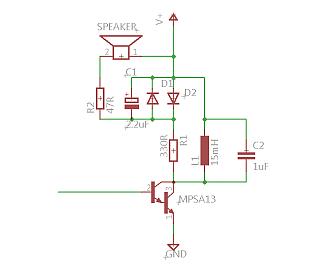

                          • I draw what I mean, do you think this is going to work?

                              9V battery on TGS ? No good. Will last few, expecially on the speaker.
                              IF you mean on TGSL (smaller circuit, smaller consumption) it could be good... but you'll get lowered audio cause audio stage runs on battery voltage... so the more you have, the more it sounds strong.
                              In TGSL with headphones you can use 9V battery... but just using a very low dropout 8V regulator instead of 7808 (that requires at least 11V on input to work good).
                              A 9V alkaline (e.g. duracell's one) could last also 15hours if device is used on headphones only. This is similar choice to bandidoII strategy... use headphones and battery will last also 20hours in bandidoII, for real (this is also due to lowered consumption of bandidoII components).
                              NiMh of small capacity must be avoided on TGS/TGSL... 200mha are not enough for decent performances and duty. Better something around (at least) 500mah.
