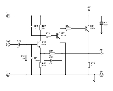

                  I was build two versions of TGSL until now. One respecting original TGS schematic but with notch part excluded and with BD140 audio part, and a version using original schematic with BC517 in audio part with only notch part excluded, and audio loudnes go to be same in both versions. I tried this with several coils I build. I was not try with Fet and Zener excluded from TX.
                  • And I forgot. Extra loud audio I got with audio part used from Promet1 schematic. Just added small pigy PCB.
                    Darko
                    • BD140 audio is taken from Cscope (BC636 originally) also!
                        Then, you must try this! Much better and stronger audio.
                        Cheers!

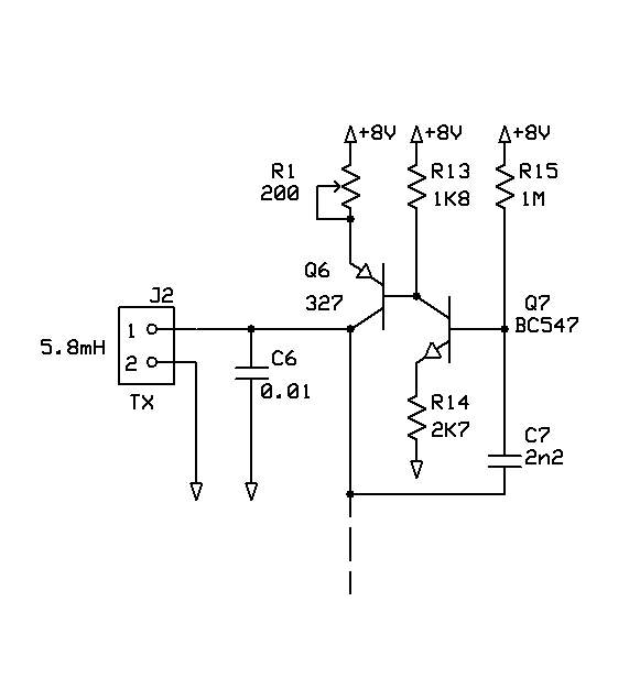

                        • More power on TGSL
                          Ok, i was looking the way to gain more power. TGSL's oscillator as it is, is weak. So i made small experiment on perfborad. I took oscillator from Classic III (or Caesar - "Serbian most wanted") and connected TGSL 5.8mH TX coil to it. Not good, frequency was about 4.6kHz.
                          Than original 0.22 capacitor reduced to 0.01 and than gained frequency is approx. 15kHz. Scoping that signal and adjusting R1 (200ohms) i noticed that amplitude goes up to 45Vpp !!! From 10Vpp to 45Vpp!!! Wow! Aint that a power!?
                          But...signal shape is not good sinus. It looks more square than sinus. Not good.
                          So...
                          I would like to hear opinions on this;
                          in LC tank which combination is more desirable; small capacitance and larger inductance or oposite? Are there any major drawbacks if capacitance is small and inductance large? Oposite?
                          Other words; are there any major sideffects to be expected?
                          I presume TX coil would have to be made different than it is now. Smaller inductance and for C6 to use larger capacitance.
                          Also, since amplitude is now much higher, are there any possbile problems than, at coupling to phase circuitry stage?
                          I will experiment this anyway and find out proper solution, just want to hear other opinions...

                              Good question -- and very interesting such high voltage.
                              My premature opinion -- we want maximum "ampere-turns" in our coil for max magnetic field. (That assumes that more is better...)
                              So if we experiment with LTSpice (or equations!), we can try different values and graph current in coil for different arrangements (don't forget to increase resistance of coil with inductance).
                              Then we use Qiaozhi's coil calculator to estimate the number of turns.
                              Then multiply current X turns and find maximum magnetic field.
                              Maybe that is best??? If interested in depth over everything else, maybe. Maybe compromise for least battery drain, or other...
                              As for high voltage -- you know my story with TGSL, I feel some cases need voltage divider from oscillator if too high for discrim circuit -- maybe same here.
                              -SB

                                if the signal is not sinusoidal I see it very hard use it on device.
                                The 45Vpp could have a meaning if sinus stuff... but getting sinus wave with that amplitude at 14Khz is not so trivial if use common e.g. low power transistor stages.
                                The best will be resonant stuff... but we know... resonant coil/tank/oscillator is not easy solution.
                                The best tank is the one that have max Q ... in most cases inductor and capacitor are balanced to achieve higher Q from that thing... thus resulting in a narrow peak and higher...
