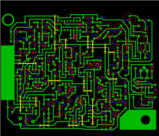

      here's a little mod to original Ivconic's design:
      - added monostable
      - added transistor audio stage
      Both you can use or don't use selecting appropriate jumpers.
      So you can even mount an standard tgsl using it... or add components and make mods appears easy if wanna try them.
      Board is error free, I made it and works cool. Enjoy!
      Kind regards,
      Max

        Nice idea, thanks!

              • Max the 1K resistor is still missing

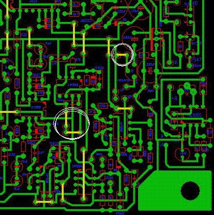

                • Hi Max!
                  Any reason for those jumpers ?
                  regards,
                  Fred
                    Hi Max!
                    regards,
                    Fred
                    only reason for many of that jumpers is that you can easy customize e.g. your audio output, choosing standard audio or transistor mod or monostable or a combination of them.
                    Broken tracks are useful if you plan of insert e.g. a switch to control the output behaviour (like I usually do). You don't need to cut anything... just remove the jumper and place a wire etc
                    Off course, if you already know what you need (cause already tested that mods) you can skip jumpers and put solid tracks instead. Even remove parts that you don't need and use existing pcb or make a custom one. But all that you do when you already know what you want!
                    I had thoughts on that board version cause I wanna all there... I think it's the most versatile way to test... when you need to try... I mean, having all designed on the board... then you just need adding components to try a mod... and modify a jumper: that's somehow like happens in development boards.
                    I made it mostly to test Ivconic's PCB design...(that's btw fairly good about noise!) but also to perform new checks on existing, known mods: then I put it here for all people who wanna try them too.
                    Season's greetings!
                    Kind regards,
                    Max
                    • Hi Max,
                      All OK, i was wondering about those circled ones as Ivconic had those too and i could not see why there was 2 jumpers "in serie"
                      Glad that the forum is back,seaons greeting to you too and all readers.
                      regards,
                      Fred.

                        Hi Eclipse - I appreciate your PCB. It is very helpful, I'm trying to make slight adjustments for my components, some are different size.
                        By the way, I think there are still a couple of 100k resistors left over from the battery check that you could remove (you did remove the 220k resistors) if you want.

                              which are the other resistors which need to be removed (need-a-pic)
                              if you guys spot something wrong with the board let me know
                              cheers
