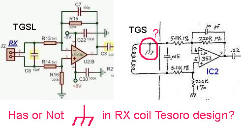

                              • Has or not contact to the negative battery pole clamp in RX coil?
                                According the schematics, in TGS Light - Not?, but in TGS - Yes?
                                What is true?
                                I readed contradictory opinions
