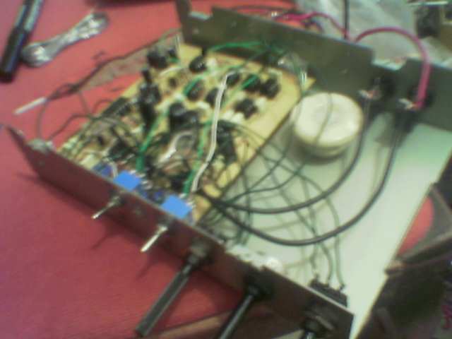

    • hi to everybody. i built a tgs and i have something to ask you guys. i saw a video clip on youtube about someone who is testing tgs with different metels. now, i dont get the sound like that, and i was wondering could anybody else go and see the clip and tell me if i should have the sound like that. thx in advance. and i also think that something is wrong with my detector cause i can remove 90% of ic"s and it wont make any difference. i wound a dd coil 22 cm in diameter 100 and 105 wounds, is that correct?
      • Originally posted by gagi_pirot View Post
        Ivconic posted informations about coil data: 100/105 is good ratio for TGS... find also a way to wound like in old pictures... with nails etc.
        Finished coil is under 11' diameter DD, with very good null required.
        I don't know about this video on youtube... so cannot answer you about sound you heard.
        Kind regards,
        Max

              • No, sound on video is not good at all. It is doubling all the time, even on a very weak signals. This mean only one thing here; some of coils is reversed.
                Looks interesting in air (pseudo rich tone) but on soil it will give so much problems and falses....
                • ok. thanxs a lot all of ya. you clear my mind. my result are about 20+ cm with 1 dinar (20mm) coin, and i am not satisfied because i have a lot of false signals, my coil is awfull. Ill try to do it like i supposed to, then ll publish my best results. And i am not sure that the electronic is working 100%, at least in my case. per example i got from supplier lm308n and 308an, and when i change its sides i wont work at all. i just want to add that i draw a pcb at first and it didnt work, than i try with the photo system one time and again after that, and i hit the wall in any possible part. i will aprishiate any suggest about my future work, like where i should pay more intention.
                  im sorry for bugging you guys, i hope you will not understand it bad.

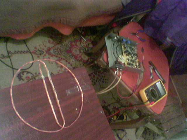

                    • its me again. i got 25 cm with 20 mm coin, a deodorant spray about 50 cm, but without faradey. does anybody know where can i find a foil for shielding. i tried before with kitchen foil earlier, and i read on this forum that it is too thick. what you guys used? ill take a picture and post it here very soon, as long you dont get the heart attack with my sloppyness.
                      • i dont know why it screams when i touch it, even on cable, and when i blow in coil it react also, maybe couse the coil aint finished yet?
                        • alu foil(aluminijumska folija)
                          "gagi_pirot"
                          Za dan ili 2 ,mozda cu moci da ti pomognem u vezi aluminijumske folije.
                          Pozdrav !

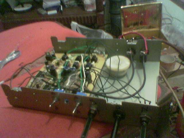

                            • Gagi, wish you success with that! I think you should constrain those bulky wires togather. Might reduce some noise there.
                              Gagi izvini sto se pravim englez, ali primetio sam negativne komentare kad god neko napise ceo post na maternjem jeziku. Jbga, moram postovati forum i clanove na njemu.
                              Prvo, moras staviti faradejev kavez na namotaje jer testovi bez toga nisu merodavni.
                              Drugo, zaista si mnogo "rascupao" zice na sve strane.Taj detektor je namcorast i hoce da sakuplja razne sumove i interference ako zice nisu kratke i ako nisu lepo slozene. A gde ima dosta suma tu ima i lose detekcije.
                              Trece..sonda,sonda i samo sonda... moras precizno da namotas sondu da namotaju imaju tacne induktivnosti, a narocito precizno da nulujes namotaje.
                              Na izvodima RX namotaja moras imati sto manji indukovani napon. Tesko i pipavo ali izvodljivo.
                              Za opsirnije komentare mozemo kontaktirati preko Skype-a. Posalji mi na mail tvoj nick na SKype-u i ja cu te naci.
                              Pozdrav!
