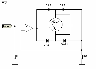

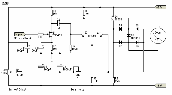

    • Hi all,
      here is a website with a project like I mean for people having problems reading small voltage values using bad meters:
      http://sound.westhost.com/project16.htm
      Of course, maximum resolution seems limited to 3mV but it's not bad considering that a few of real multimeters can gain such a precision on the e.g. 200mV scale for signals of 10-15KHz frequency.
      So take a look... I've also others (somewhere) printed stuff but cannot find at the moment so posted that reference to the website of above.
      The meter circuit is like in the picture ... one op. amp... some diodes ... all easy stuff.
      If you wanna do even better use some more discrete components, fet etc...picture below.
      The complete project require another part (attenuator) but for nulling coils it can be omitted just limiting readings in the lower range only.
      If you haven't a scope or a very good multimeter I suggest you think at it as an alternative for nulling coils.

                  • Hi,
                    Max.
                    Can you give more details about this circuit.Because I have found that the problem is in the multimeter that I use for nulling coils!When conect like you say to try to null I have noticed that when I reach 0.00 mV the zero moment is now short,but wide!I can moove noticable distance RX over TX and multimeter reads 0.So I am pretty shore now that this is waht is messing me!
                    What multimeter did you use for sucsesfull nulling?
                    • Hello Tiktak,
                      I am sure any voltmeter will do the job, you just have to put it in AC at the output of lf353 (pin 7) and you will find that the best nulling is very dificult to find,no dead spot at all!
                      and you will never get 0v if everything is normal...
                            I use scope ... but any good AC millivoltemeter will do the job. Also Fred is right... you can measure at pin7 of LF353 for minimum voltage saving you the work of making yourself amplifier/millivoltmeter circuit.
                            It's your choice.
