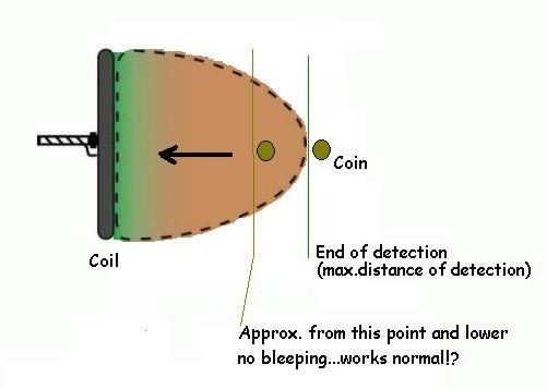

                        • Yelp!
                          Actually, it seems very strange and very interesting!
                          In All Metal mode, already mentioned problem occurs ONLY WHEN
                          APPLY COIN TO COIL FROM GREAT DISTANCE AND CLOSE TO POINT WHERE
                          IS JUST ABOUT TO DETECTION OCCUR!?
                          But when move coin in the zone and accurate detection no problem at all.
                          Detector makes "beep-beep" and than stops normally like in Disc mode.
                          So let's repeat;
                          it cant stop beeping ONLY if coin is approximated to coil from zone out
                          of detection,slowly...first "beep" occurs and no matter if coin is
                          removed, beeping continues until switched OFF or I HAVE TO PUT HAND ON
                          COIL OR EVEN HELPS WHEN I TOUCH THOSE 3 WIRES WHICH CONNECT PCB WITH
                          DISC/ALL SWITCH...OR IF I RANDOMLY TOUCH SOME PART (BUT NOT EVERY) ON
                          PCB...IN THOSE CASES IT WILL STOP WITH BEEPING.THIS IS THE CASE ONLY IN
                          ALL METAL MODE, IN DISC MODE ALL IS WORKING PERFECT!
                          Also if i move coin from a side into "sure detection" zone, let's say
                          10-15cm away from coil surface (must be much louder signal than) than
                          device is working normal,same as in Disc mode, no beeping more when
                          coin is removed from zone of detection????
                          Today i tried somehow to dig what is all about - but no results.
                          Coil is prefect, no doubts in it. Cable wirements from coil to device is
                          also good - no mistakes, no twisted pair effect, absolutely stabile,no
                          false signals....nothing!
                          I put sort of "gnd cage" over those switching fets - still the same...
                          it seems fets are not problem here despite a lot of noise they producing.
                          I changed that 15pf, replaced...tried even without it...- same...!?
                          Coupled LM393 supply pins with 0.1 to gnd...- same...?
                          Damn!Damn!Damn! This thing is making me crazy! It is not a big deal to
                          have detector working perfect in Disc mode but not in All Metal mode.
                          I can live with this.It is working so good in Disc mode so i dont mind
                          about beeping in All metal mode at all. Besides i am not using All Metal
                          mode anyway...
                          But from constructors point of view this thing is interesting me much!
                          I just would like to understand this better.
                          I would like to see others opinions on this! Sean,KT315,Carl...others!
                          Please come here and help us to solve this thing!
                          What should be a problem here?
                          Regards!
