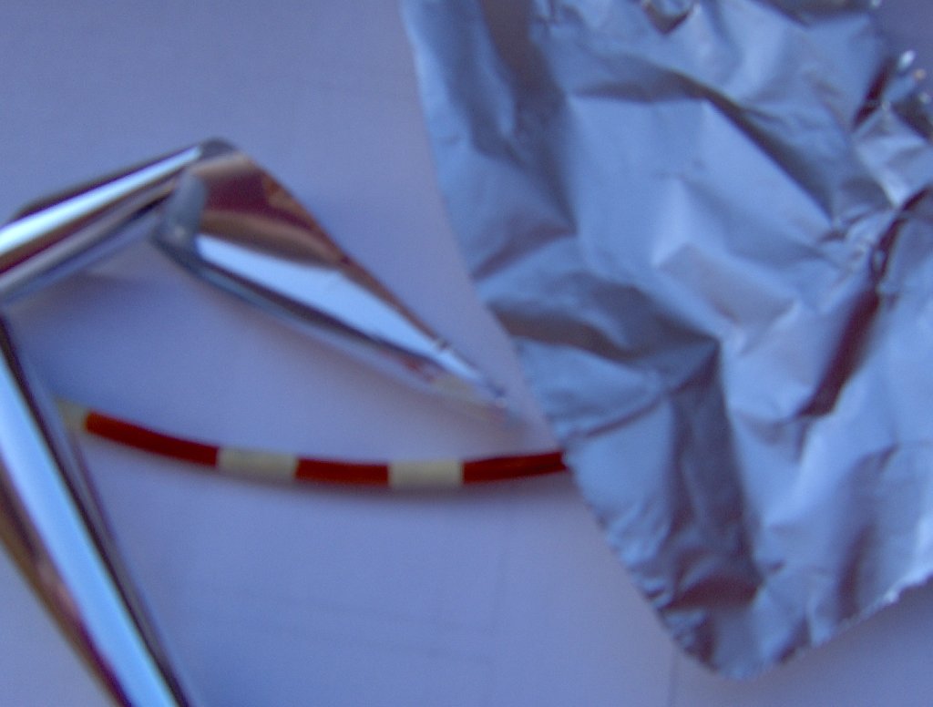

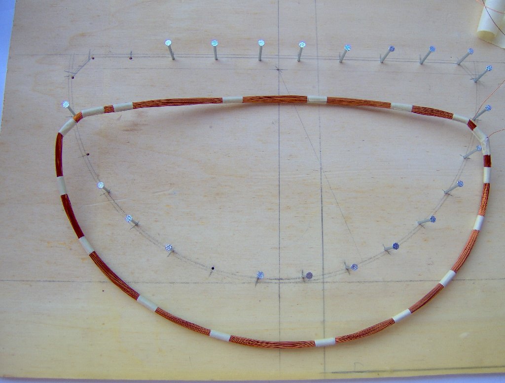

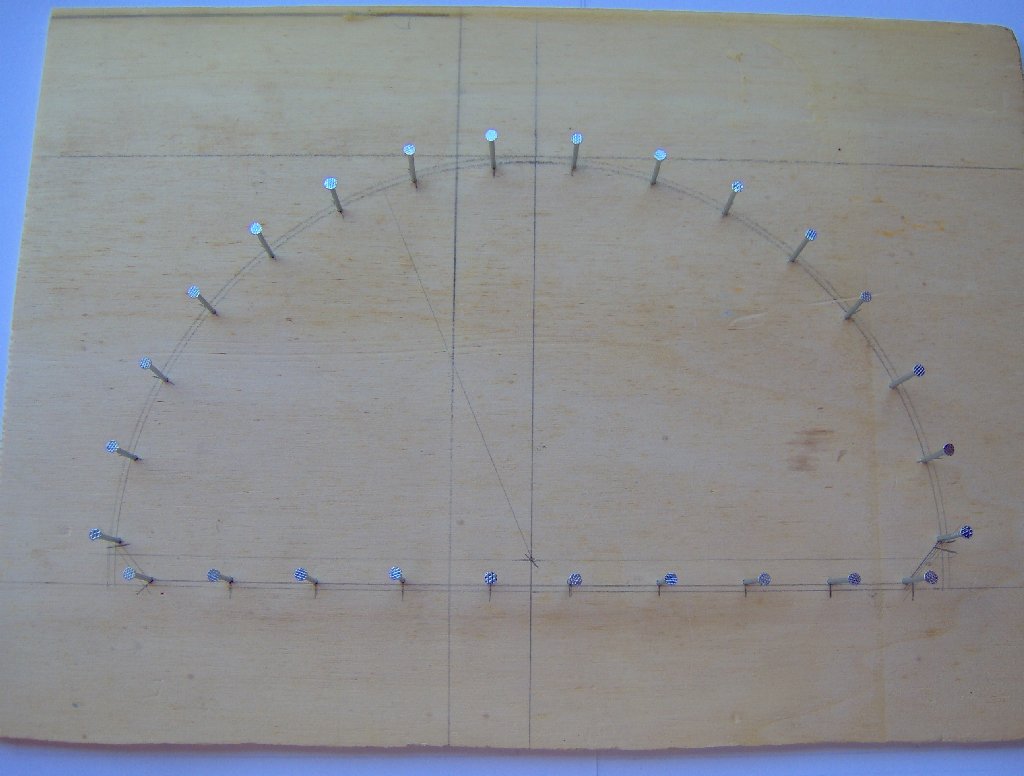

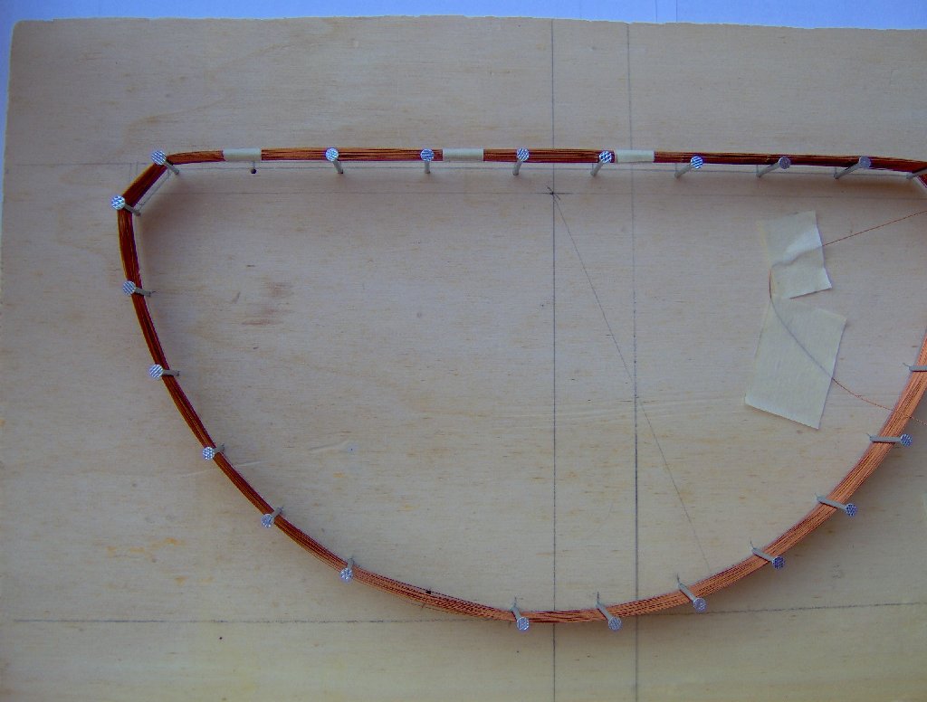

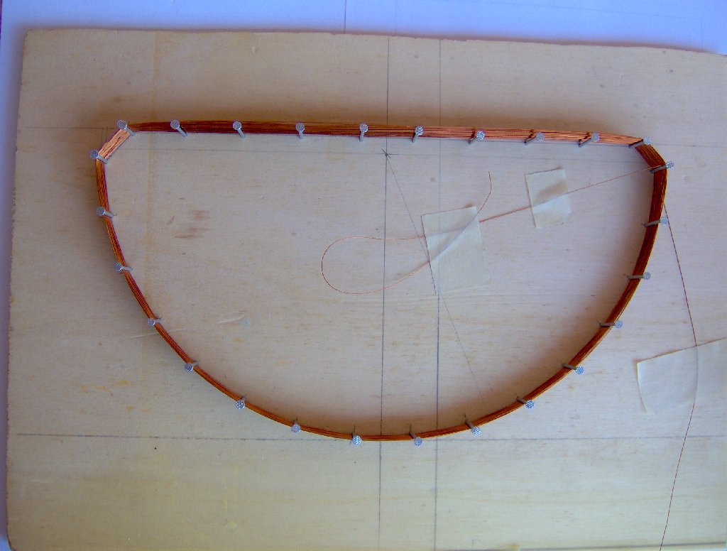

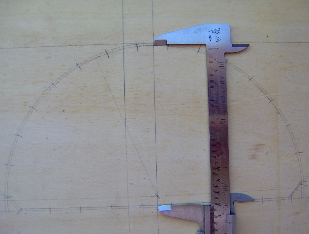

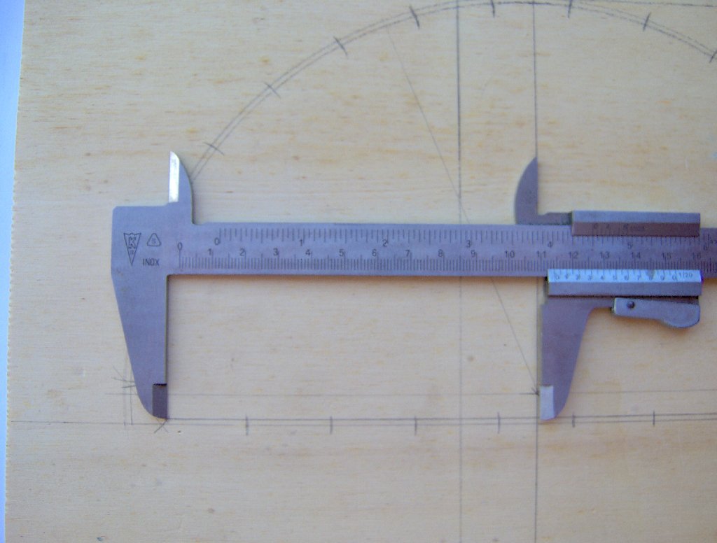

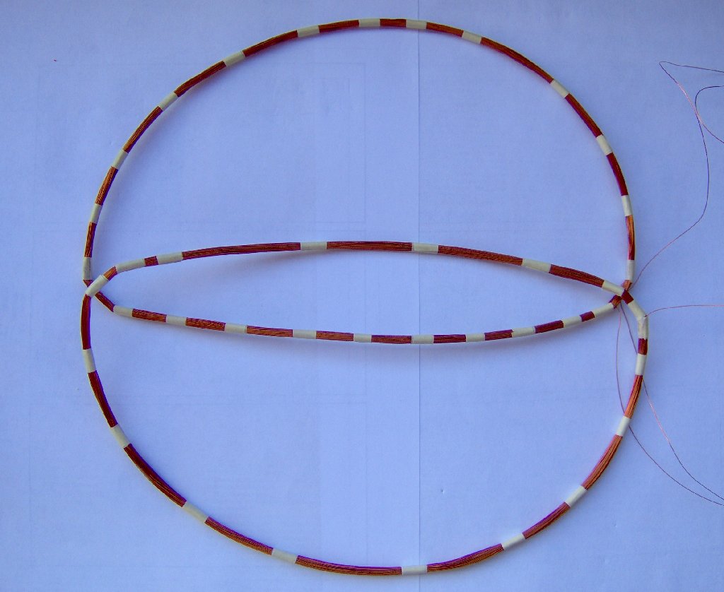

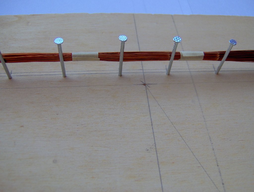

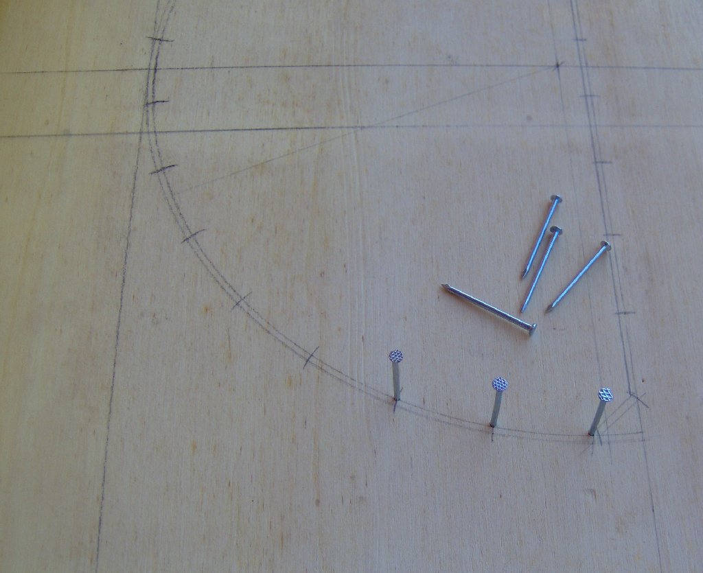

      • other pictures.... (notice the paper tape used for tightening the wire...
        seems a west coast custom's works... but at the end is very easy to put and if needed to remove it).
        • other pictures......ops here is the paper tape

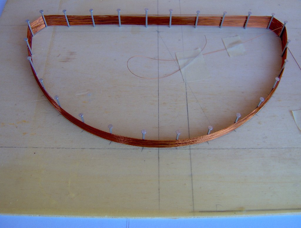

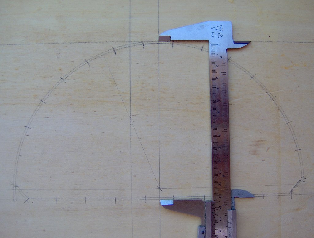

                      "Got 5.62 mH inductance, giving me a freq. of 14.69Khz on TGS, R=23.1ohm !"
                      Max i made same coil twice. First with 0.25mm and second with 0.3mm, just for
                      comparsions. Have a feeling that one with 0.3mm is a bit better!?
                      I suggest you to do the same and later post here your remarks, please.
                      Of course, number of windigs should be corrected a bit...few more for both coils.
                      You will gain less resistance of course. But those will work fine even resistances
                      are down to 18 ohms approx. No worries.
                      "A picture is better than 1000 words."
                      You got that right! I agree. Photos you posted giving me exact picture of your work.
                      That coil will work very good!

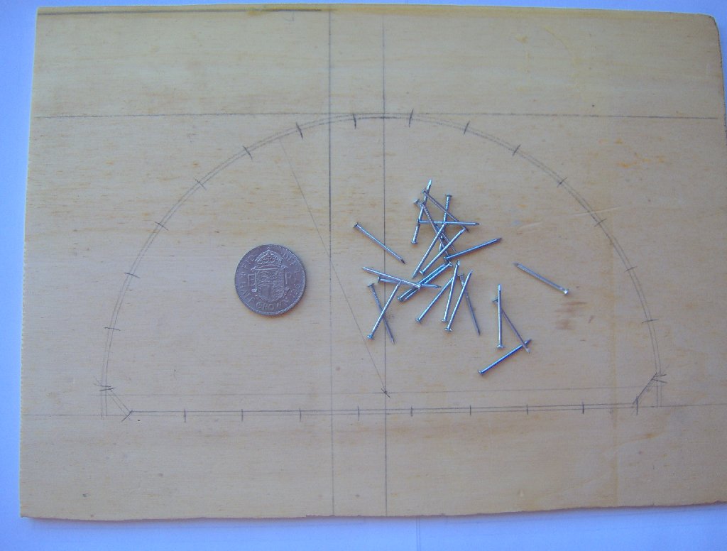

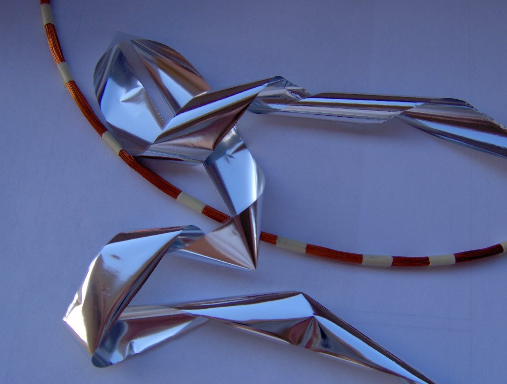

                        Hi Ivconic,
                        yes works very good, tested just 30minutes ago... and still wonder of how good it is.
                        Got 1eur coin at 36cm easy on air on the test bench just keeping halves fixed with tape on a flat board !
                        Very good. The half-crown (that is 32.5 mm diameter) at much more maybe 40 who knows ? I haven't measured at all... just too amazed by results.
                        Nulling is (at now) around 4.5mVpp very hard to get cause tape is no good for that torsion forces on bigger coil and have to use much for test to keep them aligned.
                        Now... the big problem for me is applying a right shield (they are now actually unshielded) puzzled between what to use this time... wanna use mylar but have few... ad don't know if good idea ... maybe I'll use a bad kitchen roll, very thin al.... and of course... finding a right coil-housing to seal it.
                        I'm very happy with results and suggest anyone here build this configuration for a good compromise between coil dimension and depth.
