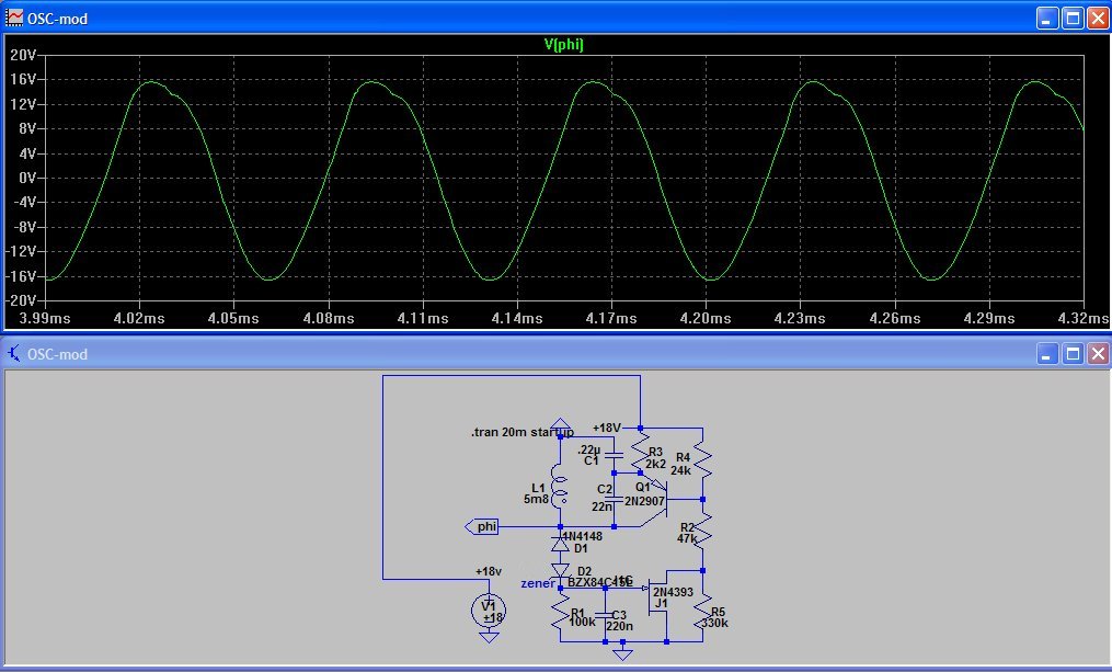

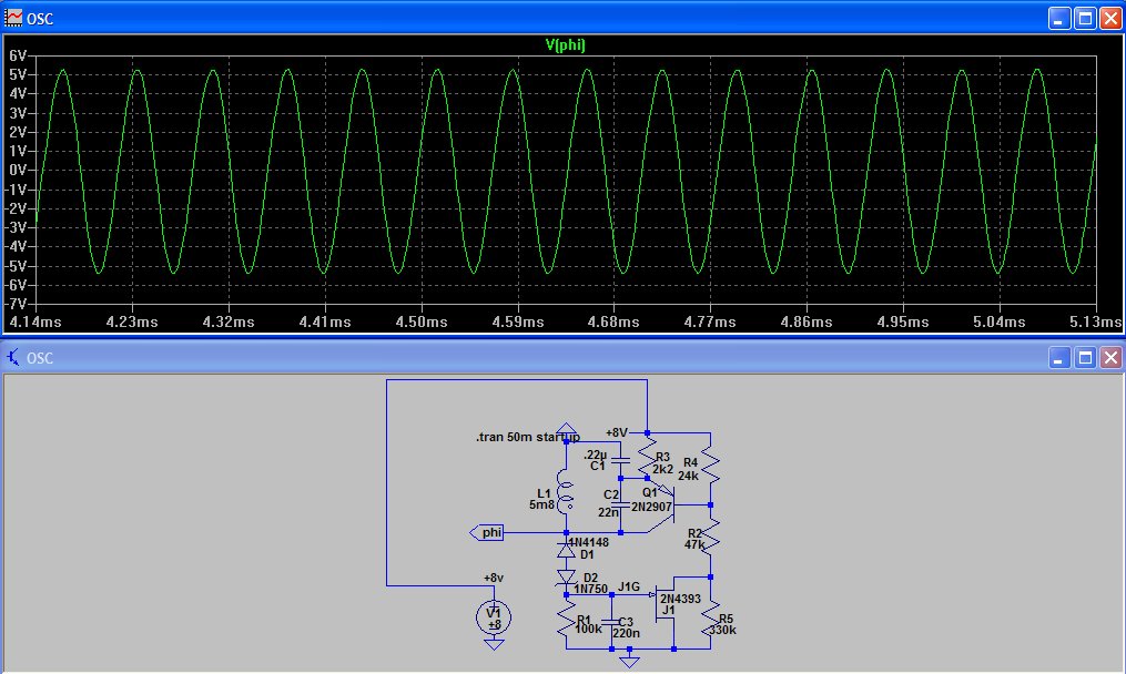

    • little osc simulations
      I've downloaded LTspice and using some parts of files from porkluvr I'm doing some training on the simulator... just to see how to move around menus.
      I'm happy of results cause I find it really intuitive and easy to use...but that's my impression... you could contestate!
      Anyway, I've simulated the original (about) TGS osc with a 4.7 zener diode and 8V supply....
      then I've changed the params... using a 15v zener diode (BXZ84C15L) to see the jump at output voltage.
      As you can see with that +18v supply and 15v zener it gives about 30Vpp instead of original about 10Vpp: 3 times.
      No other mods seem required e.g. for PN2222 that drives the 4024... but , of course, one have to put a stable +18v supply for osc section only (few mA current required)...even 2x9volts batteries could be good for tests.
      So maybe people that want experiment with osc signal amplitude can do that way... well signal is not a perfect sinus on sim but I think could be ok for some raw tests.
      I think that there's no need of that change on TGS... cause I found really good as is... but if someone would like to try... and inform us of results e.g. in air will be cool!
