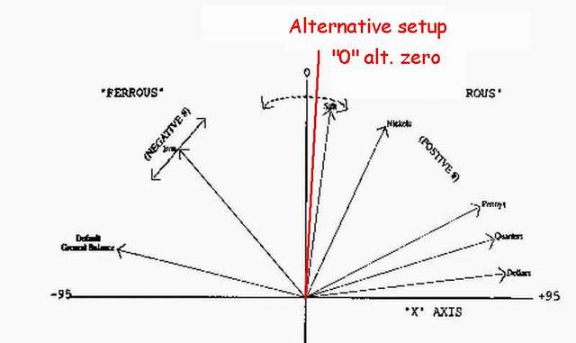

                • Alternative approach
                  So, i tried to setup alternative "zero" with this way of nulling coil. Why? TGS already have sufficient GEB&DISC adjustments...
                  Dirung working with TGSL under real conditions i noticed situatin on SOME fields TGSL cant be grounded well; it still can produce fast chatters ocassionally...similar with almost all other detectors.Even GT (which is very stabile) sometimes can jitter a bit. Despite all my love for TGSL i still have to say that its GEB is not perfect. When testing in workshop it can absolutely reject ferrite,iron and simillar....even that famous mineralized clay. But outdoor i noticed some jitters from time to time. To repeat; when handling with cable i cant provoke any falses, also touching coil - still no falses, very calm and stabile. But swinging arround few inches over soil surface, sometimes it can bleep??? I still havent find out what should be the reason of that? Several different coils were checked, so i simply can not blame coils for that...Adjusting GEB trimmer slitely mm per mm wont solve problem.Actually GEB trimmer is more likely to affect discrimination than GEB? If rised more you can easilly lose some coloured metals like nickel coins or small silver...GEB trimmer is adjusted at the very point where is just about to lose nickel....
                  So i was thinking somehow to extend that part of scale. But how?
                  So i left device aside and tried with coil.That's why nulled latest coil in a bit more "positive" manner...Is it good? I dont know yet. I'll see when rain stops .
                  I want to ask you is there any other way to extend GEB adjustments on TGS?
                  Putting multi turn trimm wont solve the problem..

                    Yes Max, same with my devices! See my previous post. It has something to do with GEB&DISC part. Something is to "narrow" there? What?
                    Try to play a bit more with GEB trimmer - you will see huge differences...

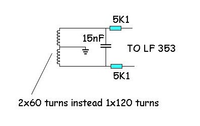

                      How about this substitution for RX coil?
                      Any benefits,drawbacks...?
                      What do you think?

                        Hi Ivconic,
                        as always you give us good informations and ideas about how to approach problems.
                        I've tested behaviour on 5 different soils at the moment and find that 2 gave me problems with fixed geb setup: the trimmer position I've adjusted on middle soil gave me bad working on 1 soil made of a mix of sand (or similar to sand) and clay... all right - iron salts and oxides are present there. Erratic bursts of noise when e.g. a small ammount of soil (not perfectly plain) give such an height gradient (like a small "hill") respect to the sorrounding part of soil.
                        In plain area the same effect occours at random... and I don't know cause but think there is something in the underground layers structure that point detector on the same way or hot rocks, result is the same: noise.
                        In another soil I get some rare bleeping similar: soil is made mainly of clay this time.
                        Other 3 test sites showed perfect performances and nice depths with NO BLEEPING AT ALL. Soils are different and made of mix of clay and "sand"...one has hi organic compounds presence on first 10-15cm.
                        Is that GEB that need adjusting ? I think so.
                        I've made bandidoII and it has an extended disc mode and multiturn GEB pot that make it possible find the exact spot where GEB is perfect (but not so easy to find). I think that TGS would benefit too of a multiturn GEB pot... but I agree also with you on DISC effect of geb trimmer (really easy to see): all right... multiturn pot won't solve our problem totally.
                        Center tap to GND ? I don't know if could solve it, but it's an idea... if noise, as seems, is related to ferromagnetic gradients probably their amplitude influence would be cancelled out by this config respect to GND...
                        I think that it's a forced diff. configuration for the two halves... thus giving cancel of signal due to noise... but also to targets... : that way will be more stable but I'm scared we'll lose some depth.
                        Only way to know is it could solve or reduce problem is try it.

                        • Hi,
                          watching again it I start thinking at fact that LF353 diff config would amplify differential signal from the external leads ...so the sum of the two halves of RX... and that the effect respect GND is totally differential... so no noise or signal respect to GND at rx external leads...cause of the center tap.
                          An advantage could be related to shield to coil capacitive effects during transients... that configuration will null the effect due to the fact the shield will always see same voltage for the 2 rx external leads , also with huge differences respect to the real voltage potential between the two: this will improve SNR if transients generate falsing due to capacitive effect inside the housing... due e.g. to the previous config (one lead at GND and the other "floating") that seems a realistic perspective for an MD coil.
                          That means, if noise is related to e.g. capacitive histeresys of dielectric between coil and shield, we'll get a more stable design that way.
                          Ideally that will improve SNR but considering the splitting of RX in two sections we'll have to consider also the mutual inductance effects between the two-> we'll have an air core transformer at RX and that will add inertia to the RX side cause of magnetic mutual energy interactions of the two halves.
                          That's a secondary effect but could have its importance in whole MD performances... expecially for deep and small targets.
                          What do you think ?
                          Best regards,
                          Max

                            The ground balance works by sampling the received signal at the zero-crossing point. The theory is that both ferrous and non-ferrous targets affect the amplitude and the phase of the received signal, whereas neutral soil will only cause a decrease in magnitude. There is no phase-shift. Since you are sampling at the zero-crossing, the GEB channel cannot detect a change in the amplitude of the signal unless there is also a phase-shift. Ferrite causes a similar response, and that's why it's often used to find the correct GEB setting. Unfortunately ferrite does not react exactly like real soil, and the offset can be as much as -5 degrees. If you're using a preset GEB, then you will need to adjust it off from the ideal position by a few degrees and set the threshold to silent search, but the best solution is to have an external GEB control. If you set the GEB control to any position other than sampling at the zero-crossing point, then it's not acting as a ground balance control.

                              • "..That's a secondary effect but could have its importance in whole MD performances... expecially for deep and small targets.
                                What do you think ?.."
                                Dont know yet.
                                Worth of trying. I'll try that and later inform here...Might be that some extra changes needed arround front end...i'll see.
