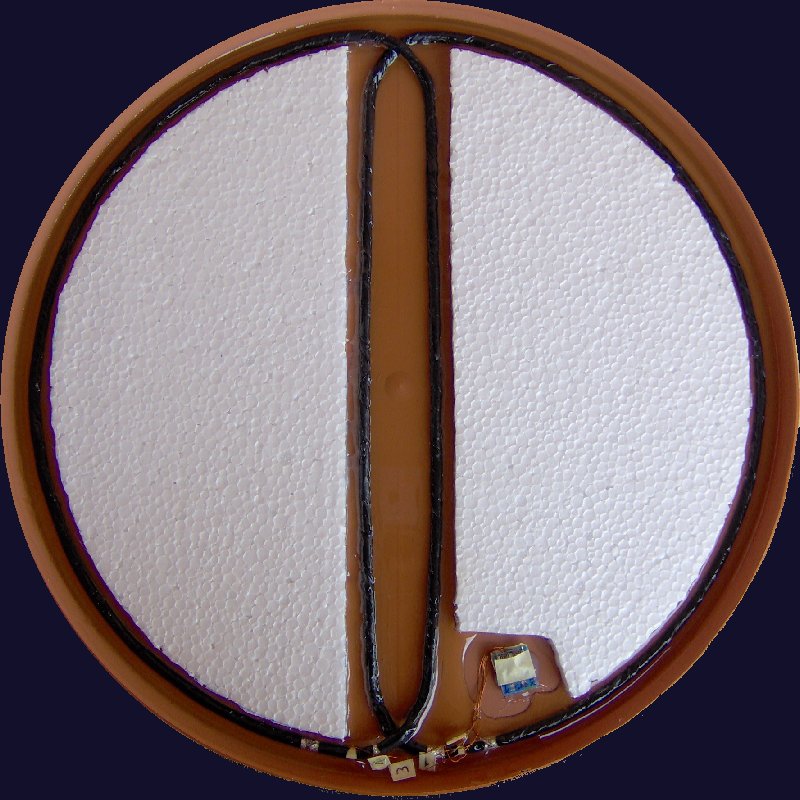

              • new (gigantic ?) 12'' coil for TGS
                Hi all,
                I've made a new one...for teh collection... this is a 12''DD for TGS, as well as other uMax models, can use too.
                Here's actual recipe:
                wire 0.25mm bare (30AWG)
                TX turns = 88
                RX turns = 92
                TX resistance is about 24ohm
                RX resistance is around 25ohm
                TX L = (about) 5.7mH
                RX L = (about) 6.15mH
                For those who need MUCH depth...
                Can get a coin at 50cm (half-crown)!
                1eur at 42-43cm , in disc mode.
                Bigger stuff at incredible depth....like a small round copper thing (6cm diameter) at 65cm !
                Do you think this will win the cache test challenge now hands down?
                I don't care much... personally I don't like large coils over 27-28cm diameter but made this to check how much TGS can be pushed with 30cm... and it can be pushed to work in the 50cm range on big coins. (at least on air)
                I've tested with a small container and 5 silver coins of about 2 cm inside... and it detects the container (plastic stuff) easy at 60cm on the air.
                Disc seems works right way, iron about ignored if soft... steel detected sometimes (like other coils , also originals).
                Ferrite is nulled well and works good on normal soil, not tested yet on hard soil... mineralized stuff.
                All measures made on air.
                Anyway... here it is... who like big stuff can try it.
                Inner diameter of DD is exactly 30cm, so 12''.
                DISCLAIMER:
                Tuning is critical cause of sharp phase shift requirement to get good depth on silver and mantaining iron disc, but can be done with lot of efforts and patience...for this is similar to other homemades that require also similar trial and error process... using test targets to check at each small movement. Just this is more sensitive... and require enormous care on that.
                So before attempting making one... ask yourself if you're brave enough! You can have lot of troubles trying to replicate it... I've told you.
                MADE AT YOUR OWN RISK...and please no questions...I've already gave its recipe.
                BWT, I think it will bust any original 10x12'' or widescan from Tesoro... but I haven't so cannot compare. Just my experience with originals say me that...
                Enjoy!
                Kind regards,
                Max
                • Nice work Max!
                  Nice coil collection for TGS
                  regards,
                  Fred

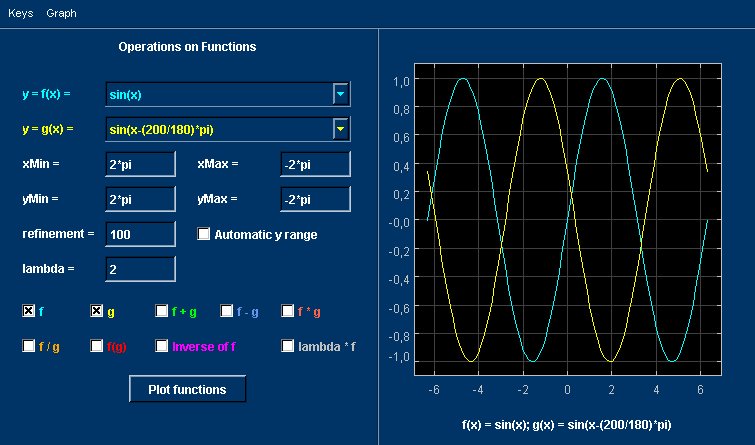

                  • Max plese can you explain me bit more ``with phase required (around 200°) between tx and rx signals``
                    How measure and adjust phase?And if i dond ask too much some picture of that tunning..
                    And please what is center tapering? Coil wouded with alu foil and conect to ground or?
                    Regards too all!
                    • Originally posted by miki73 View Post
                      Regards too all!
                      the phase is relative to Tx signal: you do this way...
                      connect channel one of scope to TX oscillator, ground to ground and probe to collector of transistor.
                      Then you connect channel two: ground to ground... probe to pin7 of preamp (LF353).
                      Then you trigger the scope using channel one.
                      OK... then you'll see that phase shift on the screen... adjust amplitude/timebase of both channels if required.
                      You'll look for rx phase it must be in the 200° range in tesoro coils... at least... both the two I have tested have that similar phase.
                      If it isn't you'll play with nulling... trying to get a good null but that phase shift too. Sometimes, I say you, it's impossible... you scrap the coil and made another... no easy solution to that till now.
                      It's easy... I think Qiaozhi posted a picture with both TX and RX signals from a CC coil from tesoro... but you don't need it... just that measuring phase of RX you'll get around 200°. Sometimes I saw it not critic... even with 185° works too (not as best... but works)... other times, like in these larger coils you need be more accurate...
                      When you have a good nulling and correct phase shift... your coil is ready to go.
                      I don't use center tap in these coils at now; maybe in future homemade I do that way too.
                      You can use foil...why not ? it's cheap and easy stuff... just avoid putting too much, overlap as few as possible.
                      Kind regards,
                      Max
                      • just to have an idea... (only for this time)
                        blue is like tx
                        yellow is like rx
                        you should see something similar...on the scope.
                        • This is phase diference about 200° ?
                          Max you are the best man!Make me happy!
                            yes it is... are 200° for RX... cause the positive edge is delayed 200° from reference (TX).
                            Kind regards,
                            Max
