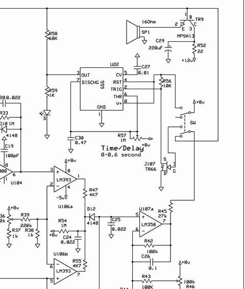

        • Applying switch...
          Yes i have earphone plug installed, with 150 ohms resistor on it.
          Applying switch....see schematic
          Max i am glad you like it..
          Regards!

            Yet this latest mod, "delay" has some drawbacks; mostly i dont like constant lasting of audio. Man can not distinguish depth and size according to this audio. So i added a simple switch on box, to easilly switch between "delay" mode and "not delay mode". In "not delay mode" TGSL works ordinary with variable lasting and strenght. As coin moved away from coil, audio starts to decay and last shortly, man can easilly distinguish distance and size of detected item.
            So operator now can use switch and choose one of 2 working audio modes. Depends of working conditions and demands.
            Also VOL. pot. added to adjust loudness, cose now, with latest mod, audio is pretty loud (as on clip)...
            Must also say that latest mode "improved" depth!? In "not delay mode" same silver coin detection is bairly audible at 40cm distance, and with "delay mode ON" as you can see and hear on clip, it is very loud and clear up to 46cm!!!
            So..this,latest mode is worth of try for sure!
            Regards!

                    • On the last mod TR66 is reversed drain-source
                            Not important there...
                            I did redraw pretty fast yesterday. Using rotate i havent payed attention..
