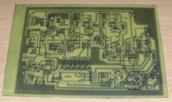

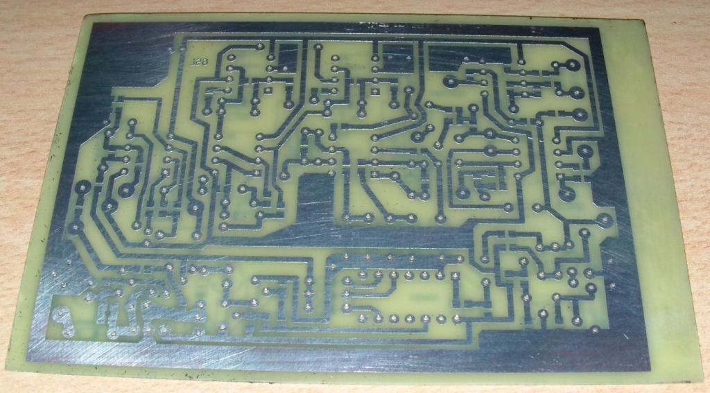

                  • made some boards today

                    all through hole connectors get a single pad on top side (adhesive copper foil) where i connect the with a wire
                    that should save me a double layer board
                            [ATTACH]30900[/ATTACH]
                            [ATTACH]30901[/ATTACH]

                            • Years ago, I used to make all my PCBs myself, I had a really good etching system, expensive one, that I bought cheaply in an open air market, probably 30 years ago....and thru hole plating was somthing I did not even attempt! Getting the pads on the top and bottom properly aligned kept me busy at first!!
                              So as I also usually designed the layouts, I simply made sure that I connected at the pin or leg of various components to automatically make the connection and I soldered both top and bottom of the PCB.
                              Chip sockets can be a problem with getting to the top of the leg to solder, so I always bought the ones with long legs, for wiring using a wrap gun I believe, and set them probably 5mm or so higher than "normal" simply by slipping a piece of card or plastic under the socket, then soldering two opposite end legs. Take the card out, align the socket parallel to the PCB by melting one soldered leg and moving it slightly. Then soldering all the legs both at the top and the bottom.
                              The circuits I usually built were not sensitive to using sockets, nor to the slightly higher position on the PCB, whereas some "better" and more modern circuits may be more sensitive....so be circumspect...
                              Its surprising just how easy it is to slightly change a design to allow double sided boards to be made at home, without any true thru hole vias.....they may work out a tiny bit larger to allow soldering on both sides.....but if you are really careful, this should not be a problem....
                              Even having boards made, money can be possibly saved by not having the vias, though for one offs, the savings would be probably quite small. I have never had professional boards, "made", only simply bought "their" finished product!! Just a thought though!!
