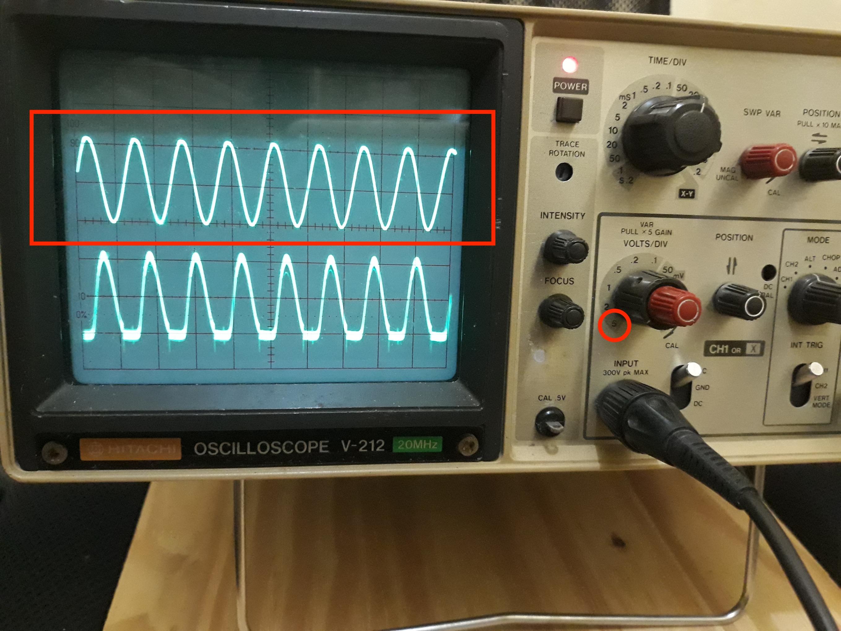

                    I'm having a similar problem.
                    Positive voltage: +7.97v, negative voltage: -6.37v.
                    My TGSL TX amplitude is around 10v, checked the resistance of J1-1 to ground with the TX coil disconnected and it measures about 0.7 Meg, should I worry about?
                    Thanks.
                    • Originally posted by cristiano.sar View Post
                      Thanks.
                      Well, I just found that the problem is my scope, the button at 5v/Div does not work very well, just moving it some millimeter clockwise or using the 2v/Div I can get around 14 and 15v of TX amplitude.

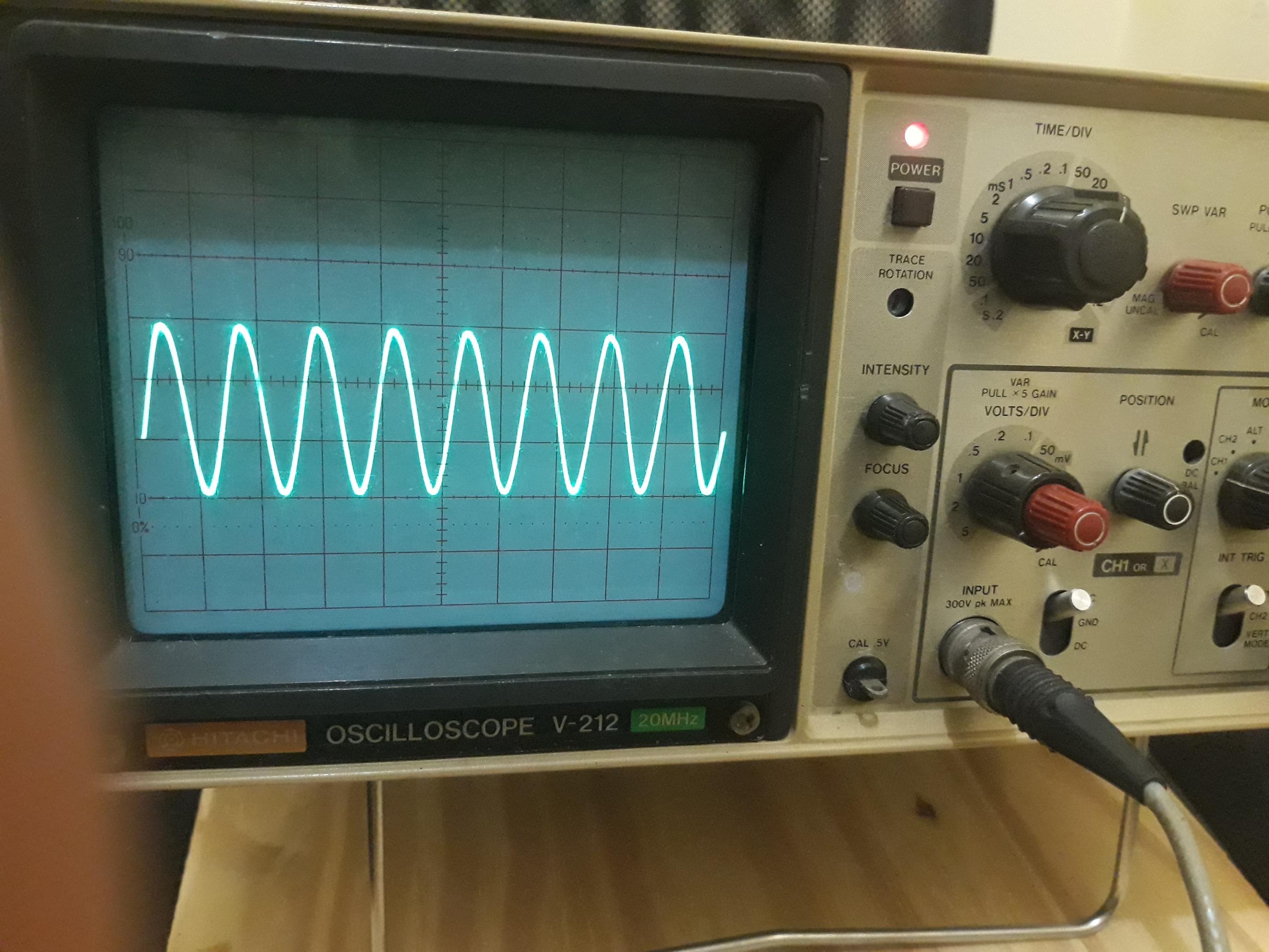

                          • Thanks, another question, what could be the reason of not having a perfect sine shape in the RX preamp output? My RX waves have always some flat bottom.
                            • some flat bottom. = incorrect bias
                                You either have too much offset in the preamp or the coil is not very well nulled.
