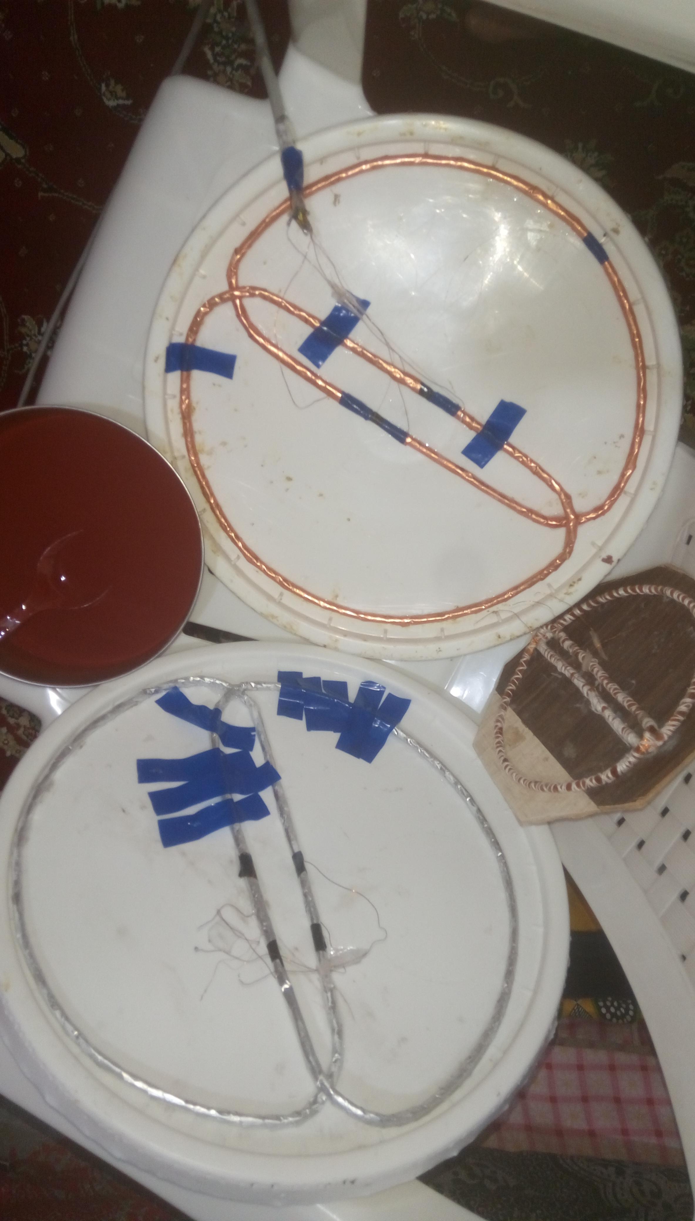

                      • RESIN TIME!!!Click image for larger version
                        • Originally posted by mostafalesnar91 View Post
                          RESIN TIME!!![ATTACH]58146[/ATTACH]
                          Can I assume you did get the coil and GB adjustments to work as expected?
                          I do recommend NOT fully encasing the straight sections of one coil. The resin can change dimensions when curing and move the coils.
                          Use clay to create a dam along one coil's straight section to allow finial adjustment. Recheck then tack into place. Recheck before final resin pour.

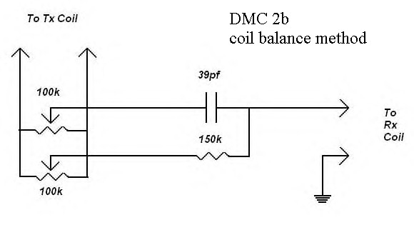

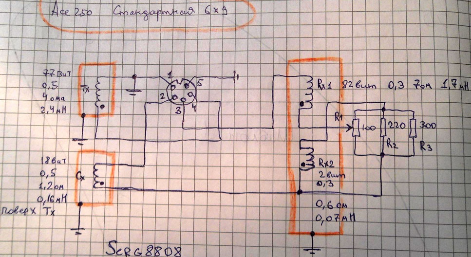

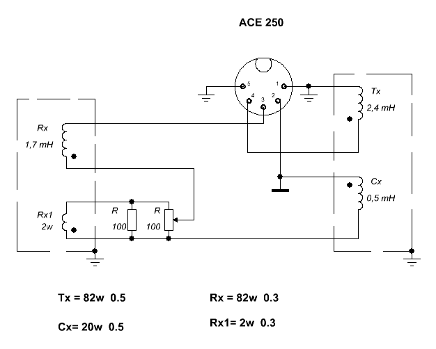

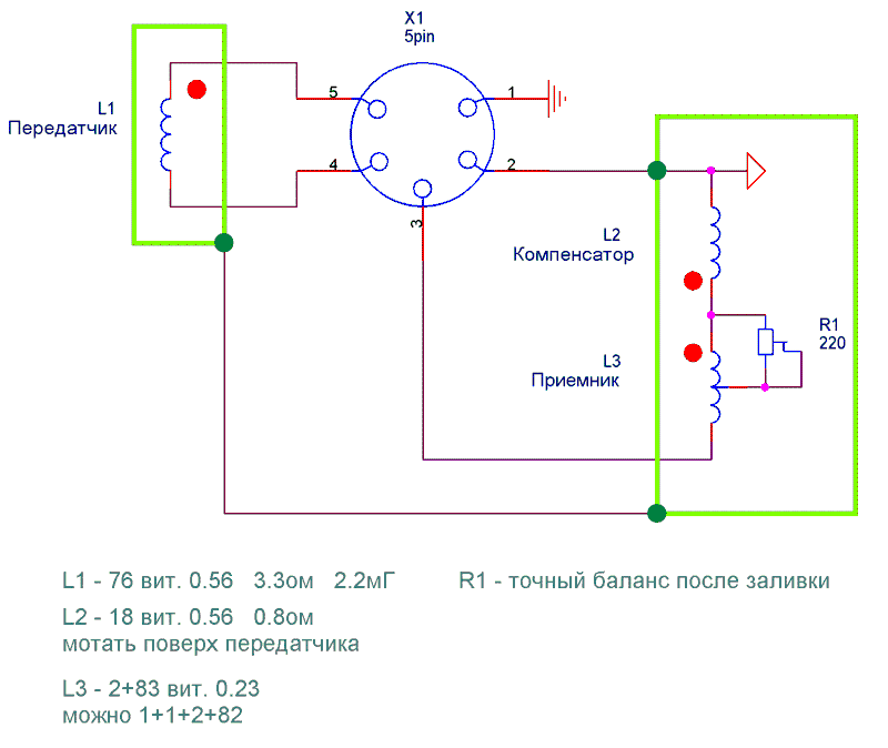

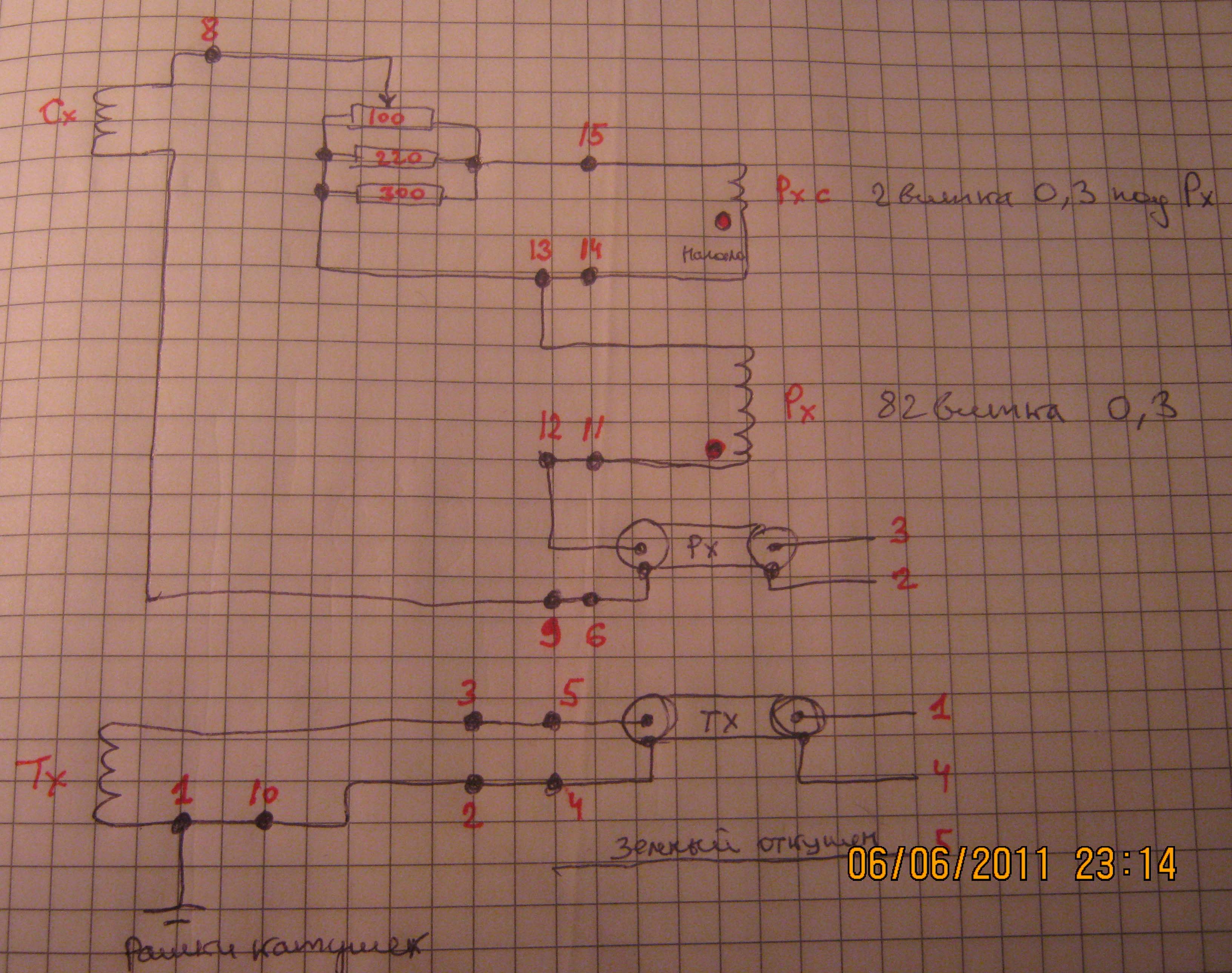

                            i do recommend Ivan Kostin sch that he used repairing garrett coil. simple and good way to tune.
                            • garrett coil sch
                              • Nautilus metal detector used this feedback method for fine balancing of coils.
                                One trimmer pot for amplitude and other trimmer pot for phase. This circuit can be wired up permanently inside the main box of the metal detector at the coil connector.
