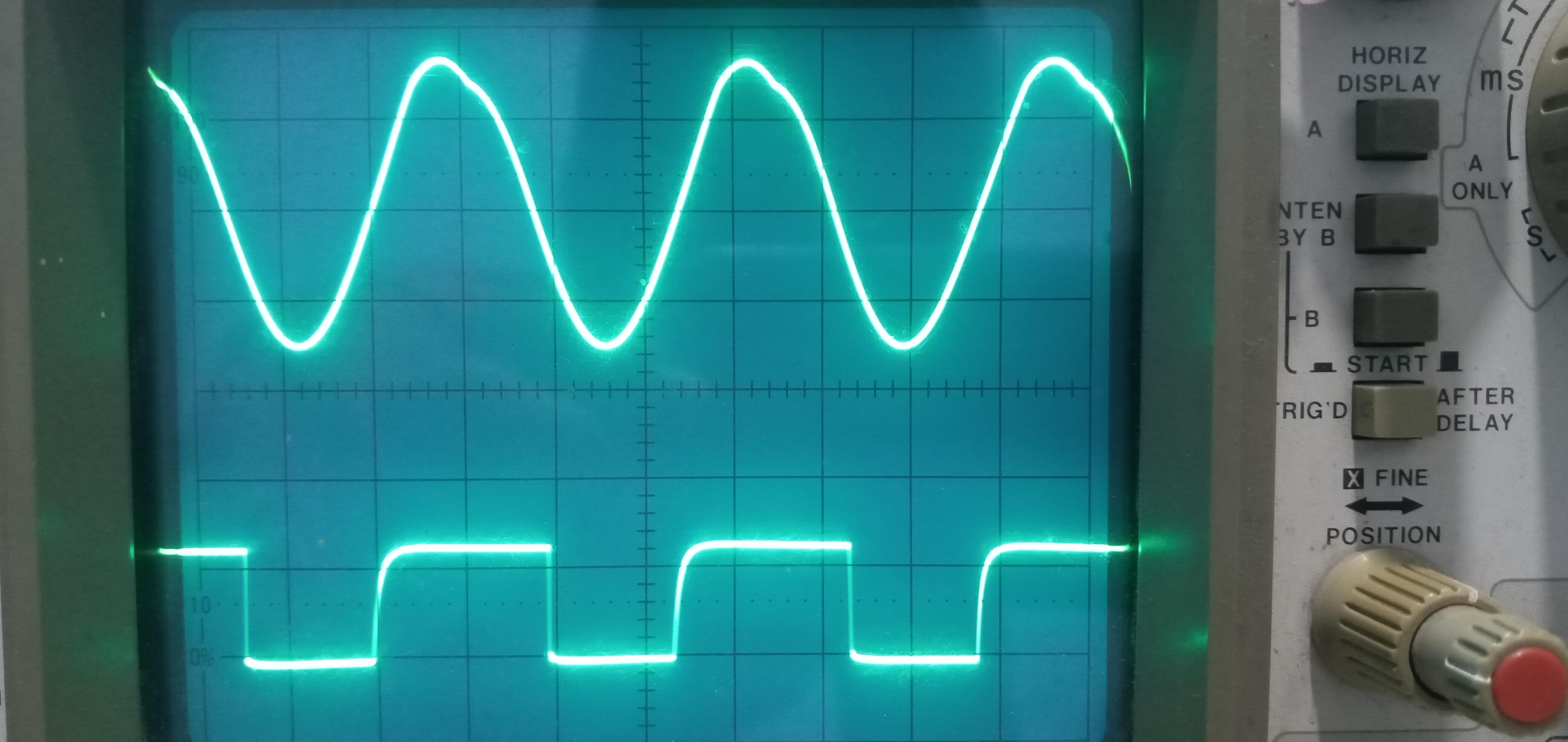

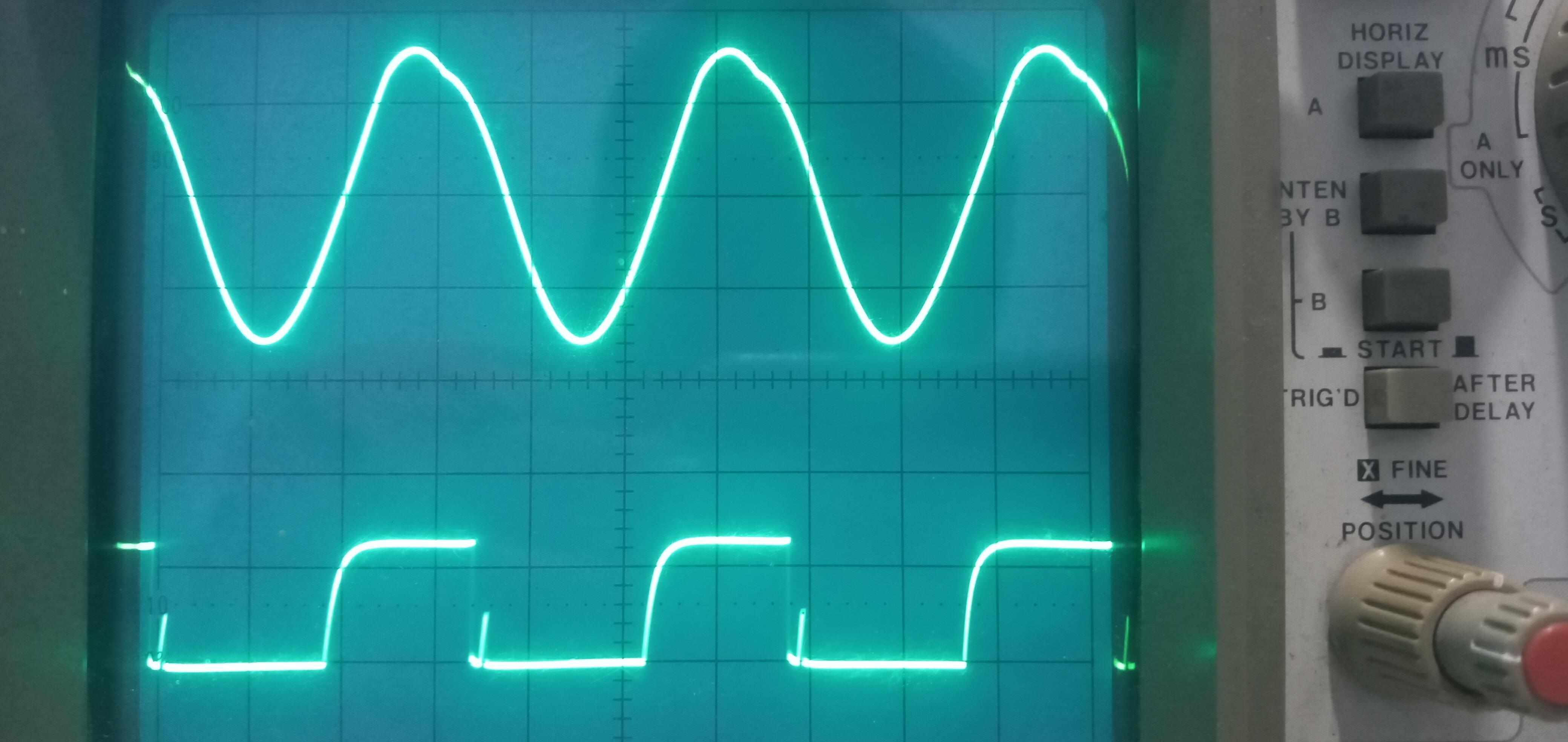

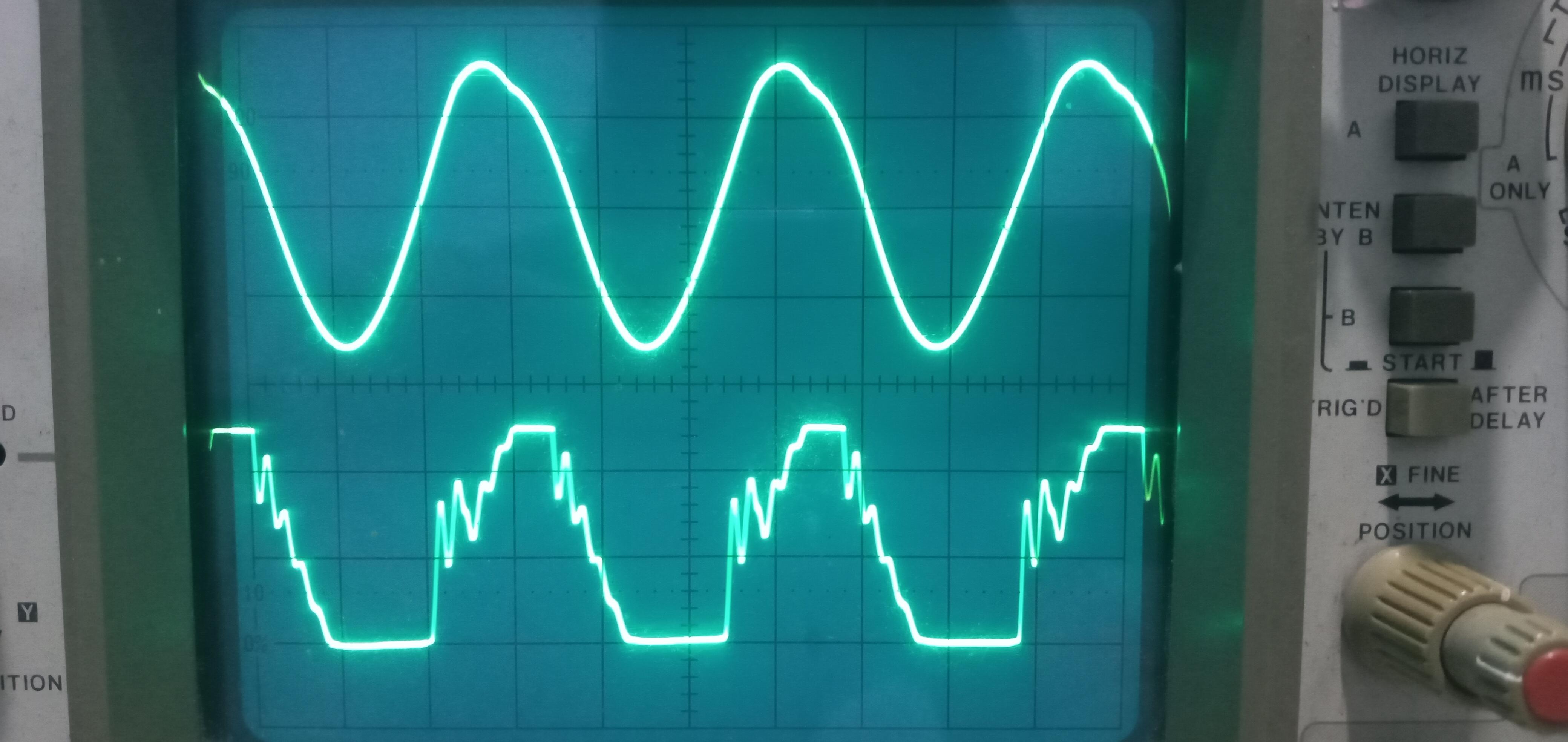

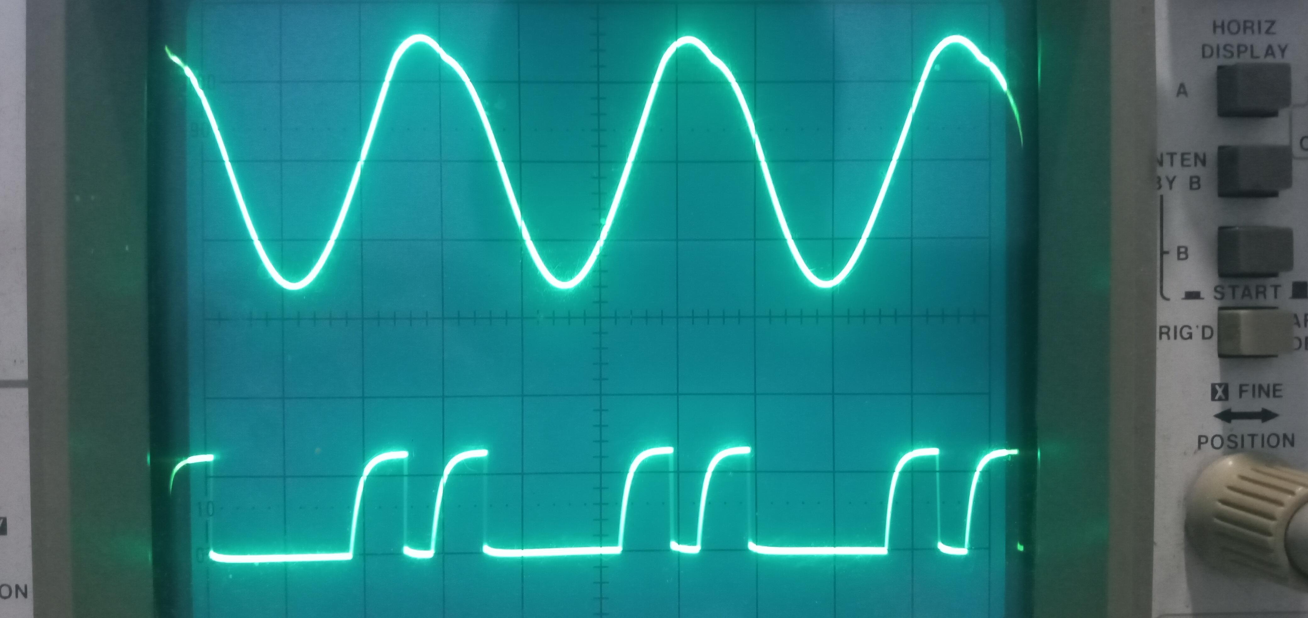

      I made the measurements with the oscilloscope at the DISC stage and I had the following measurements at 5V, 20uS on both channels.
      Test point 9 DISC set to minimum.Click image for larger version

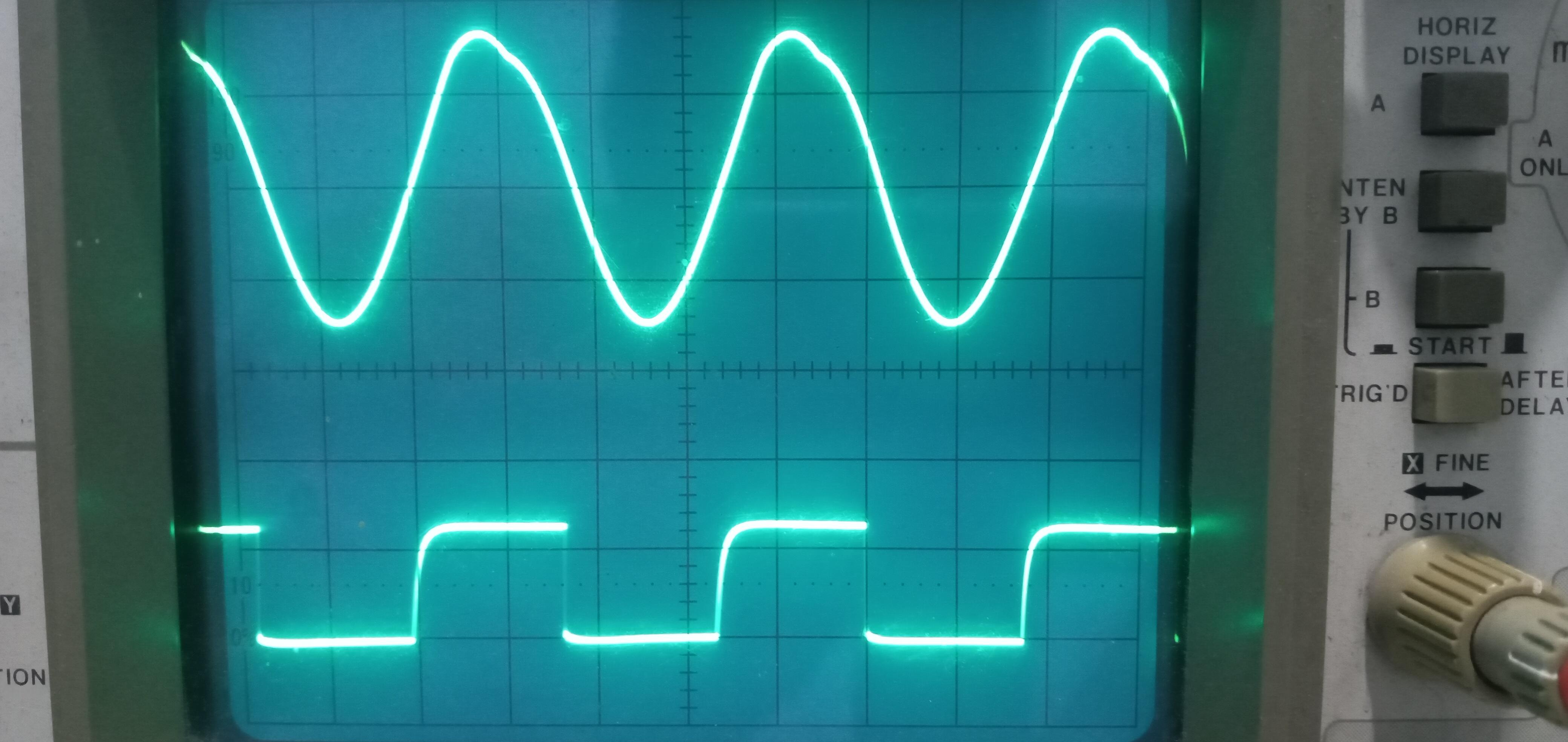

      Test point 9 DISC set to maximum.Click image for larger version

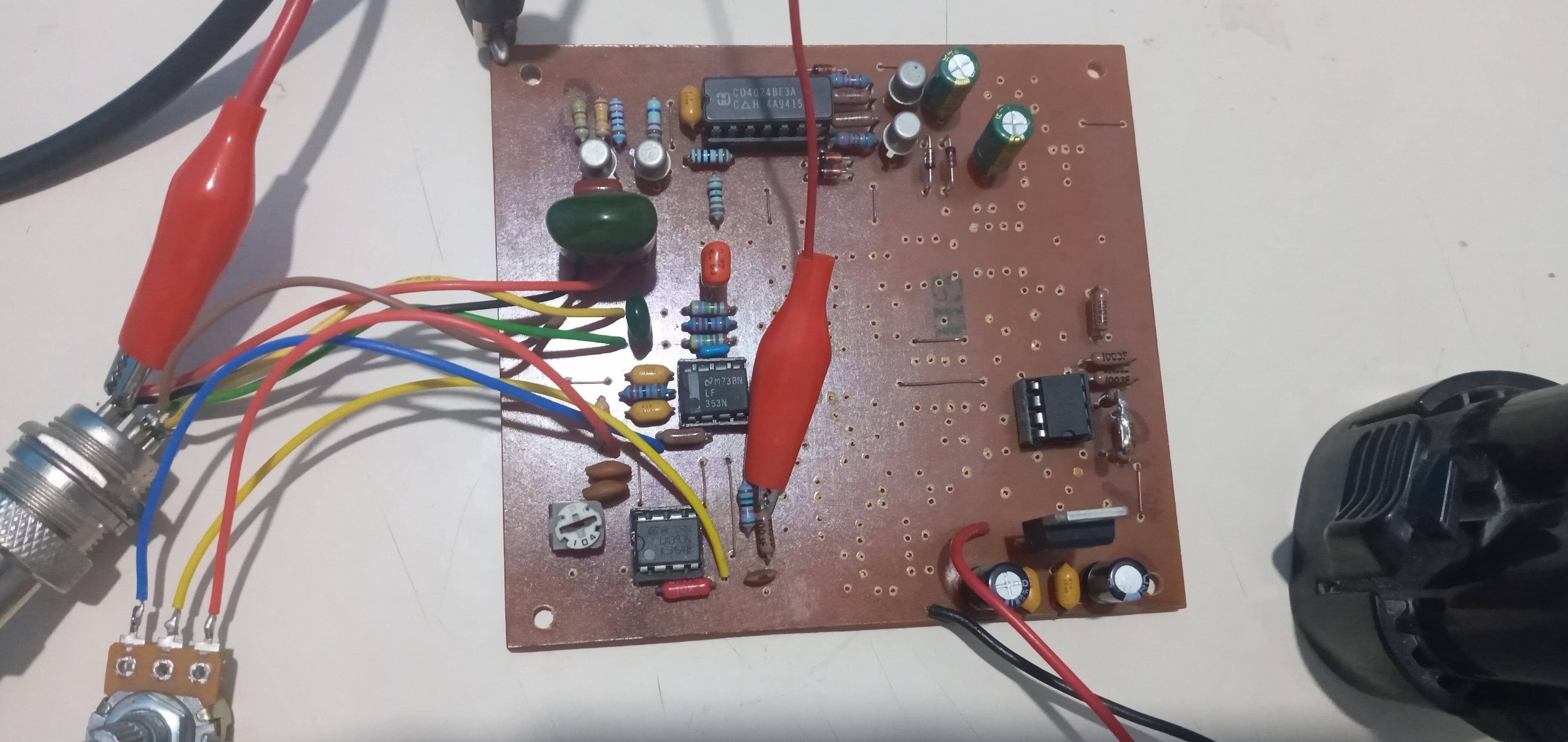

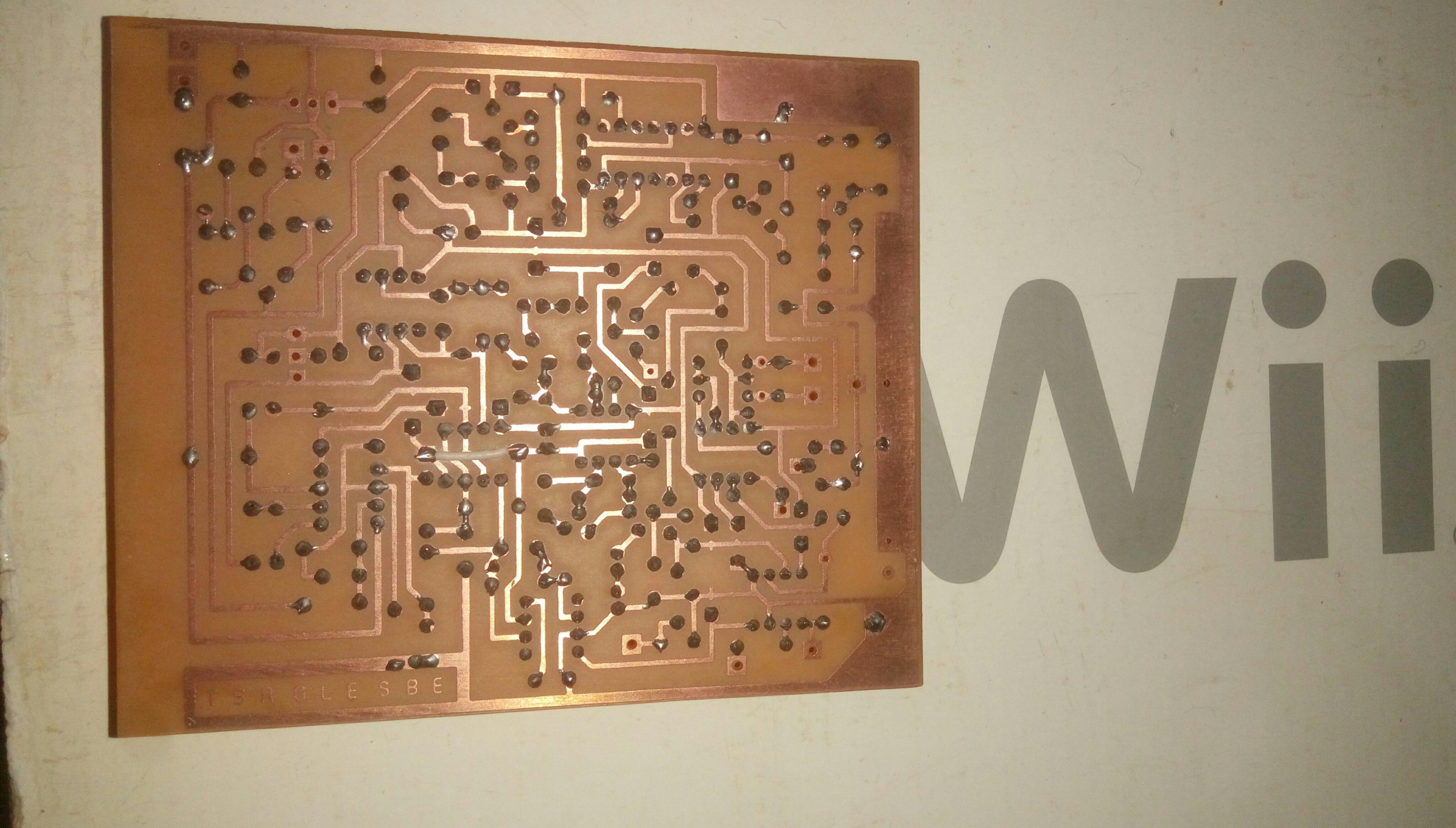

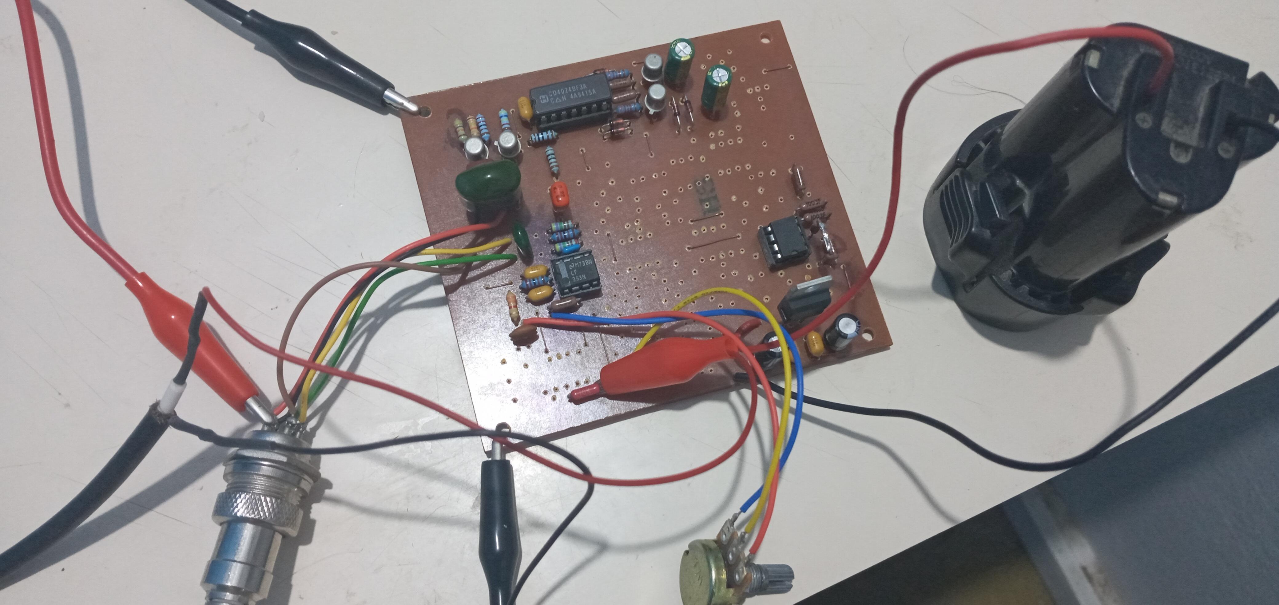

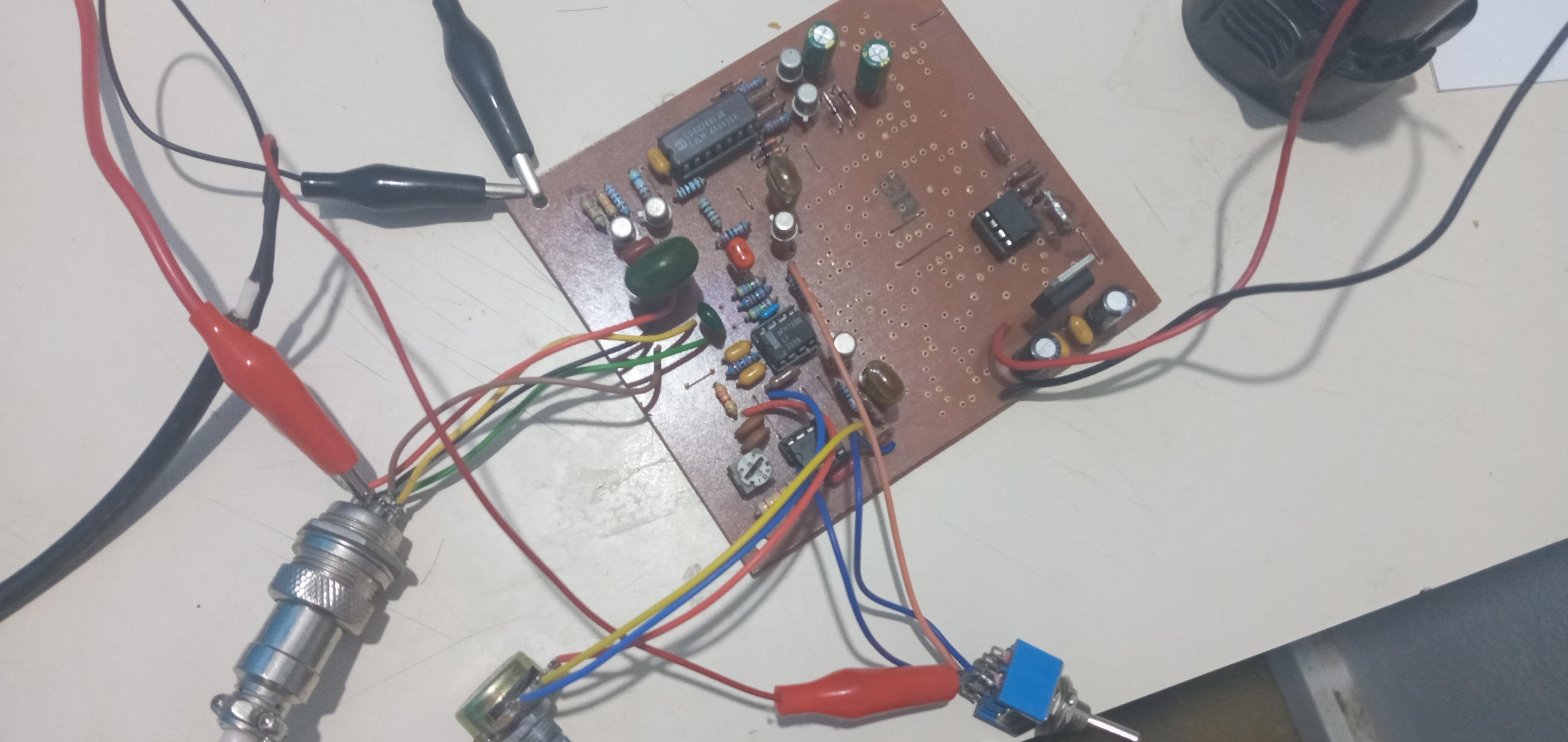

      • I hope the measurements are correct. If there is something wrong I hope you let me know so I can continue with the next stage. Here a photo of the PCB.Click image for larger version
        • Keep in mind that the scope shots are real. But somehow it works.
          Proceed with haste.

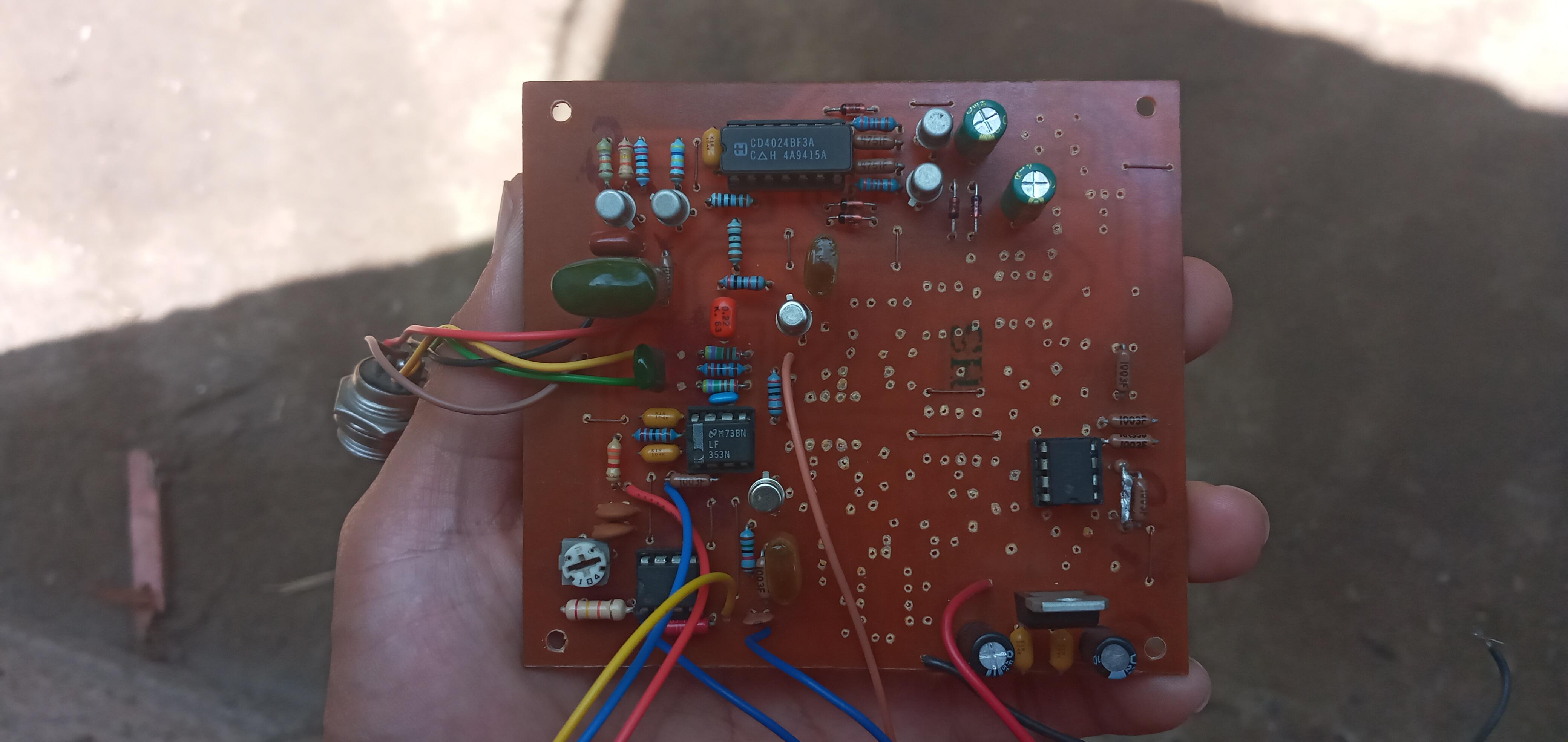

                • Hi friends!!

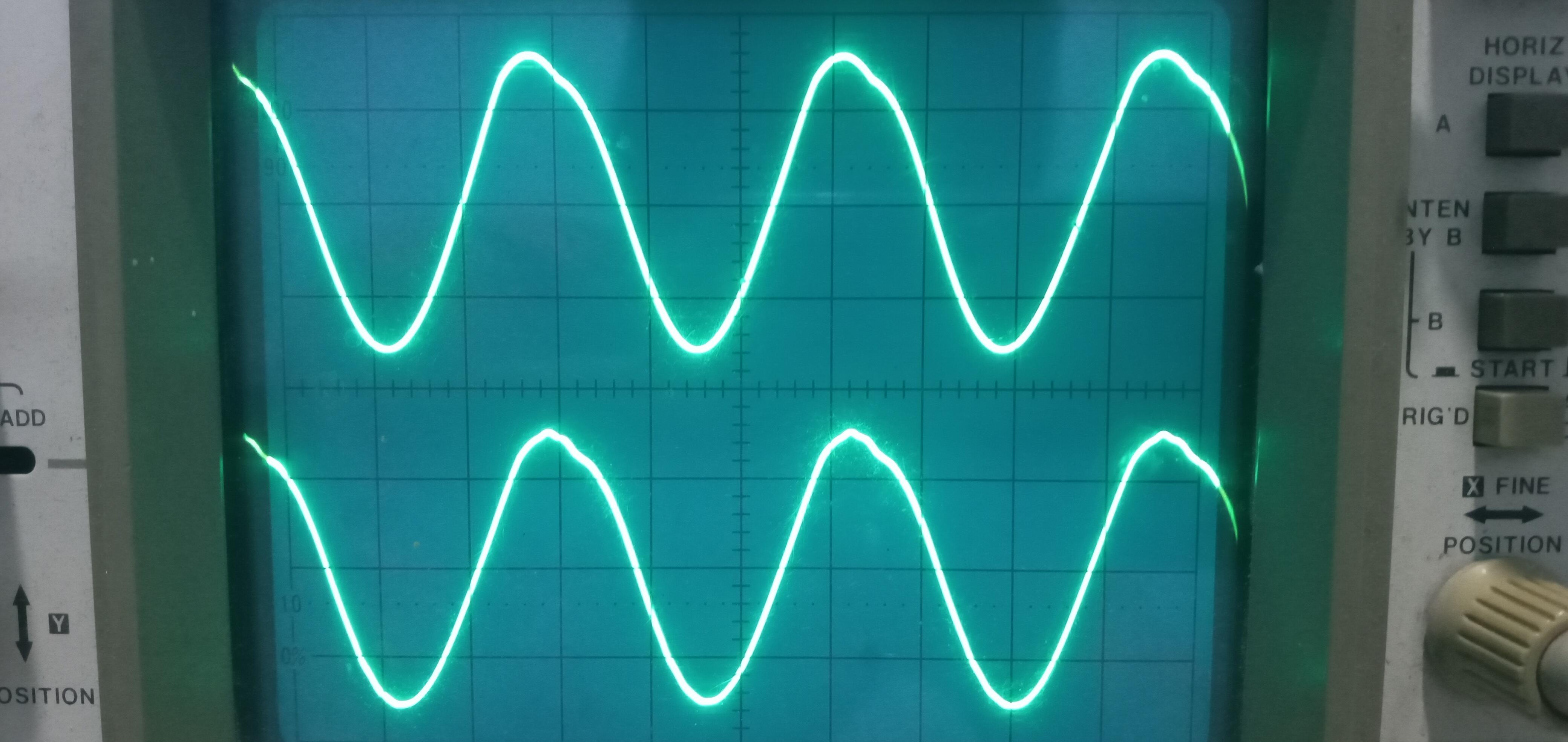

                  Here I post the measurements using the oscilloscope at the GB stage on block 10 pin 7 U102b. Measurements are made at 5V, 20uS on both channels.
                  GB potentiometer at minimum.Click image for larger version
                  GB potentiometer to the maximum.Click image for larger version
                  • Originally posted by Ruben2000 View Post
                    Hi friends!!
                    GB potentiometer at minimum.[ATTACH]57031[/ATTACH]
                    GB potentiometer to the maximum.[ATTACH]57032[/ATTACH]
                    Here a photo of the PCB.[ATTACH]57033[/ATTACH]
                    Looks good to me. Now here comes the fets.

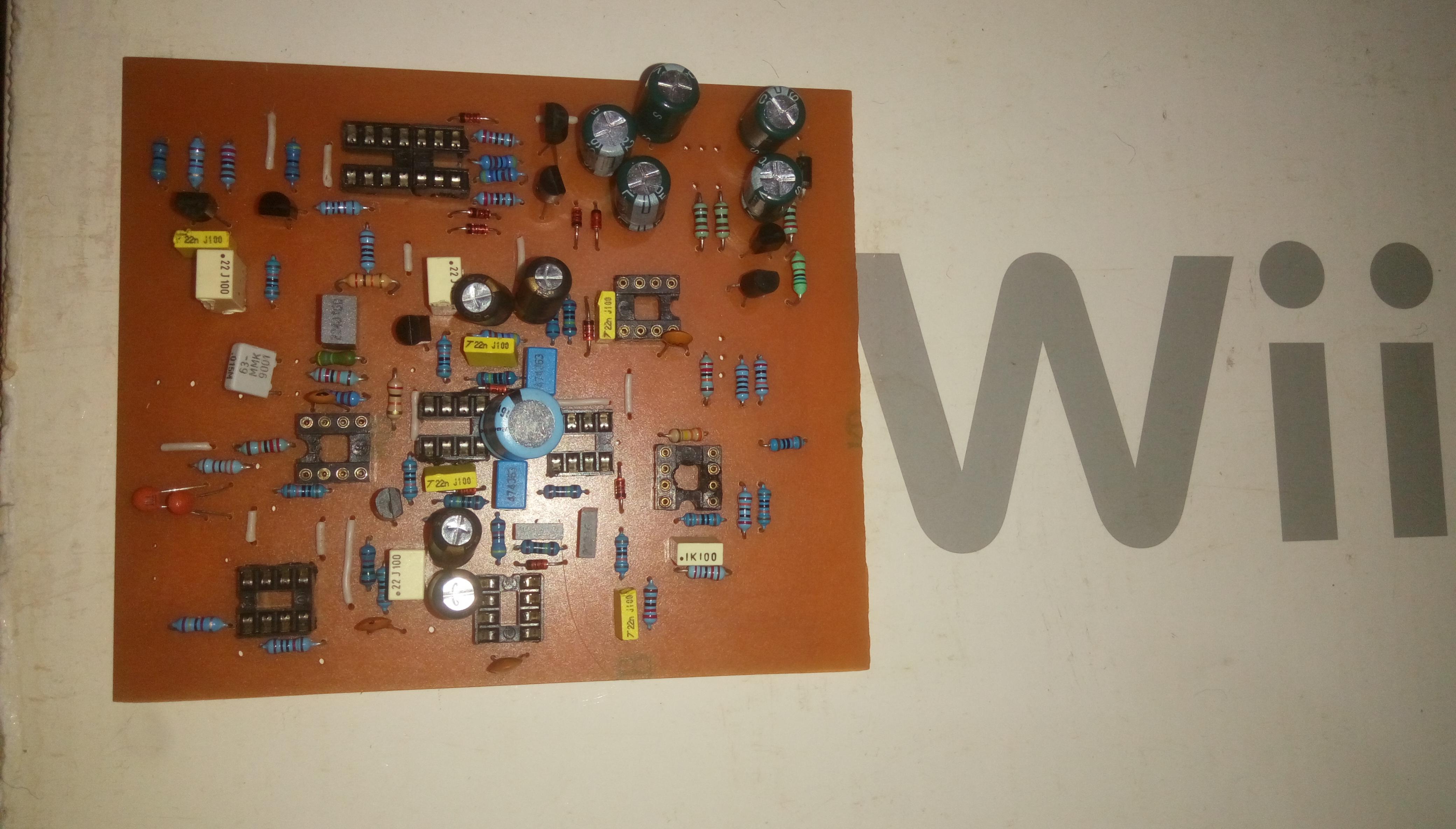

                            • Does anyone see anything wrong ??

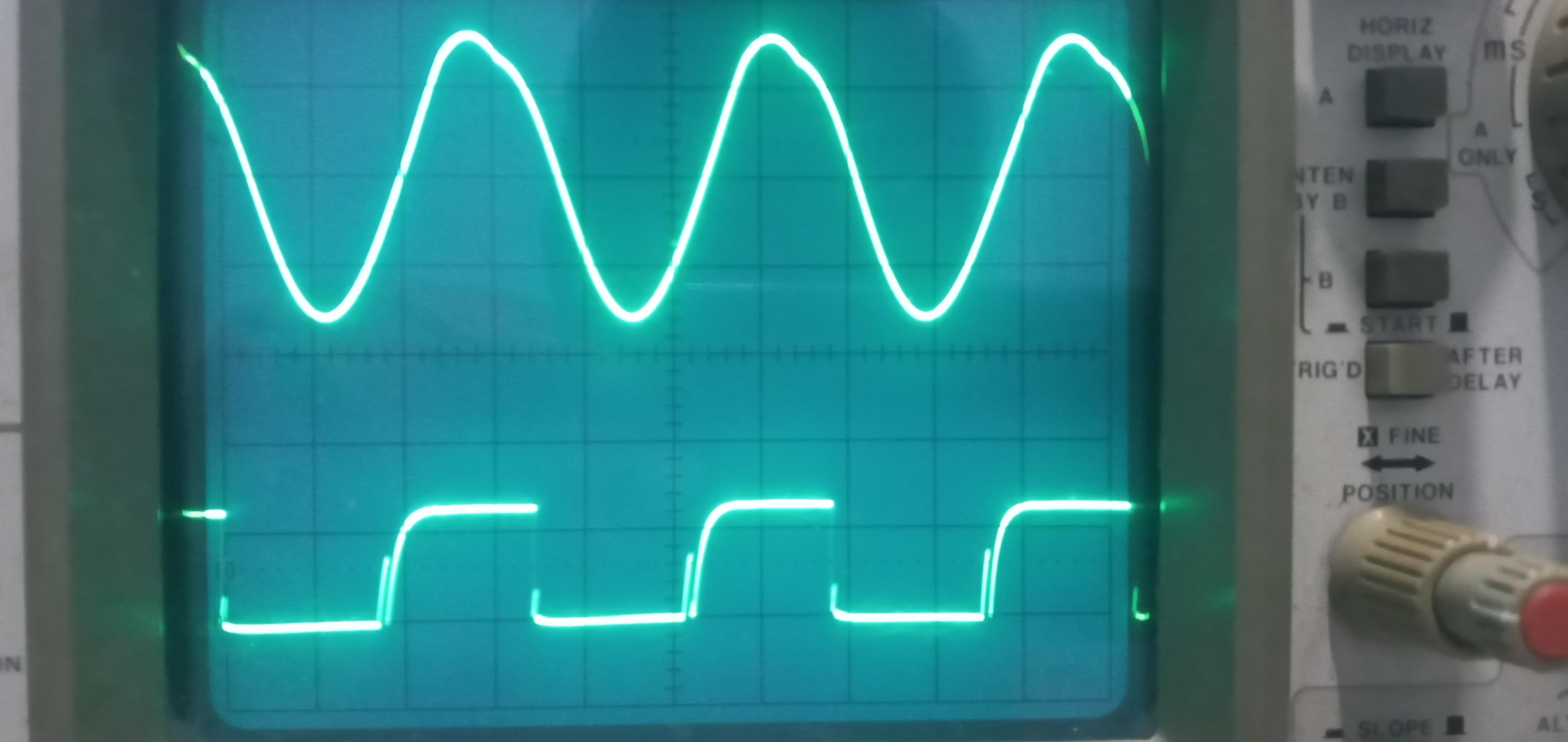

                              • Hi friends!!
                                I am in block number 5 and I was measuring with the oscilloscope in the Gate of TR4, which is the signal coming from the DISCO, the measurements were taken at 5V, 20uS.
                                Gate TR4 of the DISC set to minimum.Click image for larger version
                                Gate TR4 of the DISC placed in the middle.Click image for larger version
                                Gate TR4 of the DISC set to maximum.Click image for larger version

                                I hope all is well up to this point, any suggestions are welcome.
