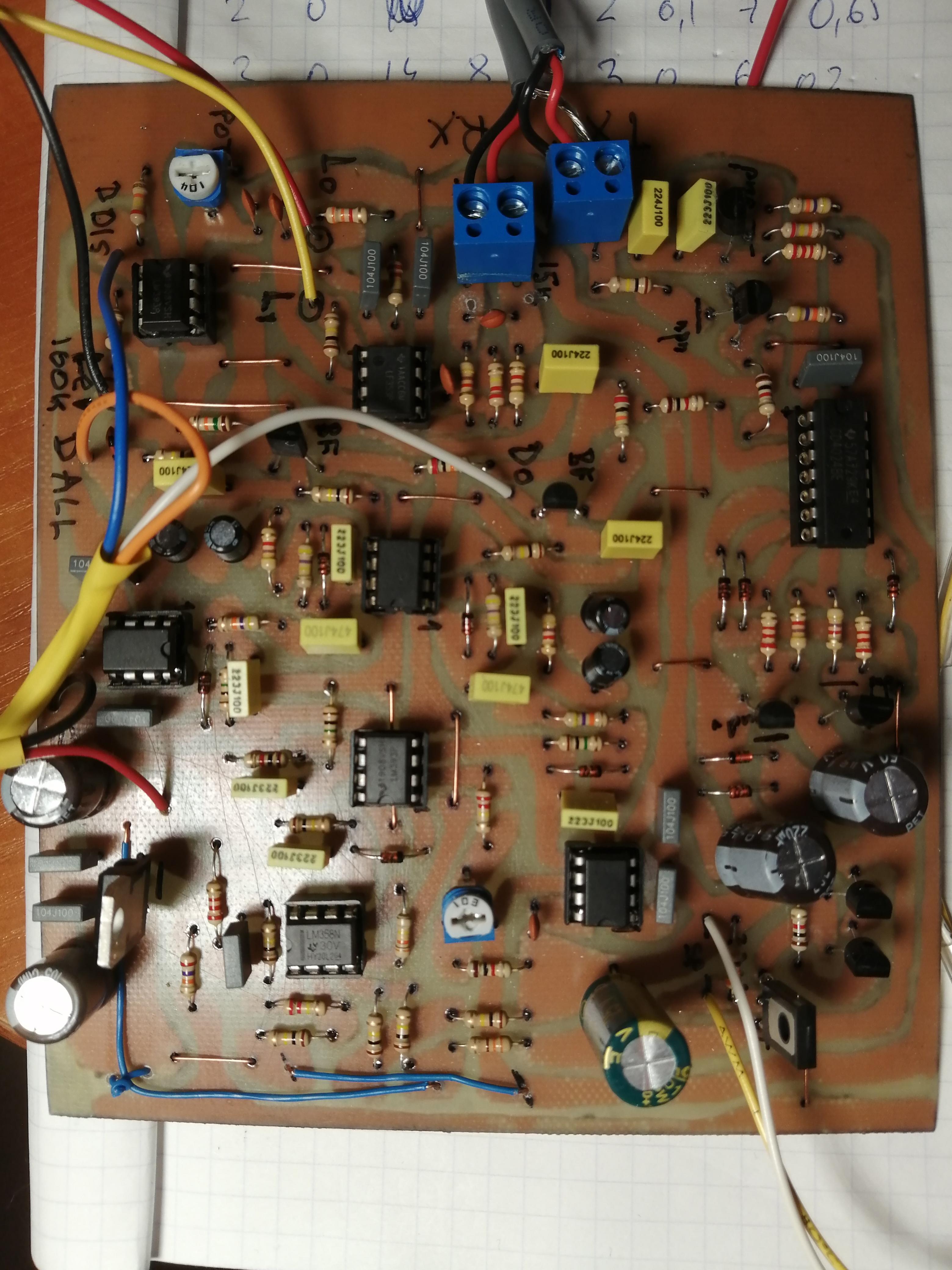

      • Hello again everyone,
        Thanks for the answers. The first thing I did was to carefully check the schematic and catalog description of 2N2907 and 2N2222. It saw, as I expected, that I have swapped CBE> EBC feet in both pairs of 2N. I have both BC547 correctly. I took out both 2N pairs and inserted them correctly. I tested the voltages and the generator / oscillator for both coils. I have a voltage of about + 8V and -7V. My coils have TX 14.2kHz and RX 13.6kHz, but when bending these values ​​change a little, which is okay. During the winding, I checked their inductances and they had the values ​​of exactly 6.0 and 6.5mH, they changed a little after binding, applying the screen and gluing. On the TX I have a voltage (AC) of 7.7V, which, as I understand it, gives an amplitude of almost 16V, which is also correct. The loudspeaker is silent, but I did not have both coils connected, only the TX. In the left IC sockets I have + 8V and -7V power supply, I assume that it is good.

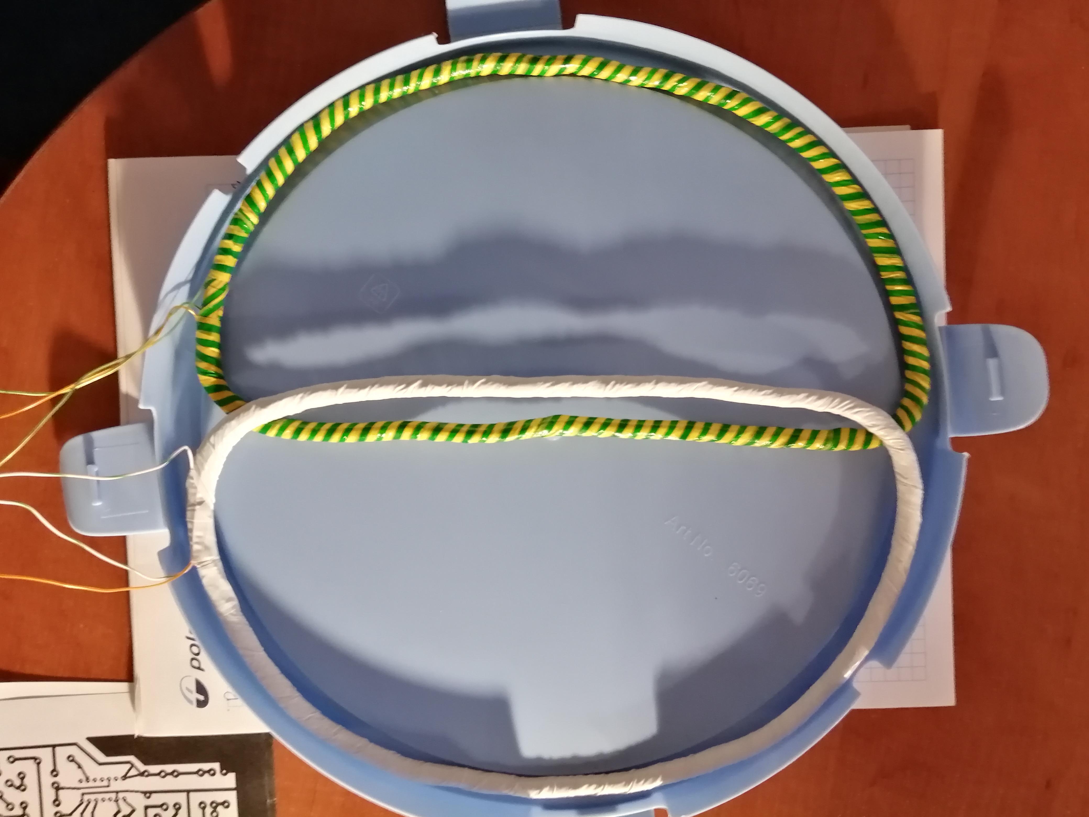

            And I did as I planned. I put all the ICs in the sockets. I connected the power and the loudspeaker. I connected the TX and RX and put both coils in makeshift form. At this stage, I was not fixing anything permanently. The coils are only lying slightly overlapping each other. I turned on the All metal mode, all 3 potentiometers at half scale. I turned on the power. I moved ferrite over the coils, a piece of steel, a piece of copper. Hear single or double beeps, copper seems to be giving a double signal. It is not very regular, the sensitivity is also not good (5-10cm), but I know this is just the beginning of the tuning and I cannot expect everything to be great at this stage. Then I moved a watch, a telephone, etc. over the coils. I can also hear signals, the sensitivity is better, but they are large objects. The coils sometimes go into some deeper resonance and the throbbing sound does not disappear when I take the items away. I can turn it off with the Diss knob, it's kind of weird. It can also be turned off by moving the coils apart.
            Then I switched to Diss mode and looked for positions where the ferrite would be rejected and the copper would not. So far I have not succeeded: it either rejects everything or nothing. But I know that the coils are only lying together, so it would be naive to expect them to work well right away.
            I understand these initial tests that the board is assembled correctly and all components are OK.
            To the island / position 7/IC101a I soldered the lead/cable for connecting the multimeter. I am going to look for the minimum AC voltage value between this point and ground now. But I think first I should bend the coils so that their inductances are closer to the values ​​of 6.0 and 6.5mH, what do you think? Once this is done I will attach the TX permanently in its semicircle to the base so that I can bend it a bit in diameter, what do you think? Then I plan to put RX on it and look for a position where the AC voltage of 7/IC101a / ground will be minimal. When it succeeds, I will have to fix the coils permanently and start tuning the potentiometers.
            Maybe you have any other suggestions?
            I must add that I wound the coils with 0.4mm wire, and their final resistance is slightly below 20 Ohm, I hope that is not a problem.

                As I wrote earlier, I bent the coils to have their inductances closer to the values of 6.0 and 6.5mH, it turned out to be equal. I didn't even have to massacre them somehow, all I needed was a simple gum rings and old, empty plastic pens. The frequencies of the coils were then about 14.3 and 14.0 kHz. A little bit of a difference, intuition tells me it should be a bit bigger. So far, I have not fixed the TX permanently because experience and intuition tell me that I will unstick it more than once. I was not wrong. I planned to apply TX and RX and look for a position where the voltage of 7/IC101a / ground would be minimal. But it didn't work. The AC voltage is almost constant 4.6 - 4.7V (1000 x higher than 5mV), with a frequency of 13.7kHz, regardless of the position of the coils. Maybe I solder something wrong after all? What could I have done wrong? Maybe you have any other suggestions? Maybe the board is not assembled correctly?

                      I did this: I picked up the RX coil and turned it over, then reassembled both DD coils. Again, I was looking for a setting in which the voltage between the indicated measurement point (pin 7 IC101 / ground) would be minimal. Unfortunately, nothing changes, I still have 4.6 - 4.7V AC. I'm beginning to suspect that the problem is on the PCB after all, but what could it be? I checked all the elements and connections 3 times, I have no idea. Maybe someone else has an idea?

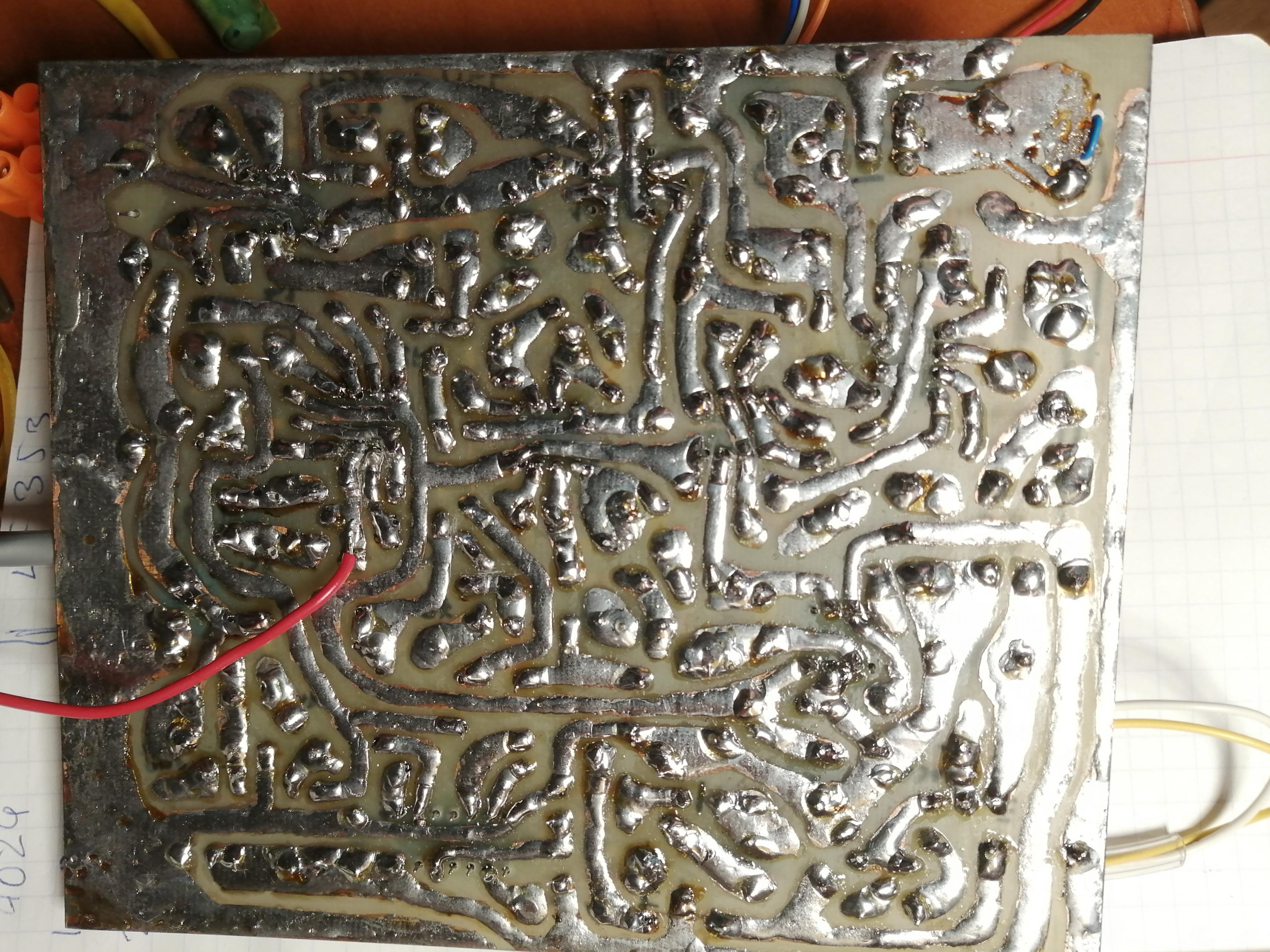

                      • I try to add photos of my work:
Name:	TGSL Elements 2 .jpg
                        It's working So, now the rest:
Name:	TGSL PCB Soldering.jpg
Name:	TGSL Coils.jpg
                        • Disconnect the TX coil and measure IC101-7, see if the problem goes away. If it does, you have an imbalanced coil. If it does not, you have a different problem.

                            • In addition to Carl's and Dbanner's suggestions.
                              Coil null only happens within a very small physical range. So move one coil very, very little at a time to look for the null. The null will happen only within a few millimeters and best null within a fraction of a millimeter.
                              First time trying to null the coils is very hard but will be easier once you know how.
                              • I balanced my the coil with ordinary multimeter. I didn't care about the reading the meter was putting out, I new it would be bandwidth limited. What l looked to see was the dip in voltage as l moved across the null. I just aimed for the lowest reading. So I knew that this was closest to where I needed to be. Then I began adjusting the gb trim for ferrite reject ( just on the edge of where ferrite is barely clicking). Then I wave various coins and metals to check discrimination range. All this time I am ever so slightly adjusting coil, gb trimmer and so on. Repeating until it is best.
                                Keep in mind that the tx frequency should be nailed down at 14.5khz( or was it 14.9khz, I don't quite recall)
                                Don't bend or deform the coils( you should glue in the tx coil so it can't move. Shift the entire RX coil left or right across the tx coil.
                                Don't bend or deform coil. When everything is to satisfaction, glue in place. The RX coil should be tuned to resonance at 16.1khz( if I can remember) this is important so phases and gb trimmer can be adjusted properly.
                                That's how I did it. No oscilloscope. I think I kept the meter connected while shifting around to get a feel for where I was in relation to the null point.
                                The trick is that so long as you can eliminate ferrite within the range of the gb trimmer while getting proper discrimination and good distance, then you can be assured that you've got close to the 21degrees phase balance required for the tgsl search coil since this performance could not be achieved otherwise. It is deductive logic.
