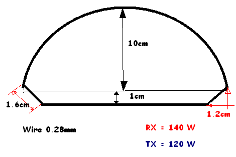

    what dia meter
    and how many round you winding the coil
    Tx = ?
    Rx = ?
    i want make it
    10"<< Diameter Right

      Same as in the "TGSL complete details" thread.

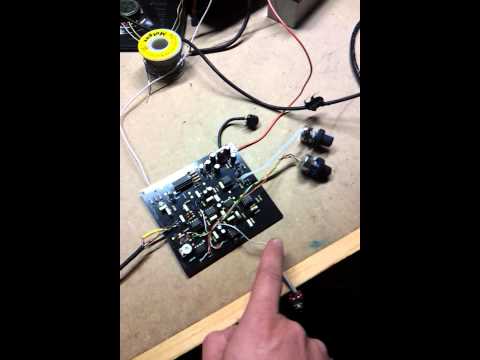

        • i got this problem why
          i get problem like this how to fix this
          • and i need ask what is function of disk switch ?
            • Paku, i have the same problem.
              • that is the problem
                or that is normal TGSL Edu
                • Paku, I have build TGSL made by Ivconic (ver.3).
                  • that is work or not
                    cos i have make to but not work
                    so i buy tgsl edu kit
                    but got that problem
                    • Hi, Paku and Constantin, you should search a little more in the forum.
                      the answer is just 2 pages ago:
                      Hi
                      All you need to do now is install the electronics into a metal housing make sure there is good bonding from earth to coil plug and pots and all should work well.
                      as explained here, install everything in a housing (ideally metal one), be sure to avoid the contact between the circuit board and the housing.
                      Connect the metal housing of the switches and potentiometers to the ground and you will be fine.

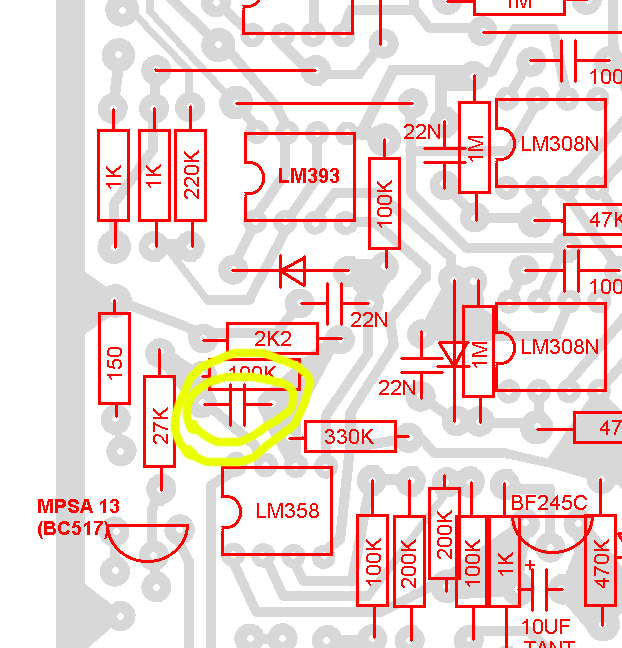

                                Hello, tell me what capacity this capacitor?
                                There is a good option PCB for this device?
