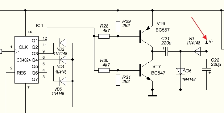

    • hello, I'm new to this forum and sorry for my bad english. When I checked the schematic file, there is a regulator for -8V, but I couldn't see a regulator for -5V. In which part is -5V generated? . I plan to make the pcb design simpler.
      • Right here. Only with connected TX

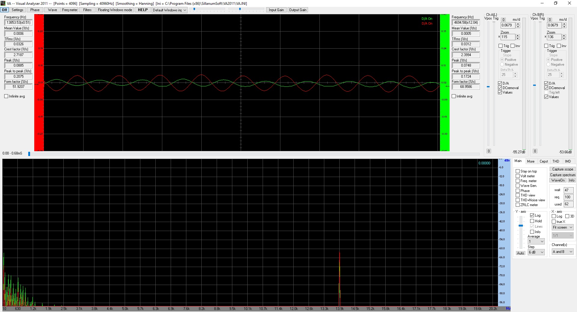

          4. I have tried to use the VA program as suggested by dbanner. For the working system, I received the image as in the attachment. Looking at the oscillogram, I tried to nulate the coils manually, but failed to get the result in which one pass would be flat (I think that's what neulling is about). Still, I don't know how to get a 21 degree offset. Does it depend on the components on the PCB or only on the physical parameters of the coils? There is always some amplitude. When it is low, the sensitivity probably increases, is it good? As Waltr and dbanner write, it requires a really skilled hand. However, I suspect that maybe my coils are wrong? Or maybe something is wrong on the PCB?

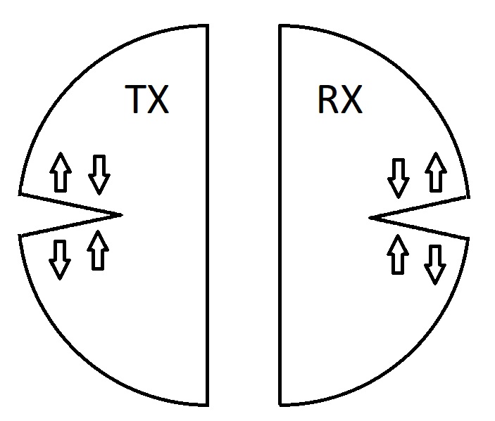

          5. If my coils are badly wound, I will probably have to rewind them. I figured it might be easier to adjust the inductance of the coils by bending them at a more convenient point, but that would require a different winding system, e.g. something like the picture (second attachment). What do you think about it?

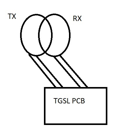

            And another idea came to my mind: at the time when I was winding and connecting these coils, I only had a shielded two-wire cable, i.e. 2 wires covered with an independent shield. So I connected these 2 cables with screens in parallel, thinking that it would be the same as one 4-wire cable in shield. The shields connect at the beginning and end of the cable, the RX wires are separated, one of TX wires connects to the shield, as in the second Don Bowers drawing. Or should I use a regular USB cable after all? It has 4 wires in the fifth screen, maybe it will be better? And maybe at the nulling stage I should connect them like in the top, first picture of the Don Bowers documentation? I think I need a USB cable. How do you think I should do that?
            I greet everyone.
            • I used a USB cable. It worked very good.

                • So there's no need to go bending around your coils to tweak inductance.
                  Fix the tx in place and tune with capacitors. The lock it down so it can't move and forget about it.

                  • By the looks of your VA picture, looks like the RX waveform is inverted, maybe you should flip the wires to Rx coil?
