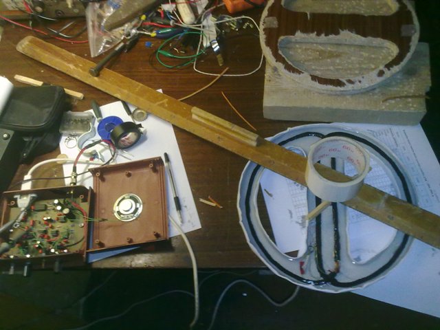

                    • My big day!
                      My vacuumforming failed (too small oven, too thick plastic, too weak vacuum ), so I just bent it vith my hands and hot air gun.
                      while epoxy cures, it unbalances a coil a bit so while it is still liquid, I put some weight on windings to balance it back. its hot!!
                      • What did you use for an oven? I have a pizza oven but am waiting until I can pick up a heat gun before trying it out.

                        • Originally posted by habitbraker View Post

                          • Jerry - Im using ordinary kichen oven with electric heating. My shell form barely fits in the oven so that I couldnt afford to make proper frame form my plastic, just about 1cm wide. Because of that, when it plastic heats up, it just drops of the frame. If not in oven, then when I sqeeze it on the wooden form it will
                            Dfbowers - You actually was my inspiration source. I messed up 2 sheets already.
                            What thichness have yours? Mines are 1.5mm.
                            I could heat it so hot it could vacuum form, BUT.. - see aswer for Jerry.
                            well it didnt melt the plastic, but surely shifted null a lot! I was readjusted the null every 10 minutes while it was still liquid.
                            After all my null (at LF output) is very small in A (about 200mV) , but phase from -20deg sifted to about +100deg (!!!). (relative to TX)
                            Despite this I can reject ferrite at middle of GB pot, discrimination is nice, and my air distance for 2cm coin is about 30cm. (really no big difference if phase is not those 20deg..) Lost about 3cm because of epoxy.

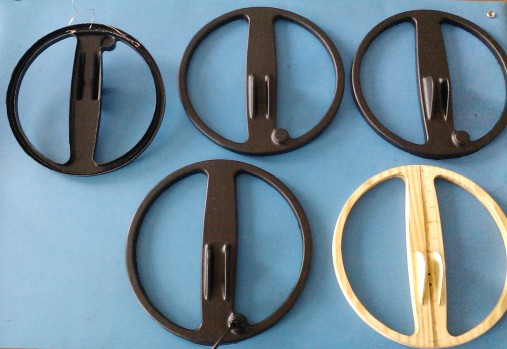

                                A good frame to support your plastic sheets surely makes things easier. I have been getting my sheets from "widgetworks" http://www.widgetworksunlimited.com/...-black-060.htm
                                I have found that the correct time/temp combination is 400 degrees for 2 minutes, and that is starting with a preheated oven. I just use an ordinary shop vac. but, I typically have to "work" the plastic into sharp corners and between the ears with some sort of tool while still soft. Generally they come out very good.
                                Now, to keep this relavent to the TGSL thread, here is my latest 20cm coil.. 31 cm for a Euro using Eduardo's new PCB. My standard 255mm coils get a euro at 36cm but that advantage is drastically reduced in the ground. Detection depths are about the same for both in the ground..
                                Top pic is my standard 255mm coils, bottom pic is my latest 200mm coil..
                                This one has epoxy filled ears, 2 part marine foam in the middle and a layer of potting epoxy on the bottom. Very light and rigid!
