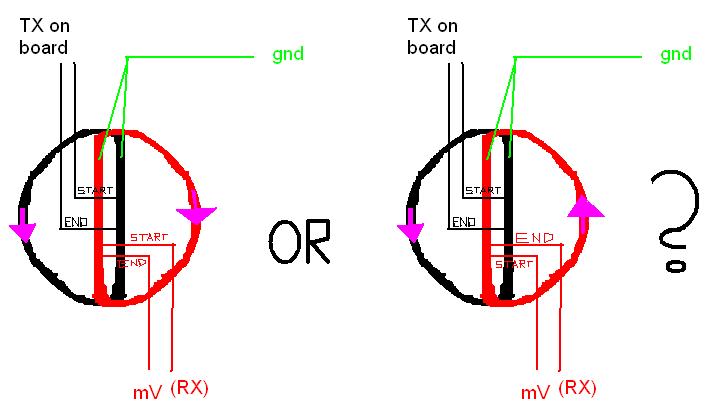

              • problem
                hi everybody
                which kind of coil should i use to test coil? the left one with difrent coil winding direction(pink arrows) or right one with same winding direction?
                both coils are shellded and taped
                best regards

                  • Originally posted by lunamay View Post
                    hi everybody
                    best regards
                    You will find the answer to your question by monitoring the output of the pre-amp, relative to the TX signal, using a 2-channel oscilloscope. If the RX phase-shift is 20 degrees, the RX coil is the correct way round. If it's 200 degrees, then swap over the two connections.

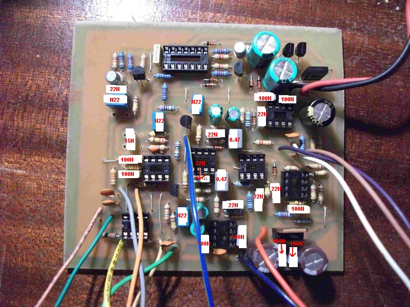

                      • Hello again.
                        Tgsl built discriminate well but detects shallow. I built three coils around and DD with the measures outlined tgsl but caught very little.
                        Can someone check if polyester capacitors are bad?
                        Also I have another question. N22 is the same 220N?
                        Greetings
                        • Originally posted by Virdi_248 View Post
                          Greetings
                          N22 means 0.22nF=220pF
                            Hello again.
                            ... Can someone check if polyester capacitors are bad?
                            Greetings
                            Hi @Verdi_248,
                            N22 is NOT the same as 220N!
                            Capacitor Coding's:
                            http://www.mikroe.com/old/books/keu/02.htm
                            If the mark on the capacitor is 120 the value is 120pF, 1n2 stands for 1.2nF, n22 stands for 0.22nF, while .1µ (or .1u) stands for 0.1µF.
                            Your Capacitors are wrong !!!
                            If a n22 Capacitor belonging to the same series as the 220nF capacitor, has about the same size, then the the voltage of this n22 capacitor should be far higher than the 220nf capacitor (verification check).
                            You can also build an audible test oscillator with a 555 chip and a 220N capacitor, and then swap it with a n22 capacitor. The frequency should then be 1000 higher, and inaudible to the ear.
                            Strange, I replied at about the same moment as @mikebg, and yet there is 19 Minutes time shift.
                            Robert
                            • Hello Virdi,
                              Both , Mike and Robert are giving good info, but on the pcb where is standing N22 you need to place cap's from 220nF.
                              Regards.
                              Ap
                              (ps robert het is hier nu 8.35)
                              • I'm buying the correct capacitors.
                                Thank you very much everybody. Then I will comment if it worked the change of capacitors.
