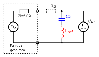

                            • Coil values not right ...
                              I only got low distances with not so good nulled coil so far. Doubt in coil remains in your case too.
                              What about ferrite? Take 10cm long ferrite rod and check if it is fully rejected up to 5cm away from coil surface.. Than check with some small and thin silver coin is it accepted at the same adjustments when ferrite rod is rejected... Inform us here.
                              Cheers
                              I'm not going to say, "told you so".
                              Looking at the values for your coils and the tuning caps used, I have calculated your TX frequency to be 14.5KHz, which you have confirmed is correct. However, your RX circuit is tuned to 19.7KHz, which in my opinion is too high, as Tesoro circuits are usually off resonance by around 9%. In this case you should be using a calculated capacitor value of 15.5nF to tune the RX to 15.8KHz. I would suggest trying a 15nF cap instead of the 10nF and see if there is any improvement.
                              I wrote " 15n // 4n7 for Tx " but it had to be 22n // 4n7
                              > when I calculate this with the frequency 14.5 KHz I get 4.51mH for the TX coil ....
                              I should have been more suspicious when I removed all the dust and spider webs from that MultiMeter .
                              Anyway the values given by the MultiMeter are way too high .
                              This explains hopefully a lot .

                              I went to electronicshop and measured the coils there with LC meter the values to be sure ... much lower values
                              I try to calibrate the inductance part of the meter and to make sure everything is correct I will measure the inductance with frequency generator and cap again for oscillationfrequency .
                              I'll be back ...
