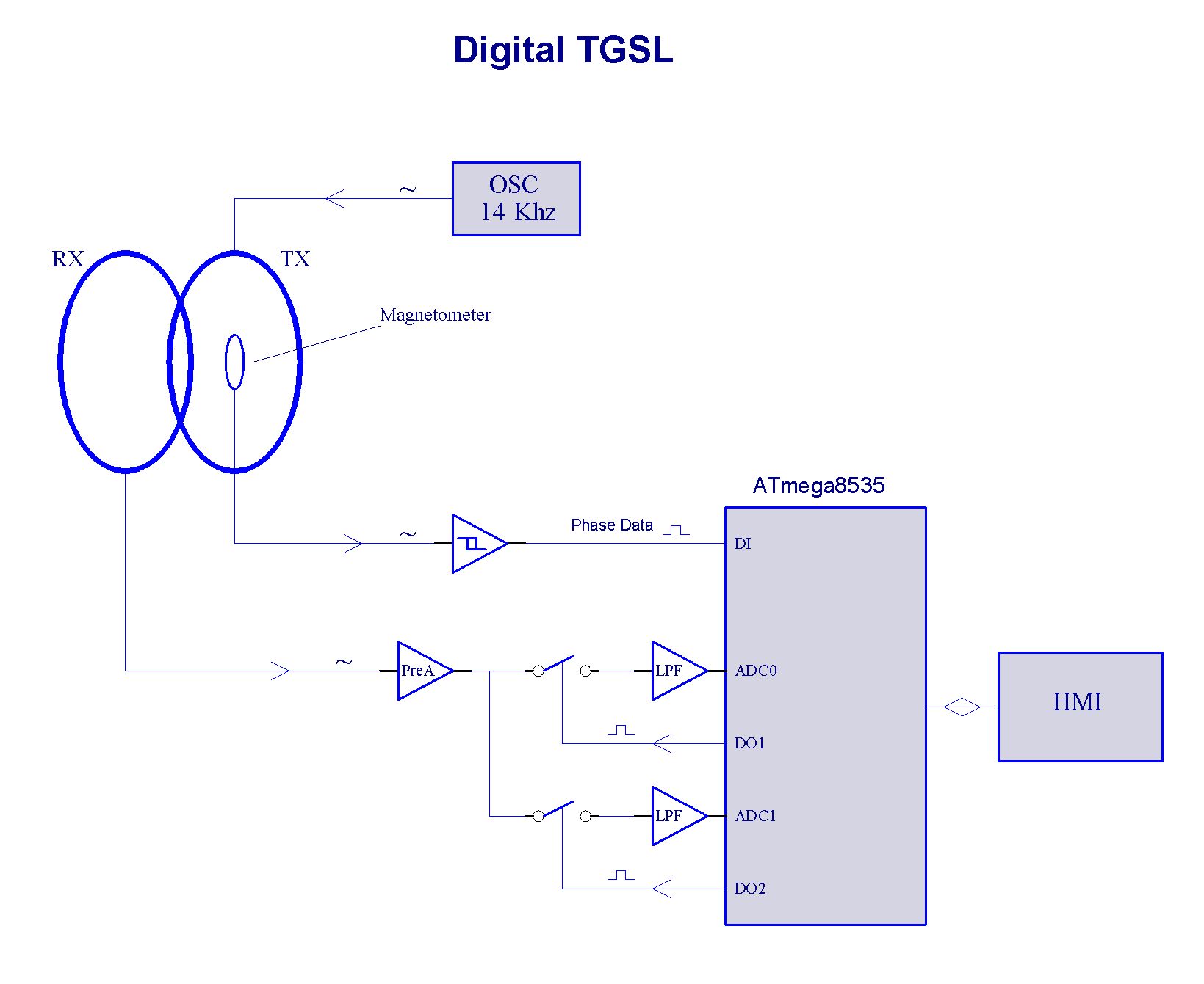

              Ex me for my delay(I have to make circuits for living and MD is my research).
              You said: we must have 2 demodulator simultaneously. one for detecting phase change and other for amplitude change. And an or logic for detecting a target.
              Is it true?
              If true i say: micro can make precisely 2 squre wave needed for 2 demodulator and 2 low pass filter can make smooth dc voltage. next two 10bit ADC of AVR will sample dc voltages and micro can compare it with presaved numbers. any change in any channel means metal vicinity. Then micro can change phase clocks for discrimination purpose.
              You see, we may have smaller circuit with more flexibility. Instead of potentiometers we have keyboard. Also auto GEB is a short procedure in our program. we can change many parameters by 4 keys + a basic LCD + menus.
              I wait your answer
              Kind regards

                it's like in digital VLFs: usually the phase of sampling gates is controlledby the MCU , often another MCU or the same do also the reading of values after adc stuff and make other computations, like for VID stuff, related to "phase" of targets.
                If you try to generate the phase for sampling using the MCU you'll sure have easy work... just need to sync using an interrupt driven routine and use internal timer(s) to generate an opportune delay(s).
                The adc reading, instead, seems much harder work if you'll use just simple sampling strategy... require hi-priced device to do so, the internal adc will fail on that if there aren't analog blocks before it, e.g. like just after sampling gates.
                You could use another strategy: numerical integration.
                Look for Robert Hoolko's project , it's a thread inside this forum: he made something similar and works, but then abandoned the project.

                    Hi Max
                    I don't want to do sampling on sine wave, although that is better but the ADC become expensive and busy the micro.
                    • Simple Block Diagram
                      Let me show a block diagram:
                      • Originally posted by wild_desert View Post
                        what's that magnetometer there ?
                        You just need RX coil to read out "phase" of targets...
                        The rest seems ok, but you'll get just 1024 discrete levels you can use for further operations at both channels.
                        Kind regards,
                        Max

                          • Don't worry Ivconic, I like TGSL topics and want to be here
                            But Max and Ivconic
                            The 1024 discrete levels is better than offset errors of LM393. Is not true?
                            Now "magnetometer". I guess the wire path of OSC to Coil and ground effect on magnetic field can make some phase error. if we have magnetic field directly, we can overcome this errors. Is not true?

                                I think you are going to completely saturate you magnetometer with such strong fields so close.
