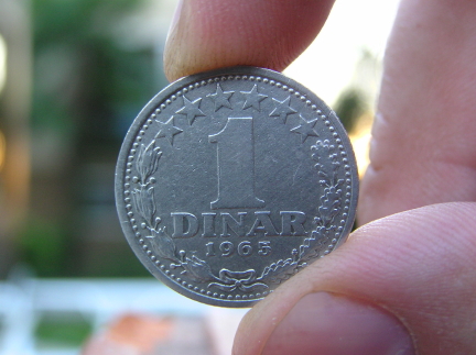

                          • Question for IVCONIC
                            Hi Ivica,
                            Just a little question: is this the kind of coin you use to compare your MD’s performances?
                            Thank you
                            • No,
                              as i stated many times - 1e coin!
