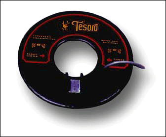

                  • Another detail that is very important - exact dimensions of PCB boards to make sure we print them out correctly and pins fit in holes.

                      Simonbaker , Do you have Sprint Layout 5.0 ??? It would be very helpfull if you did !!! All the demensions you need are posted , either on this thread or from the .LAY file . I will try to find what you need and post what I can tommorrow , I hope ?? I have been "Re-Reading" this whole "Tesoro Golden Sabre" thread again , checking all the coils and coil-specs. that were posted. Yes , so far there are about 3 to 4 coils that were tested and called a "Final-coil-Design" ....But this is a Huge Thread with 98 pages and almost 2,500 posts and 1,200 pictures of Clint Eastwood ..This Golden Sabre thread was a "Work in Progress" for over a year and has a "Goldmine of information" ... I am not done searching yet , for a couple of questions I need to get answered , about Tesoro's 8 inch , concentric coil 'Resonance"...............Eugene

                        Do you mean this picture of above ?
                        With the cigar ???
                        About the coil... it's not 12Khz... but 14.6-14.7Khz. The large coils from tesoro have, actually, lower frequency (more inductance) but this is a sideeffect I think... in 8'' coils you'll get 14.6-14.7Khz from TGS' colpitts with that capacitors.

                        • TESORO GOLDEN SABRE
                          MAX , Thanks again for your fast Response . I think you know what I am trying to say . Tesoro Makes about 5 to 6 different types of search coils search-coil's. And each will fit more than one Metal Detector Model !! The "Standard" 8 inch concentric , and I posted a tiny photo , fits ALL Bandido's , All the Sabre Model's and a few assorted other model's . It has factory set parameters of 1. DC resistance 2. Resonant frequency 3. Inductance in Millihenry's. What I do not understand is this one 8 inch "coil model" works good on the 10 khz Bandido and also works good on a Golden Sabre 12 khz or even a 15 khz Golden Sabre Plus !!! My question is 1. When you inject a vlf signal and it does not match the coils resonance 1. ARE YOU CREATING HARMONICS ???. 2. Are you causing PHASE DISTORTIONS ON THE RX SIDE OF THE COIL which will effect THE ACCURACY of the Discrimination circuit , or even cause more noise Problems. If Tesoro manufactures a special search coil for each of the metal detector model's they manufacture , Then all the above Questions are not important. Maybe when Tesoro uses one coil for "ALL MODELS" it is "TESORO BBS TECHNOLOGY" or "TESORO HARMONIC BBS"...So it seems like Tesoro's resonance on the coils is 14.6 to 14.7 khz and the factory will tell us that a detector model has an operating frequency of 12 khz.....I am still researching this subject...Also , there is a "Mars" , Pennsylvania !!!!............Opininions are welcome again.....Take Care............Eugene

                            well no... the Tesoro's coils have no tuned resonance peak at VLF range, they have self resonance as any coil has but , I mean, uMax coils have no tuning capacitor in a tank... inside housing... like other models have , other brand have (some White's models as example).
                            You actually don't inject the VLF signal in the coil, but the coil is part of the TX oscillator, a Colpitts one in Tesoro's with some variants from e.g. Bandido to TGS but really close in various models of that years.
                            When the coil is connected to the MD it become part of tuned circuit in the oscillator, and different caps in the "tank" make oscillator runs on a particular frequency. In Bandido you have 10Khz cause of that 2 caps , different from TGS, so ... if you replace the 2 caps in bandido you'll get same 14.7Khz of TGS with same coil.
                            The Tesoro's coils are nothing special, no harmonic design: they must suit tx and rx needs on fundamental frequency, that's it. To simplify , they must not follow even strictly a "particular" fundamental frequency, but nulling voltage and a required (no metal) tx/rx phase shift.
                            The results is that the same coil could run a different frequencies on different MDs of their uMax series... but with some combinations better than others: some type of MDs are more stable, though similar about circuits/schematic, also components selection is important in these differences.
                            The fact some coils allow lower frequencies is a sideeffect, happens with some larger ones expecially... that's cause of increased induction due to the larger area coverage and bad calibration of inductance at tuning procedure. That make me think their tuning procedure must be quite simple like using a multimeter or a scope for finding the required null, then check phase but paying less care on inductances and thus resulting in a lowered frequency on detector.
                            As you know, many successful TGS coils were made using out of spec inductance value and paying attention to dc series resistance and frequency...and phase: that means inductance is not primary key factor in successful coil cloning about TGS and other tesoro's if the end frequency is as expected...e.g. for TGS around 14.5Khz.
