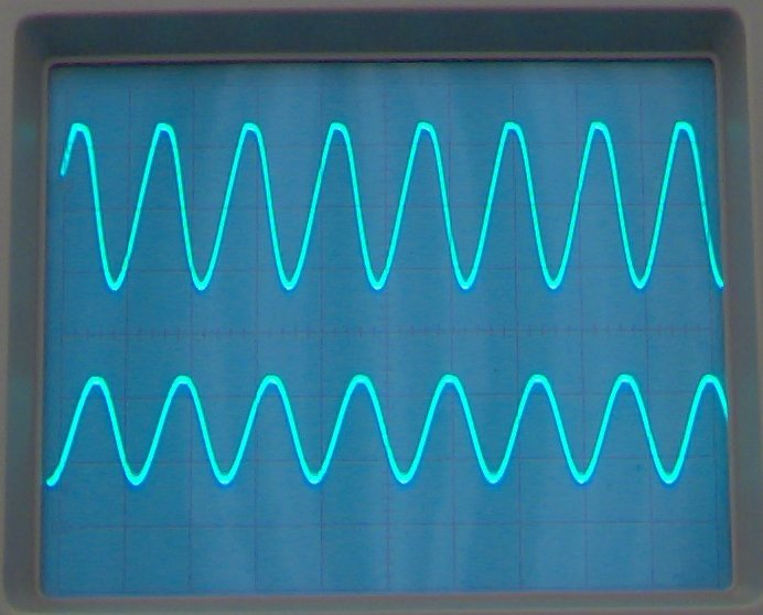

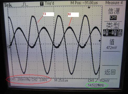

            Hi Hi Qiaozhi and Max,
            I don't have an original Tesoro coil.The first image shows my TX signal compared to the RX signal at the output of the preamp,the second image is Max had post on Page 57,you 'll see the two image are almost same in phase shift.
            mine:
            Max:
            Today i measure my homemade 23.5cm DD coil.
            Wire is 0.25mm
            TX: 5.88mH,23.58ohms,Q=1.57
            With this coil frequency should be 14.5KHz
            RX:6.35mH,24.45ohms,Q=1.64
            ivconic
            TX - 100w = 21.2ohms = 5.61mH, when constrained it should read 5.99mH
            With this coil frequency should be 14.6KHz +/-200Hz
            For RX - 105w = 23.4ohms = 6.18mH, when constrained it should read 6.55mH
            I think both Max and ivconic not got the max deepth,in TGS design,to get good ground balance,it'll lost some sense. At no GBE mode,you'll get more 8-10cm.
            Max,do you test the 20 eur cent deepth in all metal mode?

              your measures are nice and I think is all correct, frequency, resistances are very similar and also phase shift.
              Yes, with GEB untuned I get greater e.g. silver detection, but we know this. The problem is that when you have to use it on real soil you need GEB fully operational... otherwise is wasted time, lot of instability and false signals from untuned geb for that soil.
              I test about always using DISC otherwise it's specified the all-metal mode. I'm interested just in DISC mode detection cause in many places there's too iron stuff to use all-metal and it's just a pain switch on disc at each beep to see if iron or not.
              Do you mean the measures I made in older posts maybe ? I don't remmeber now ...too many posts here to remember everything.
              Let me know what/where I wrote and I'll explain that...(hopefully).
