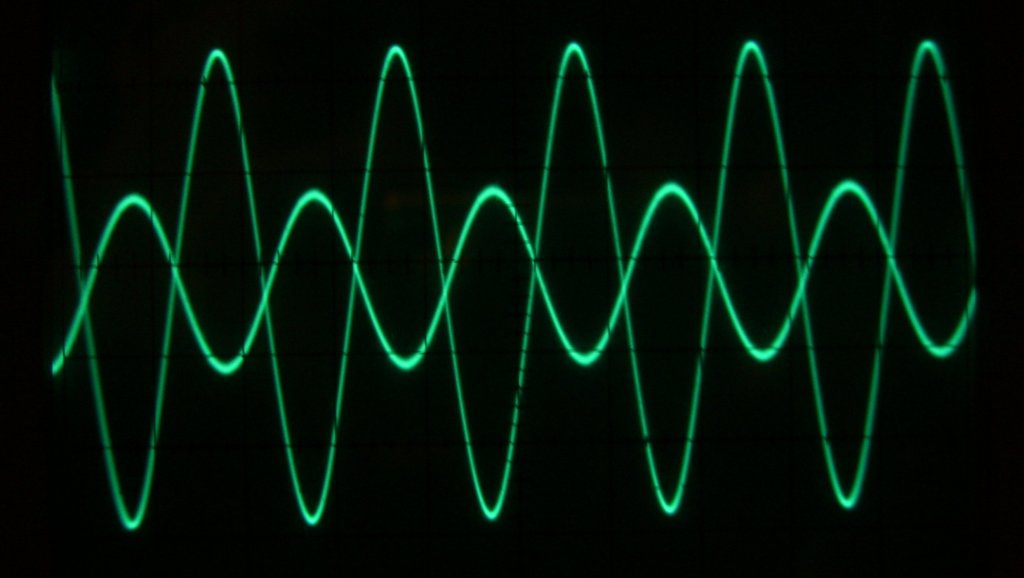

    Hi Max
    You must not at zero crossing,because in that the GBE can't work,
    just as you had post at page 57,the photo "F7,F8,F9,F10" show that you sample at the wave crest.so you can't get the max deepth.
    Today i made some test,i found that in theory we can't get both max deepth and good ground balance.Good ground balance will lost some deepth.
    an get more deepth will lost more ground balance.
    one signal is sampled at zero crossing, the other at peak (maximum of wave).
    This was explained by Qiaozhi some (many) posts ago... but you can find similar procedures in Gifford's patents too... is the usual way to use syncronous quadrature demodulator... samples are phased out by 90°.
    One used for geb/ferromagnetic, other is the main channel... once tuned GEB (rotating the axis of coordinate system) you'll get minimum reading on main channel for ground realted signals. This way you will ignore ground influence.

      This is correct.
      The GEB channel is sampled at the zero-crossing point, because metal targets exhibit a phase-shift, but the ground signal does not. In this case, the ground signal gets ignored.

        Hi Qiaozhi and Max,
        Your explain is very good, but in my test it's very strange.Today i test the TGS,I find that just like Max had post in page 57,The GEB channel is sampled at the peak point,the GBE is good.
        乔治,I find that i set the GEB channel sampled at the zero-crossing point,the GEB can't work at all.I test in the loess soil.
        Max i also use a ferrite pole to test,i find it can also makes phase shift in the Rx coil.I set the GEB channel sampled at the peak point,another channel sampled at the zero-crossing,the sense and the GBE were work good. but the is not at the max,loss about 8cm in deepth.

          I don't know... maybe you have swapped rx coil leads ? This will create 180° phase reversal on your RX signal... and can create confusion here.
          What I have is that with settings I showed here... (changed a bit but are about the same now) I got really good results both with ferrite and on soil.
          With ferrite I can disc almost totally apart small cracks at few mms really short distance and still detect silver from very far, even if not so far as when geb is tuned out... sure.
          Same happens but with less signal reduction (so really far detection) with e.g. an half-crown that's composite copper-nickel coin 3.2cm diameter.
          I found so many items on soil with TGS that I'm sure this is the right setting !
