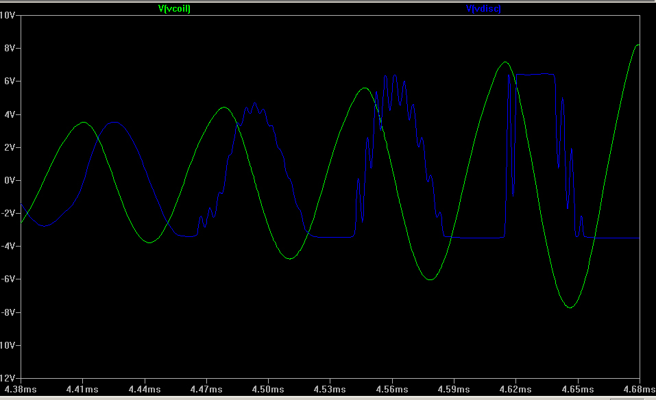

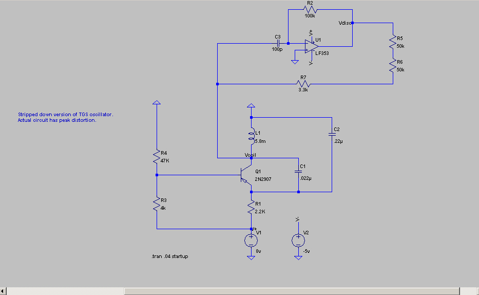

                        • LF353 Disc problems
                          I am making Ivconic's TGSL Final PCB, but hand-wiring.
                          I have a problem at output of U101b (LF353 disc signal).
                          The output has jagged spikes on top of sine wave.
                          I tried reducing amplitude of TX oscillator (by putting 7k resistor in place of R6 24k resistor). That made the "jaggies" go away - smooth sine output.
                          So I simulated the circuit and adjusted the TX oscillator amplitude to grow slowly, and at a certain value I see the "jaggies" appear just before the LF353 inputs become saturated.
                          Conclusion: the disc signal from LF353 can be distorted by large TX oscillator signal. That may be one reason for the JFet feedback in oscillator, to keep it from saturating the LF353 inputs.
                          Do other people see this problem?
                          I attached LTSpice images and circuit.
                          -SB
                          • Never had any simillar experience!?
                            Must be something wrong with your coil or something else.
                            You keep pushing jfet thing here again and again. So persistent!?
                            No problems at all if fet part omited, for the last time!

                              • I reread my post with waveforms and can see it might seem critical. Really, I'm just trying to understand puzzle, not criticize.
                                Anyway, sorry, TGSL obviously excellent machine, I am trying to make one too.
