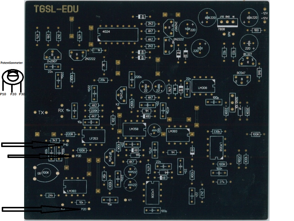

        VDI GEOTCH
          i need help how to wire this potentionmeter on this P10 P20 P30 is that right or not on my picture
          • That is correct. This is the discrimination potentiometer.
            • Ok thanks and what is K1 K2 K3
              • K1, K2, K3, is the switch to the Disc and All Metal modes. K1 and K3 are connected to pins on the switch side, and K2 is connected to the central pin of the switch.
                • Ok thanks master
                  • Originally posted by paku View Post
                    Discrimination switch connection point

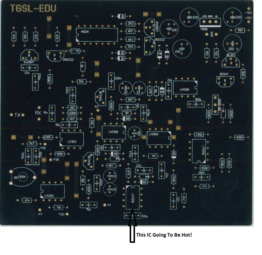

Name:	newpcbf-1024x768 - Copy - Copy.jpg
                              Why This IC is Hot And I Get Only Sound Very Speed Beep
                              or i get rong on my coil conection
                              • The LM308 can be damaged, or placed upside down. Try a new IC. Before turning on the detector, the coils must be connected. You have to measure the voltage 8V and 6.2 V. Greetings.
