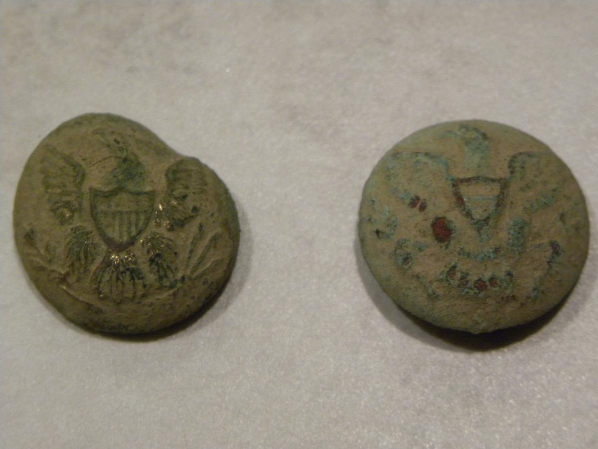

              • A Couple of good finds today from my favorite Spanish-American war campsite .. This time with the TGSL - Eduardo's version (Silverdog kit) using a home built 9" DD coil. I found these at somewhat less than 6" and came through with a very strong signal. I dug these with a dozen or so other relics. I have to go back tomorrow and find the rest of the jacket!
                  Nice -- is it possible to identify them? What kind of metal?
                  -SB
                    -SB
                    Hey Simon!
                    Yes, the one on the left is civil war pattern. I have several that I dug in Maryland that look the same. Since the Spanish -American war was only 30 some years after the civil war, I'm wondering if they just used surplus items in some cases. I've found 12 buttons in the campsite so far. They are gold plated, thin brass.
                    Finding them with the TGSL requires a very low level of disc., almost as low as foil. I have to adjust mine to just eliminate hot rocks and still accept the buttons.
                    • Thank you Jonh Smith 77.
                        Hey Simon!
                        Very interesting -- exciting to see history come out of the ground thanks to TGSL.
                        -SB
