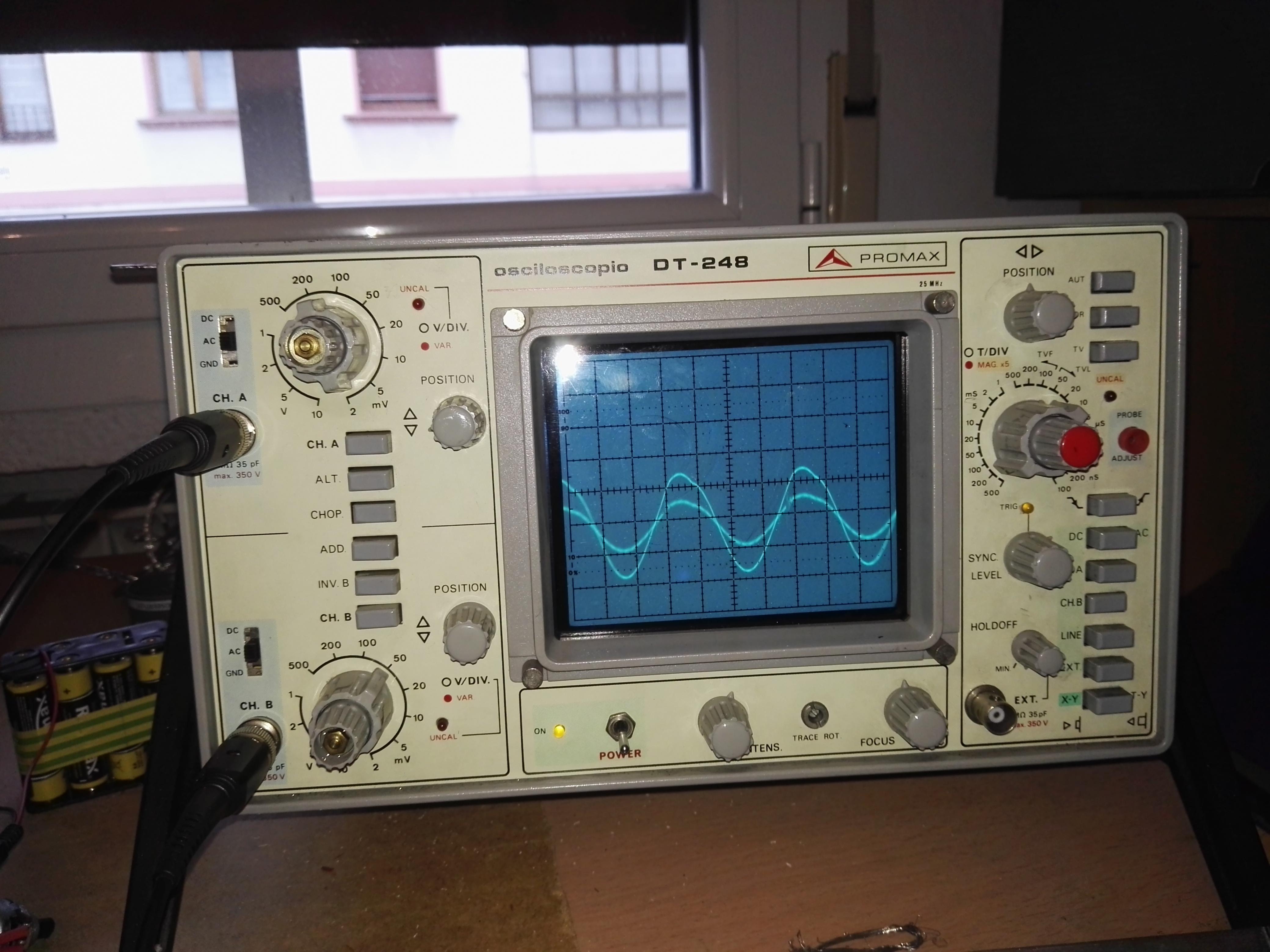

  • Rx coil connections, this is the best. I cant get it closer to 0.04 volts.
    • hello is how good the null of the coils as well? thanksClick image for larger version
