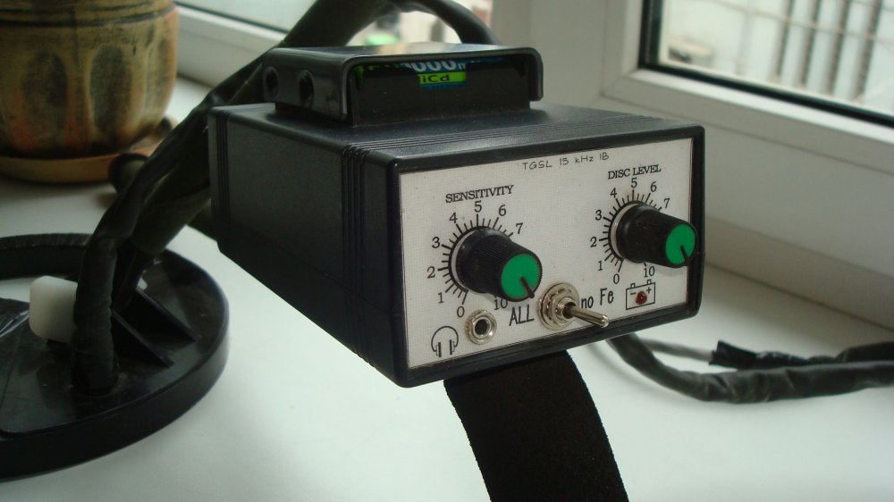

    • one ukrainian asked me to give him a front panel pic that I have not. his shield has waded off in time of long
      hunting. can anyone share it? in format Front Designer 3.0, jpeg or gif no difference all will be appreciated.
      TIA
