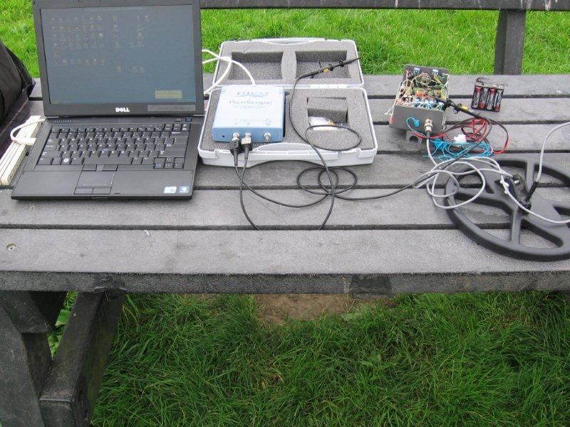

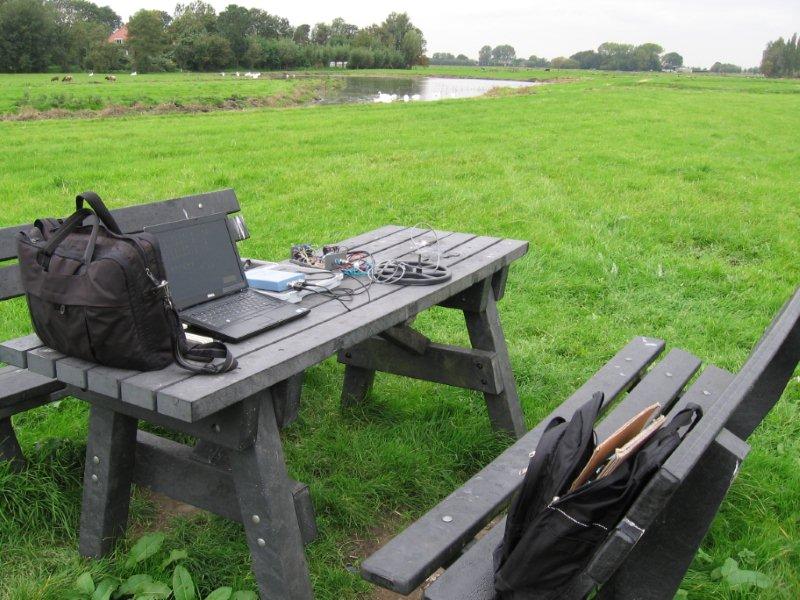

    • Another noise field test attempt
      Still curious about the noise outside the 'workshop' I packed my things and went with my mobile workshop into the field.
      Packed my steel steed, laptop on my neck, backpack on my back , scope on the luggage carrier.

      The last time it went not quite right with the measurements , the coils were not potted at that time..
      With the now encapsulated coils had to go well.
      Took my list of "reminders and not to forget " and checked everything.

      But as always destiny struck again:
      The USB Scope runs on a virtual machine on my laptop and the USB scope did not want to be recognized
      I have installed the scope software to a free partition now , this will not happen again.
      When the scope was finally recognized and booted, I had time for a sample before the laptop battery was empty ...

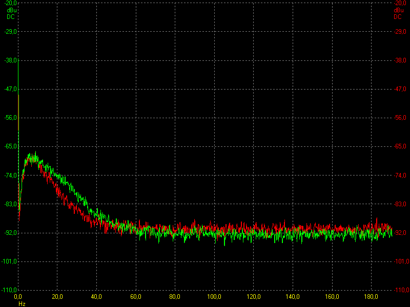

      In this example spectrum analyzer view at the outputs of the LM308 ( in this case TL081 )
      Steep filter 0 - 50 Hz

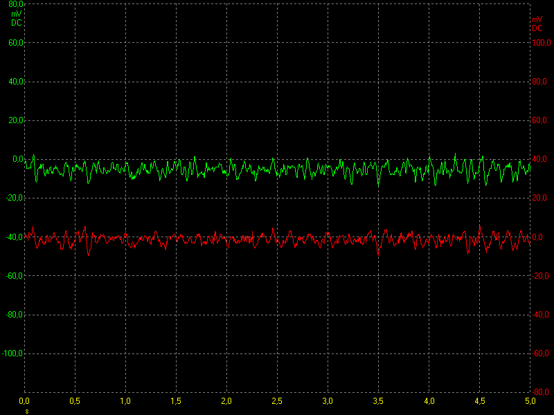

      View at same test points , still suspicious about the wind effecting the leads in the pcb housing causing a little more noise (?) ....

        That is a hoot! It just kept getting funnier! Made my day...
        And a good idea too, I hope you try again -- and watch out for those metal bolts in the table.
        You did get some data -- how does the noise compare to in your workshop?
        Keep up the good work.
        -SB
        • Thats what you call field testing at its best, let us know results
          Many thanks

            • Hi , please be aware that Pc's laptops , Tvs , LCD tvs, all boom out electrical noise.
              You could be measuring the noise your test kit is producing..
              I work on stuff like this and its difficult to eradicate.. not impossible. !
              S

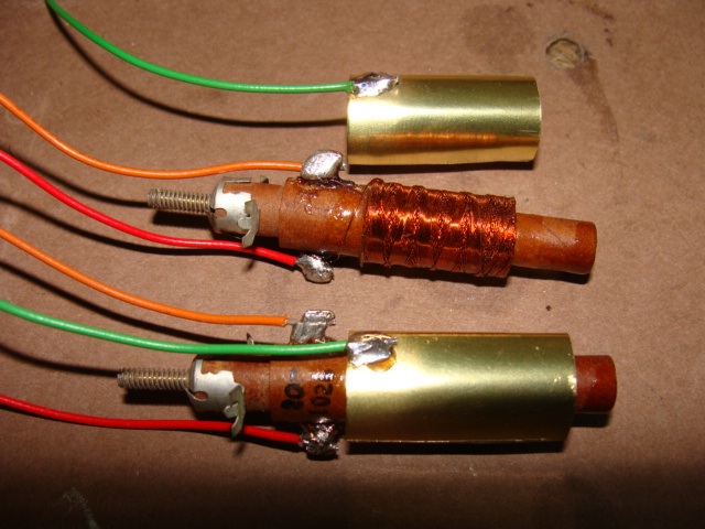

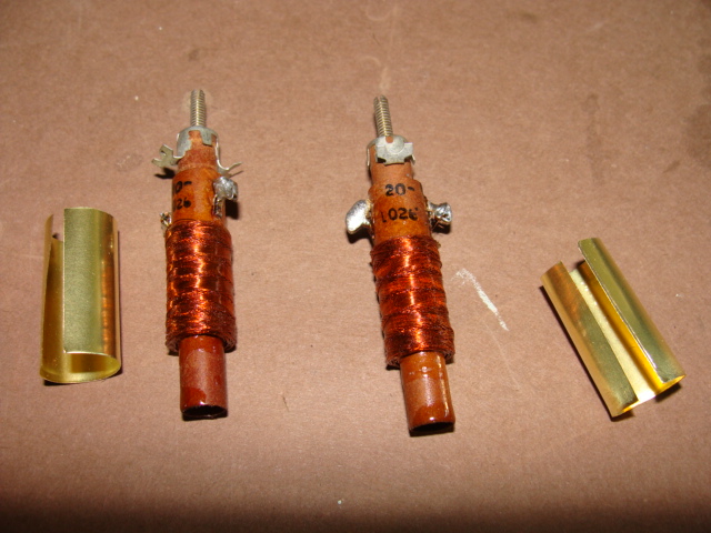

                        Hi Simon:
                        Last year I made up a couple variable loopstick coils and even made little brass shields for them but then something else intervened and I got away from the project and have not picked it up again.
                        Here are the two coils I made. As you can see they are tunable. I was sort of making it up as I went on this so any suggestions would be helpful. I was trying for something similar to hooking up a dummy load or signal generator for a two way radio.
                        Jerry

                          Those look great. Basically they can be very helpful when trying to understand where noise comes from, whether it is oscillator jitter, RX pickup, etc. The problem may be getting the resistance realistic, ideally around 20 to 25 ohms would be good for comparing to real coils.
                          I am thinking also of making tiny circular coils that you can null in the normal way for ease of use and comparison to full size coils.
                          -SB
